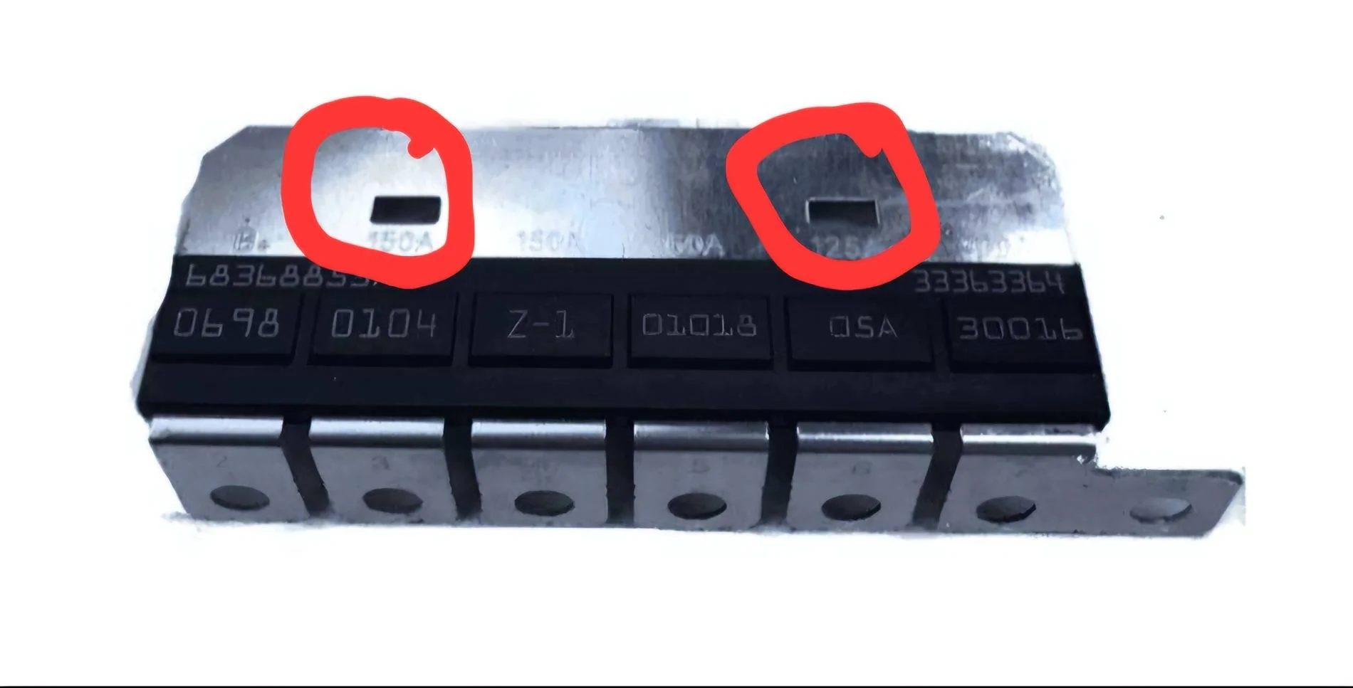

In all the videos and pictures I've seen of the N-fuse rail, it shows a couple of slots for tabs in the back of it, has anyone taken this thing off and can give me some pointers because I'm not trying to pry mine off, but I can't seem to get it off to replace it.

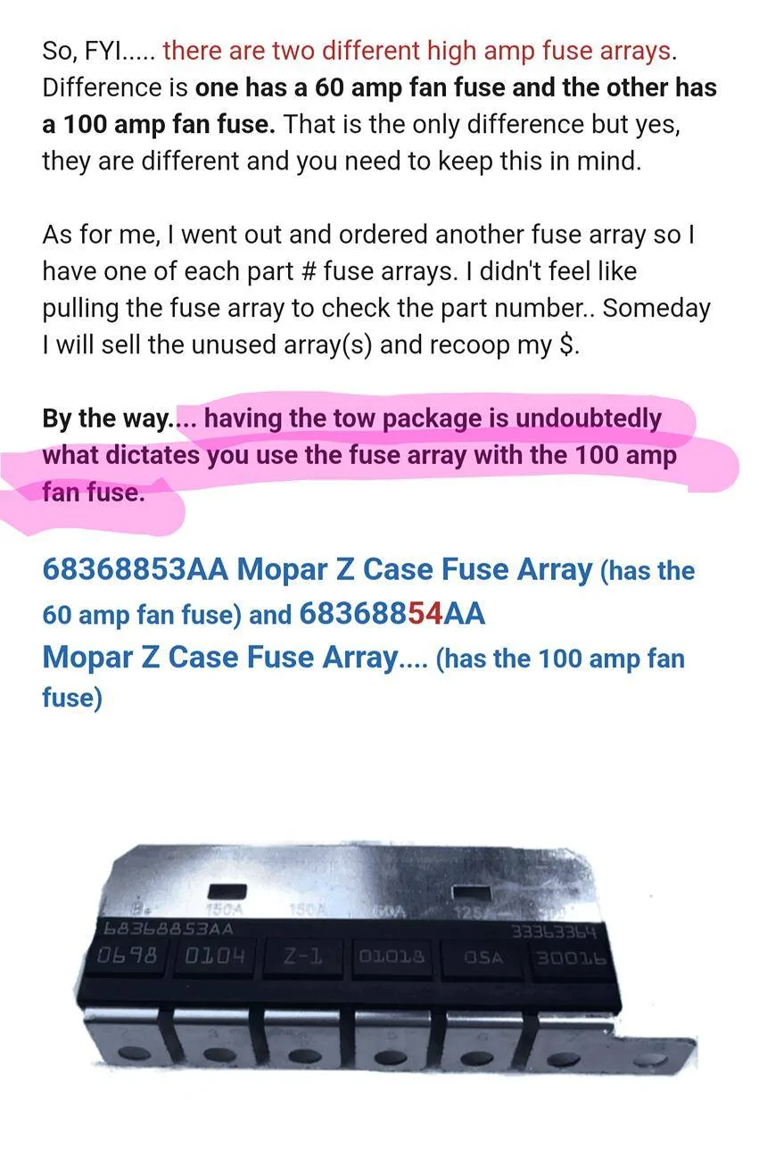

I found a thread on here that tells me which part number is for the hundred and fuse and why, so at least I can order it but I'm still going to need to know how to take this thing off at some point in the future, preferably before Friday when I get the part and have to replace it.

Spitballing, but by the looks of the part, there must be some plastic that catches in these spots, allowing it to slide up and out...eh?

There are no plastic tabs and yes, it lifts right out after removing the nuts and moving the wires out of the way.
It requires no pressure or force to remove it.

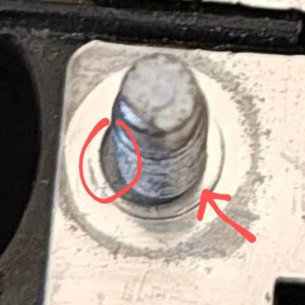

Total guess: maybe it's caught on the studs' threads? Try wiggling them individually to loosen everything up a bit.
That's what I was doing for the better part of an hour last night. I was even leveraging it with a screwdriver on the back of it, trying to keep those holes in the center. I could get them up a little bit, but only each individual tab at an angle, and in my case there's definitely something holding the back end, the end that goes in between the plastic of the fuse box and the plastic where it sits that is hanging up. 🤷‍♂️ :whew:
I'm almost kind of wondering if that n3 fuse didn't short and melt to the plastic? 😭
