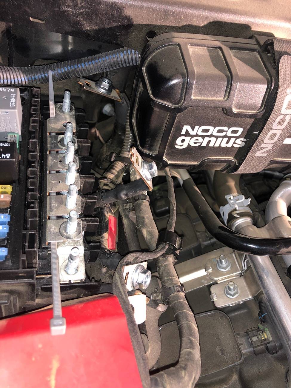

All the YouTube videos I see, these dudes just pick it up effortlessly with their fingernails, I'm sure before they took that cut they sat there and pried away at it for freaking 2 hours.

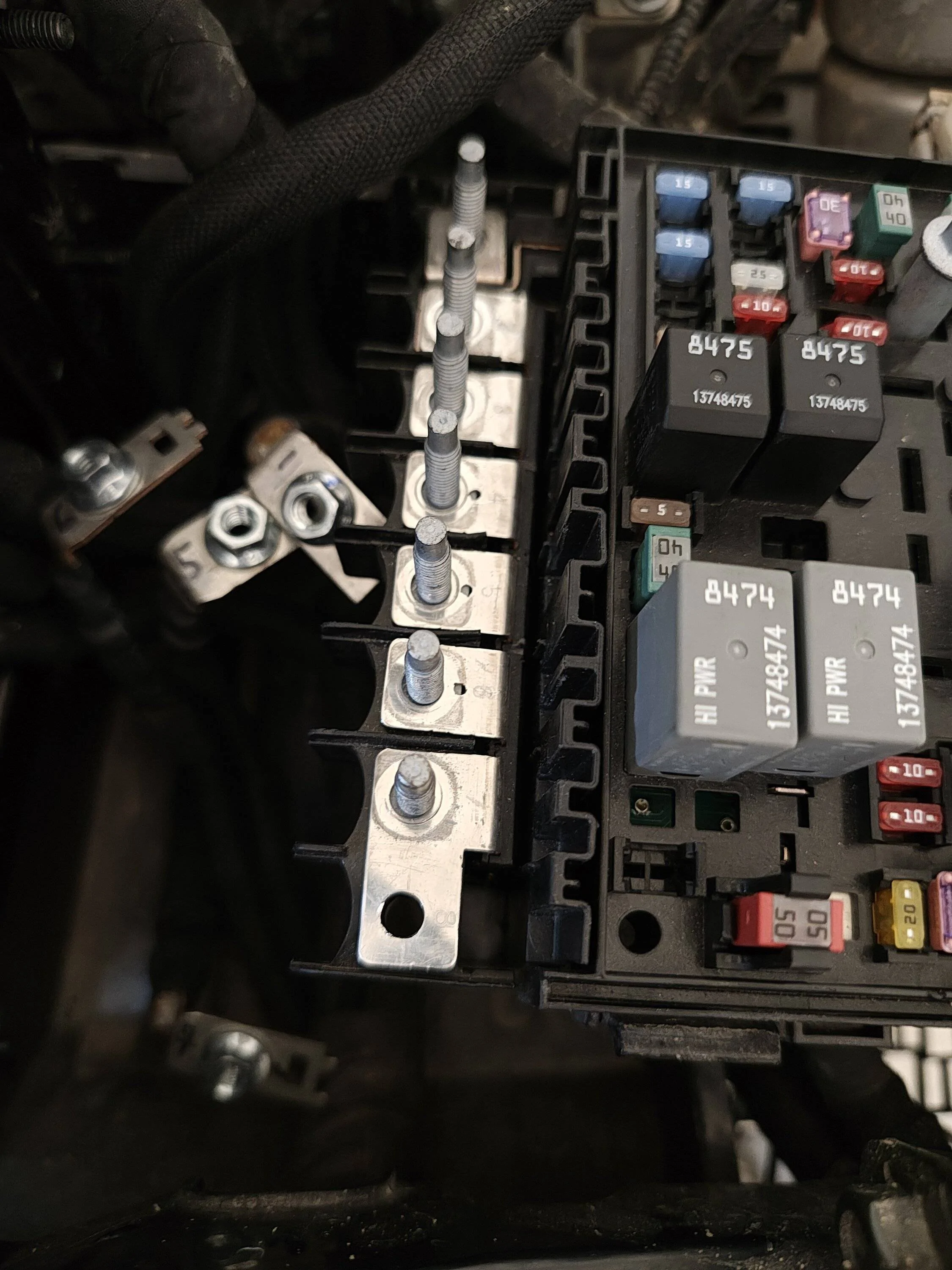

In all the videos and pictures I've seen of the N-fuse rail, it shows a couple of slots for tabs in the back of it, has anyone taken this thing off and can give me some pointers because I'm not trying to pry mine off, but I can't seem to get it off to replace it.
Is there a secret code for taking this thing off?
I was baffled at first too thinking it was bolted to the PDC. I looked at the video and saw that it’s just the metal piece that comes out. Slips up easily.
Sadly mine did not come up so easily!

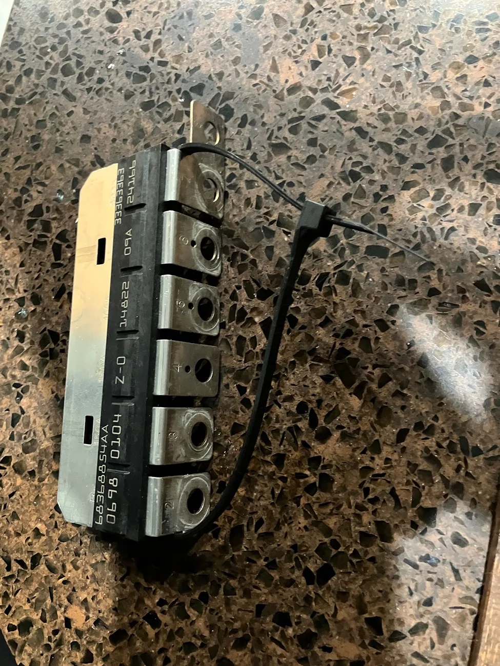

I just put a zip tie under it and lifted it up
Yeah, someone recommended the zip tie trick, and that ended up working best for me. On the EcoDiesels it's right up against the battery, so it's hard to get leverage on both sides at the same time. But the zip tie trick worked well for me!
