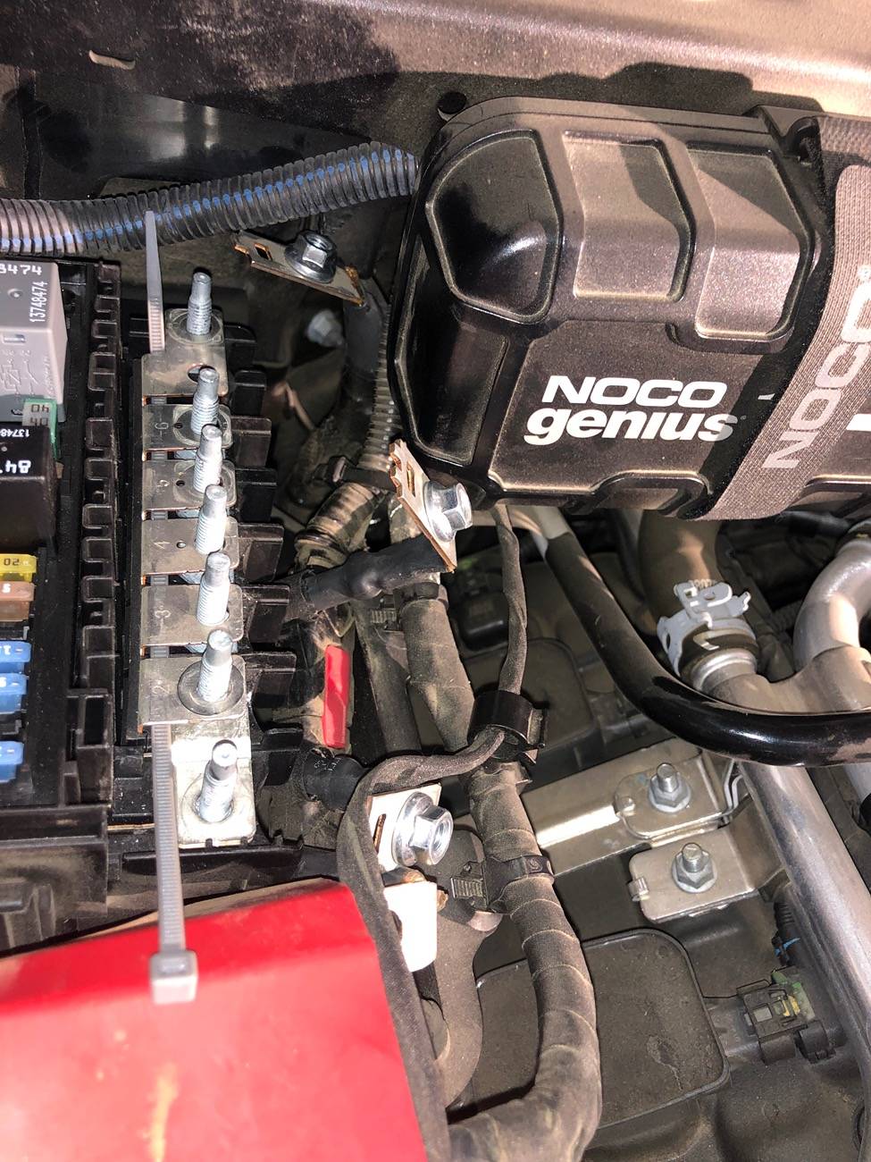

@Tredsdert, before you start tearing stuff apart and throwing it across the garage read this.
Ok I just removed and replaced mine. I used a plastic trim tool to lift the front edges up one at a time and then slid a cheap thin cable tie under the back where it makes a 90 and pulled up. It worked easily. However until i used the zip tie mine felt like the threads on the studs were keeping the fuse array from lifting
Jeep Wrangler JL HELP - Removing main fuse????? IMG_2189
