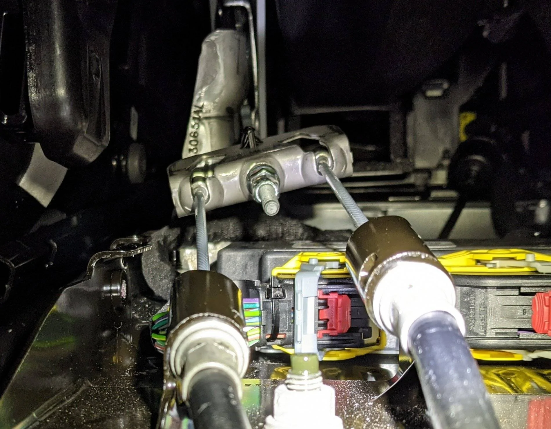

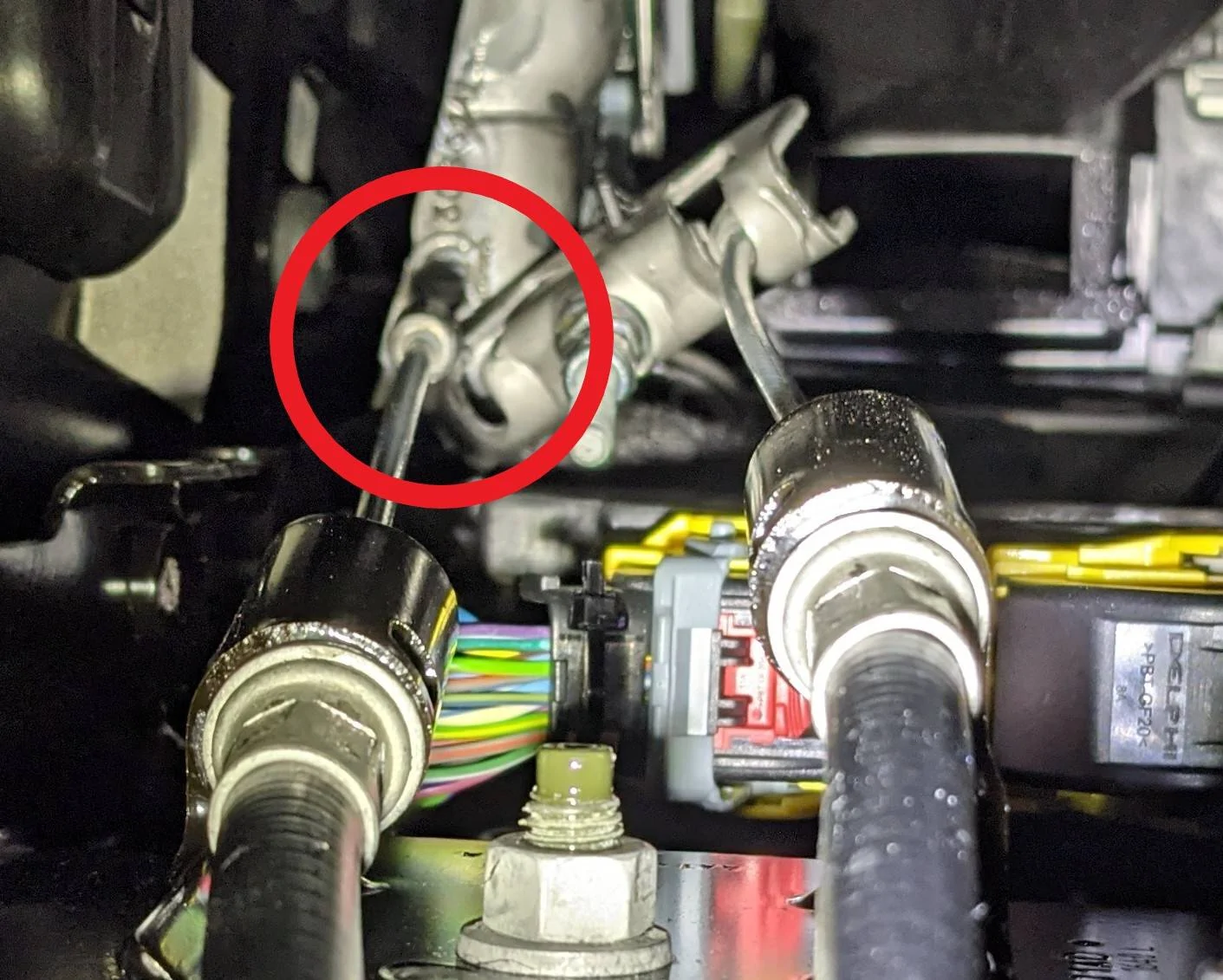

The video Hound Dog linked above was very helpful. My ebrake lever felt very loose after I installed my lift kit. I know that I disconnected the ebrake lines before drooping the axle, so excessive pull wasn't a factor. When I opened up that part of the center console I noticed the opposite; disconnecting the ebrake cable left too much slack, allowing the cable to pop out from the part that connects them to the handle:
Jeep Wrangler JL Need help, E-Brake loose ebrake0
Loosen that center nut with a 10mm deep socket, push back it, re-tighten that nut, done.
