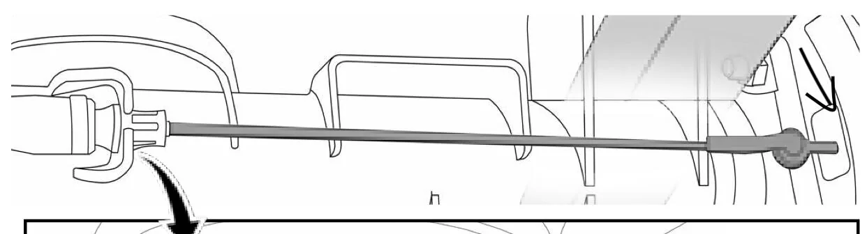

To me it sounds like it might be binding where the pins come out of the wheels, or inside the brake drum. Set, then release the brake and look under the rear to see if one or both of the cables is very loose - with the pin/tab where the cable hooks pulled out and stuck (just happen to have this picture from yesterday)
Jeep Wrangler JL E-brake release Screen Shot 2025-07-01 at 2.57.56 PM
The cable here should be loose when the brakes are released but not overly loose.
