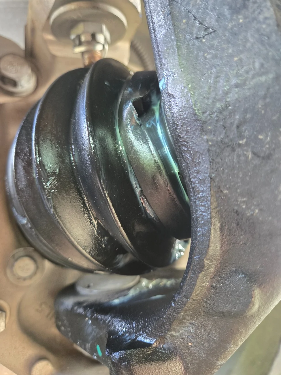

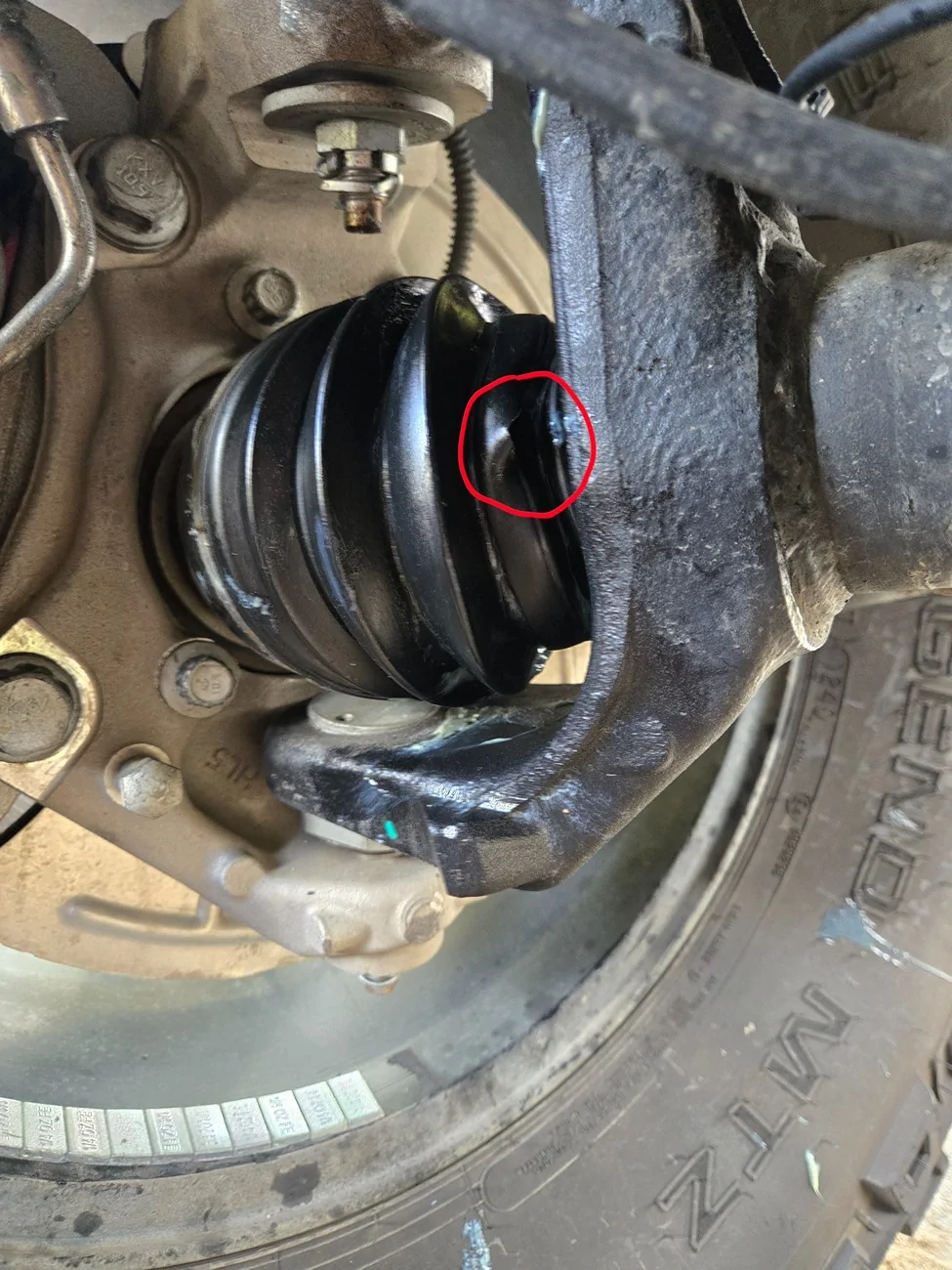

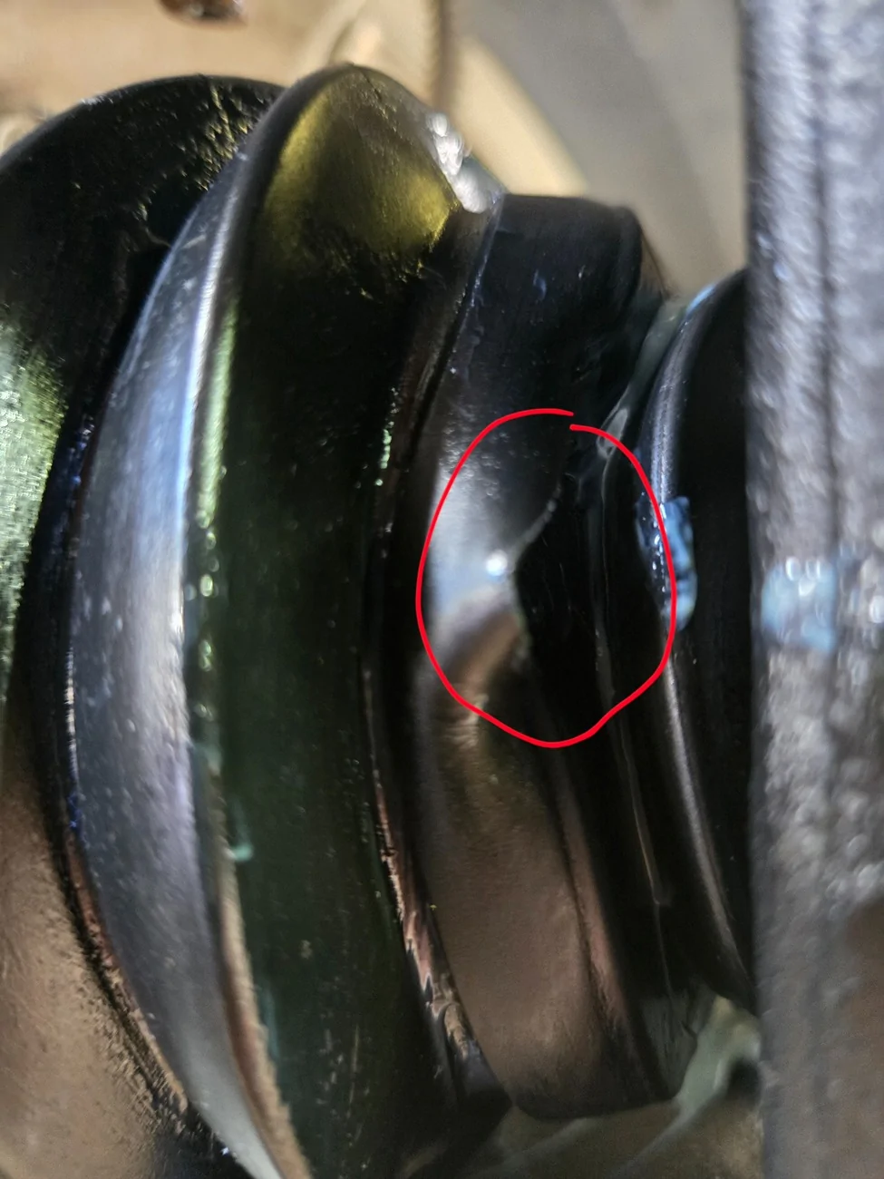

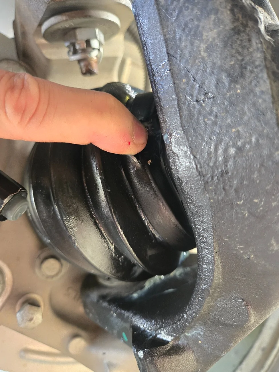

Is this seam thingy or the location that warranty doesn't cover?

Yeah, that's from something external, not a part defect. Does suck, but don't put it off long. Once all the grease has been slung out, and water can get in, it will damage things. How quickly that happens is up for anyone to guess. But consider that this joint spins with every rotation of the tire.

Roger, will fix it ASAP. But even a 1000 miles is enough to damage things? I need to drive, its my only vehicle ☹

The grease lubricates the bearings, it doesn't take too long with no grease for metal on metal wear and spalling to begin. You can try to put fresh clean grease back in the hole, and seal it up. But results may vary. Usually just end up a mess.

Just remember that it's going to keep flinging it out until the hole is sealed, or the boot is replaced. Centrifugal force and all that jazz.

To me, that looks more like something stabbed it, like a branch or something. Others can chime in here though.
Ditto.
