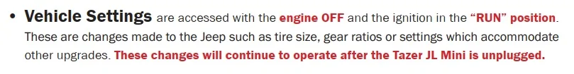

According to the Tazer Mini User Guide on the web site, enabling the Proximity Locks is a "vehicle setting", and as such "These changes (vehicle settings) will continue to operate after the Tazer Mini is unplugged".

So you're saying the instructions from the manufacturer are wrong?
I'll be sure to post back here once I turn on the Proximity Locks on the '19 and unplug/unmarry the unit.
Proximity Locks is in Vehicle Settings, Sub-menu "Other".

NO, the ZAutomotive Tazer JL instructions are not wrong... Yes, if you just unplug the Tazer JL the setting(s) you made/changed with it stay in place..... but when you unmarry the Tazer JL to use in another JL, all goes back to virgin setting wise.
You just need to get it clear in your head, that all you do to your JL setting wise with the Tazer JL Mini, is lets say undone when you unmarry the Tazer JL Mini.
Thus... you cannot do the proximity enable and then unmarry because when you unmarry all goes back to virgin setting wise lets say.

The key is the difference between "unplug" and "unmarry". If you don't unmarry from your wife's Jeep, it won't work on yours. And if you do unmarry, the changed settings are gone.
