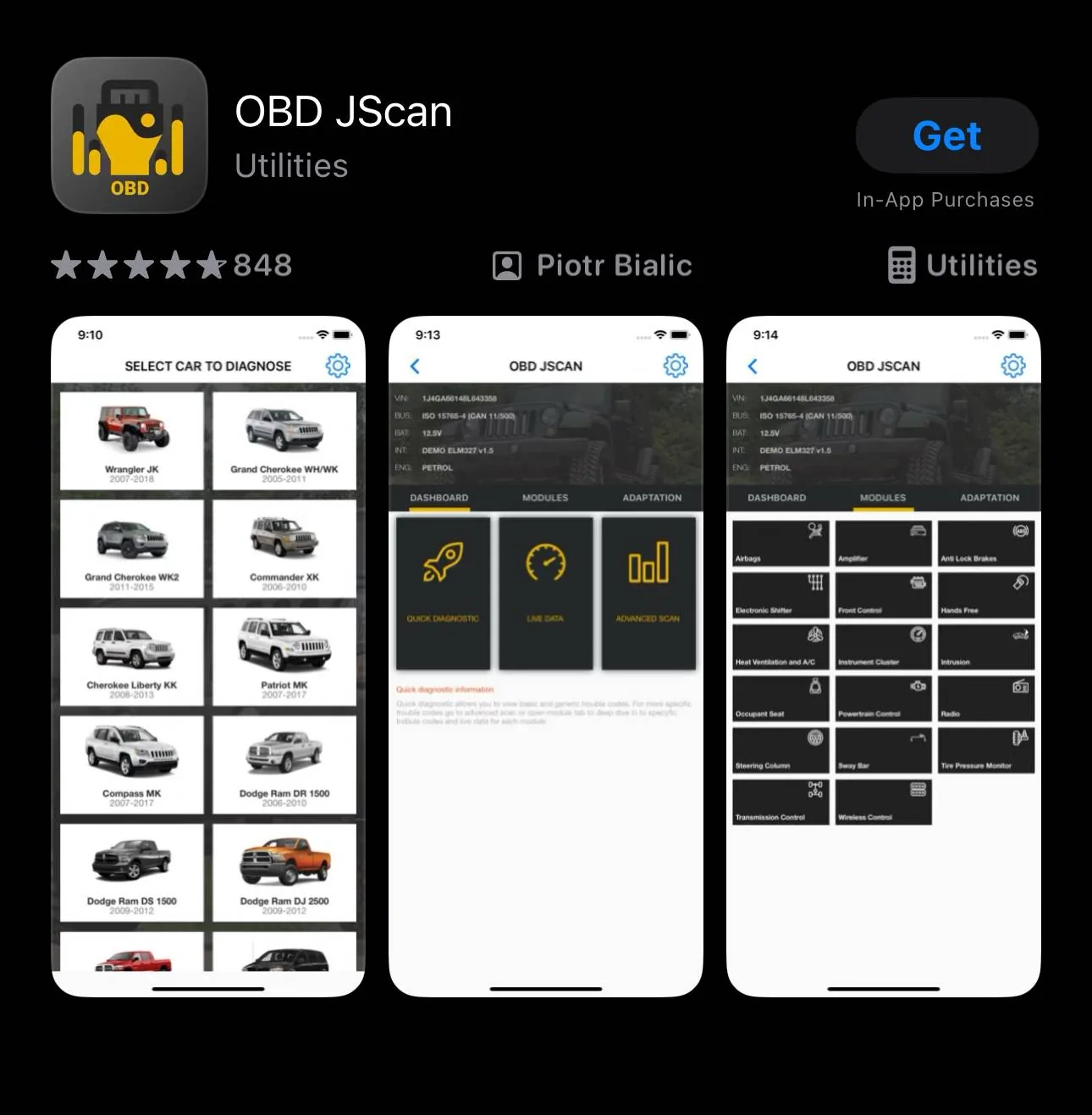

I suggest you get a jscan for your application. Its much cheaper (mine total cast was like $70) and it come with more permanent settings, better data and diagnostic tools.
Tazer is good for the live functions when its plugged in.
I second this. I have both Tazer and JSCAN and a solid case can be made for just JSCAN. Tazer is great for disabling ESS though. But for just tire size JSCAN will save you headaches (not worrying about unmarrying to visit dealer) and money.

Is it the OBD JScan? Can I also unplug it after calibrating the tire size and retained the adjusted setting permanently or does it have to be plugged in indefinitely?

Correct, you can make your changes and unplug. I just leave mine in my glovebox. I have both and I use j scan for permanent
Changes and tazer for live features.
I agree 100% with the JScan. Make a change, unhook it, settings still there. Easy!
