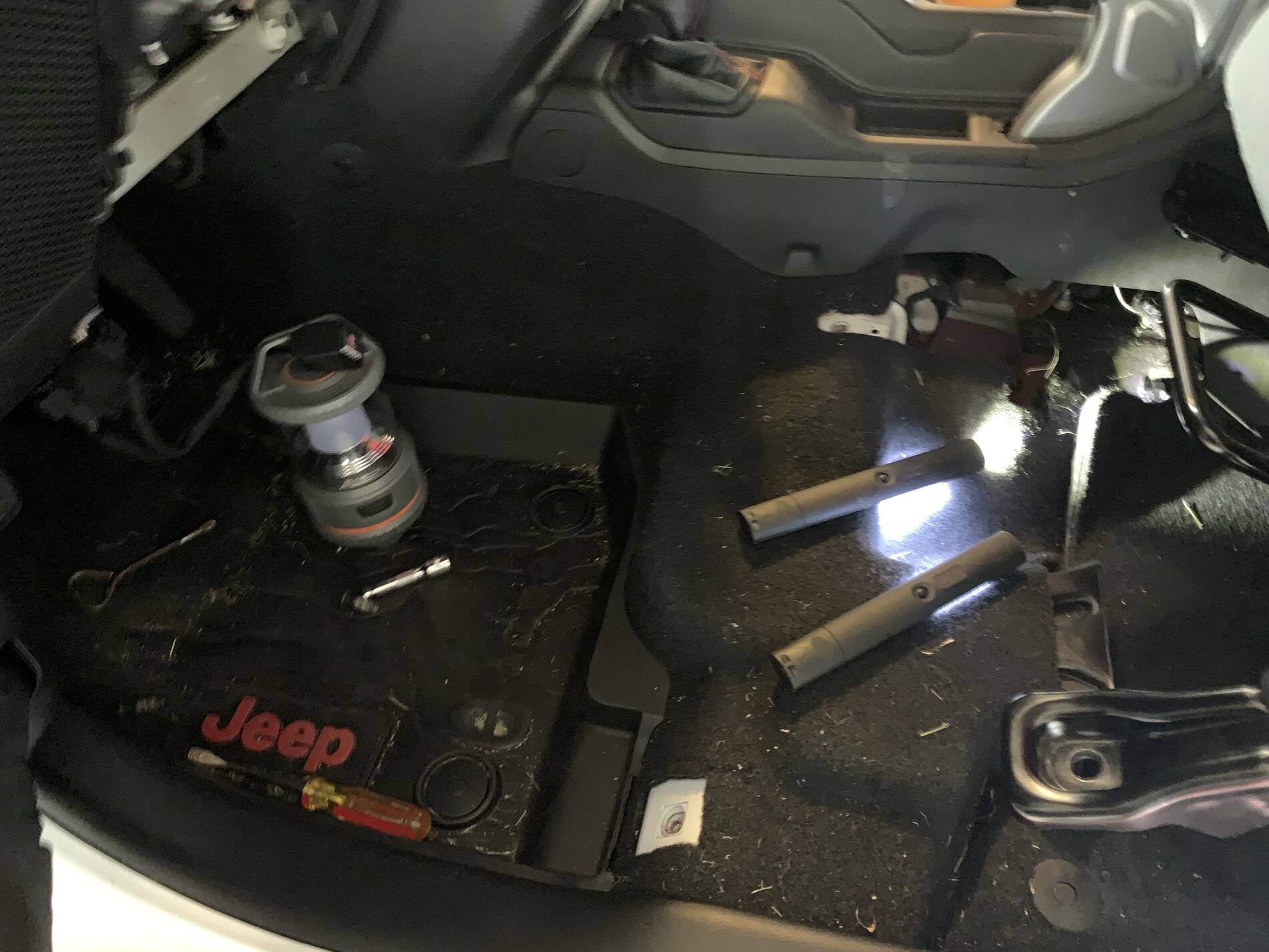

Finally got the f’ing SGW cables plugged and this is how I did it… i had to remove the driver's seat which gave me the much needed room to work with..
With the seat off you can now install a side mounted dead pedal. That was a hundred fold more difficult to install than the SGW. I am still twisted over from installing that thing.
