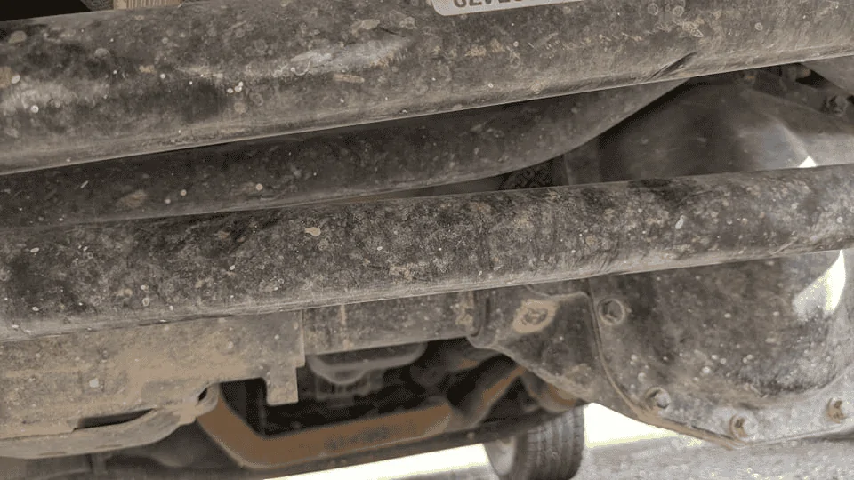

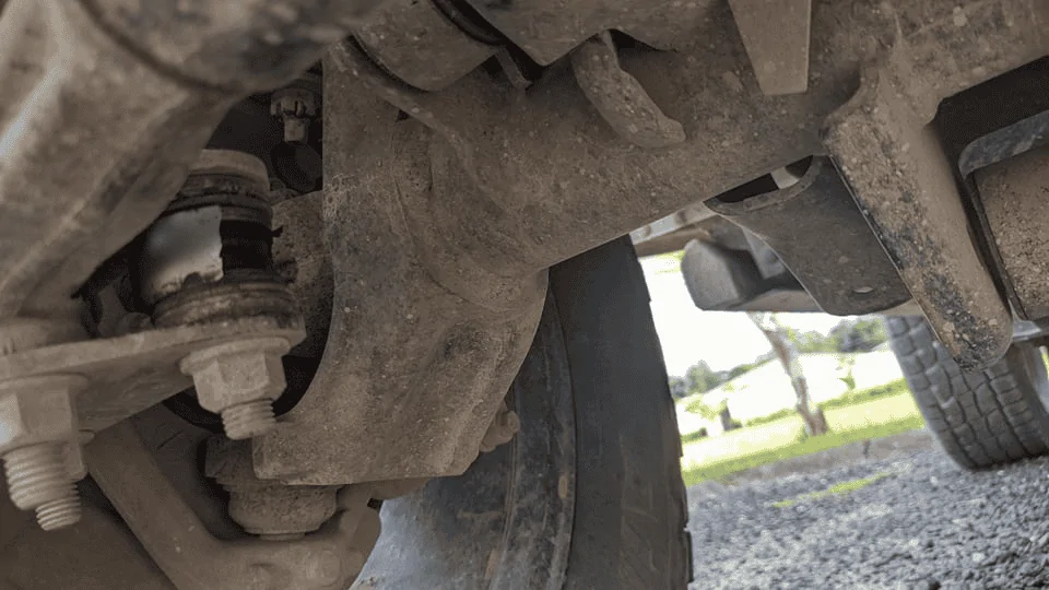

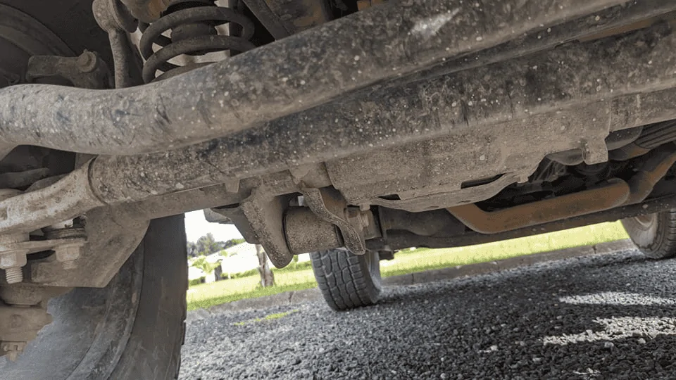

Hi Guys,
The strangest thing happened and I need your experienced opinion to understand what went wrong with the damper?
I live in Port Vila (Vanuatu), small Island in the south pacific, I've imported my 2018 JL 2-Door Rubicon here couple of years ago and I absolutely love it.
Back in April last year I went heavy off-roading and damaged my damper and so I've replaced it with Teraflex Falcon Nexus EF 2.2 Fast Adjust Steering.
200 miles of normal drive after the installation of the new damper, it is broken and gone, is there a common mistake with installing these that could have caused it or could you have any other educated guess for how did this happen?
Note how the damper broke off there is a piece with a different silvery color.
Jeep Wrangler JL My Damper/Stabilizer is gone 1643002720820
Jeep Wrangler JL My Damper/Stabilizer is gone 1643002689864
Jeep Wrangler JL My Damper/Stabilizer is gone 1643002648081
Even the bracket is gone, see this post for the full parts my mechanic asked me for for the fix:
https://www.jlwranglerforums.com/fo...-getting-the-right-part-djd-dje-vs-djf.86709/
Thanks guys,

Dumping the theft accusation, are you aware of a common mistake with damper installing that could of caused this?
I have modified my post, I am positive no one went off-roading and the stabilizer is gone within few hundred miles of driving.
I found this; would this wrong installation could cause how my stabilizer is broken off?

Yeah I also matched the eye to another Teraflex shock I have and its the same material, same color so its defiantly it.
So now i'm left wondering how did it break within 200 miles of city use.

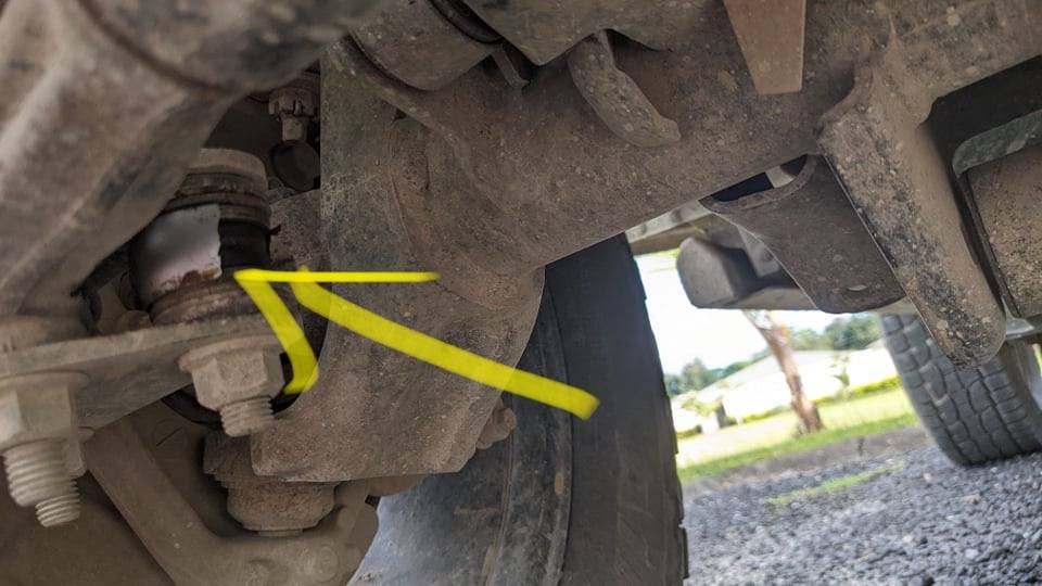

hmm you are right! which part is the axle bracket
It’s not even in his drawings, there should be a picture of the axle, and the bracket….?.
He’s becoming lower on the list of suspects though……. It looks like whoever took it, broke it, there’s part of it still in the tie rod bracket..
A mechanic would have just unbolted it….?‍?

looks like the axle side mount looks to have fallen off either the bolts came loose (more likely) or it was broken off, then the damper was just drooping from the knuckle side and was ripped off while driving down the road
