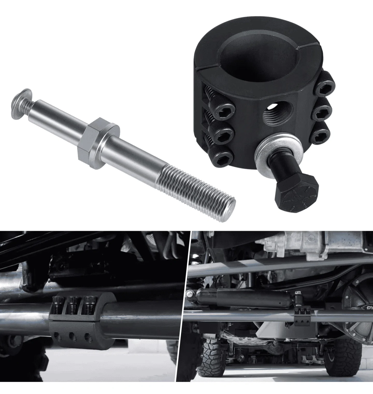

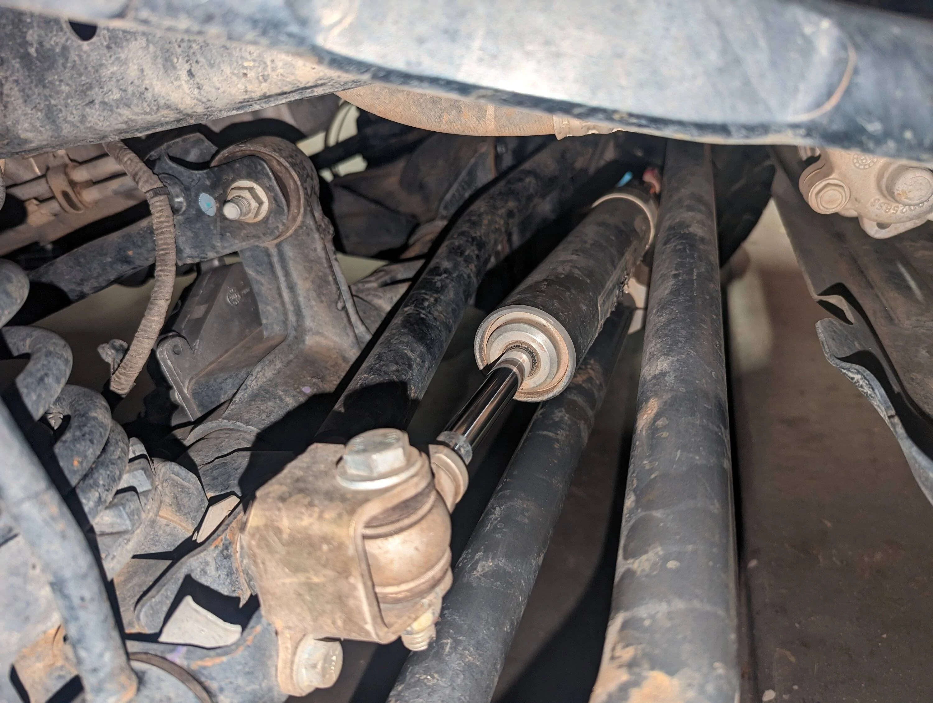

So currently I have a Falcon steering stabilizer attached to my Synergy tie rod with a MetalCloak axle side mount.
Long story short but it seems my Falcon stabilizer is on its last leg. The shaft that bolts into the clamp on the tie rod is loose and there is play.
I still have the factory steering stabilizer so I bought a 1.5" clamp thinking I could just bolt on the factory steering stabilizer to the Synergy tie rod. Wrong. The bolt does not go through the stabilizer. So I am thinking I might just need a JK stabilizer? I am not sure. Any ideas?
Pics of current setup and the adapter I just received.

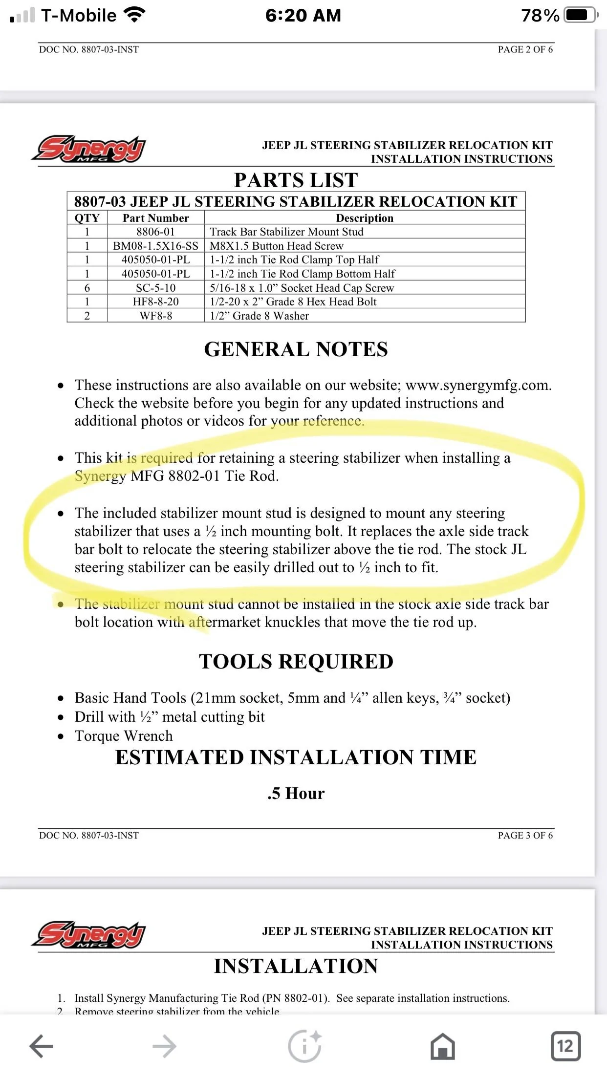

Thanks. The clamp I purchased isn't Synergy so I didn't get those instructions. I'll give drilling it a shot but I'm not sure I have drill bit that size nor a vice to hold it. Might be able to fashion something up.
Yeah, it’s not much, the bit almost goes through without even pushing it…. If you can find a bit, you can hold the shock in your hand to clearance it…..
