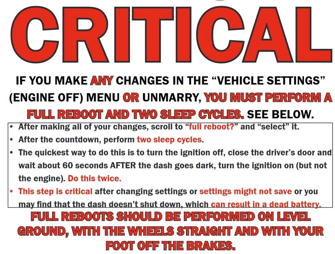

@Ratbert
More often then not, (most always) such Tazer JL hiccups are related to user error and not the Tazer JL. Doing full reboot and the required, 2 Sleep Cycles properly is a must..
Carefully re-read the Tazer JL instructions and play close attention to the part about
"YOU MUST PERFORM A FULL REBOOT AND TWO SLEEP CYCLES. FULL REBOOT AND TWO SLEEP CYCLES."
Read this carefully...

Yes, I followed those instructions to the letter.
I removed it and now have a stereo, backup camera, and trail cam again (discovered that the trail cam was no longer usable).

@Ratbert
Do umarry and then remarry the Tazer JL ....and then do one setting at a time and be sure to follow the WARNING(s) to the letter.
Again do one setting and then when you know you have that working then do your next setting.
I'm thinking you may be dropping the ball on the proper sleep cycles / properly done sleep cycles.

I spent a couple hours tonight trying to get it to not bug out, but failed.
Steps
  1. Marry
  2. Stereo is screwed up
  3. Reset
  4. Wait for both countdowns
  5. Turn ignition off
  6. Exit vehicle
  7. Close door
  8. Wait for dash to go out
  9. Start a one minute timer
  10. Enter vehicle
  11. Turn ignition to run
  12. Stereo is screwed up
  13. Repeat 5 through 12 a few times
  14. Unmarry
  15. Repeat steps 1 through 14 a few times
I tried unmarrying and marrying like this a few times. With each iteration the radio and backup camera would screw up shortly after being married. I physically removed the Tazer once and that made no difference.

I finally had some spare time to screw with this again. I had assumed that there had been a subsequent firmware update that I was missing, but I just verified that I've got 11.3.9 / 8/26/2022 (the latest according to their update app).
While I had it connected to my computer I went ahead and re-flashed the firmware. I've put it back into my Jeep and the immediate / obvious issue of the stereo being screwed up seems to have been resolved. I haven't verified that other stuff is working as intended though.
This implies that the process of burning the firmware doesn't verify that it was burnt correctly. That's frightening for something that has such deep control over the behavior of our vehicles.
