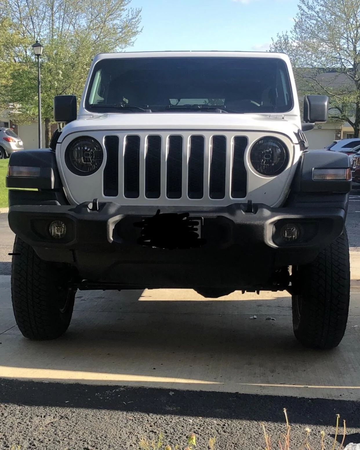

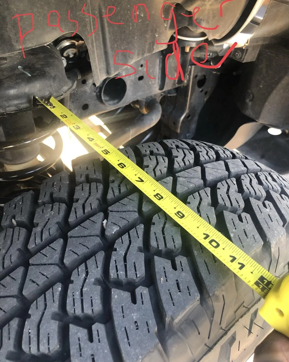

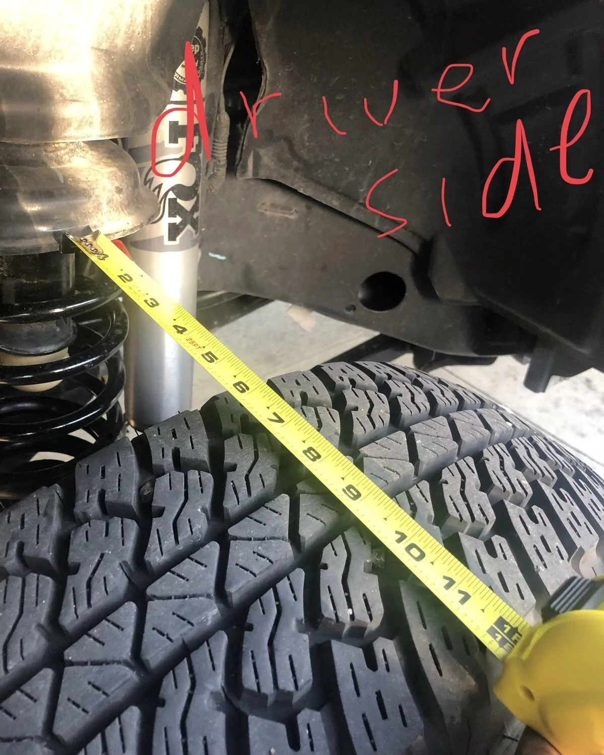

Here’s my friends sport s on Mopar kit, he got 3.5” of lift. You can see the axle shifted from the front and he measured an inch off in the front and 3/4 “ in the rear. He decided to go with the relocation bracket instead of adjustable track bar in the rear however.
Cool, thanks for posting the pics for reference. Did the relocation bracket help with the rear?
Yes, the axle shifts because you’re putting the track bar on more of an angle so by lifting the track bar your putting it back to the same angle it was at stock height therefore realigning the axle. It’s not as precise as an adjustable track bar but it puts it back within specs. I prefer the adjustability of the adj. trackbar personally.
