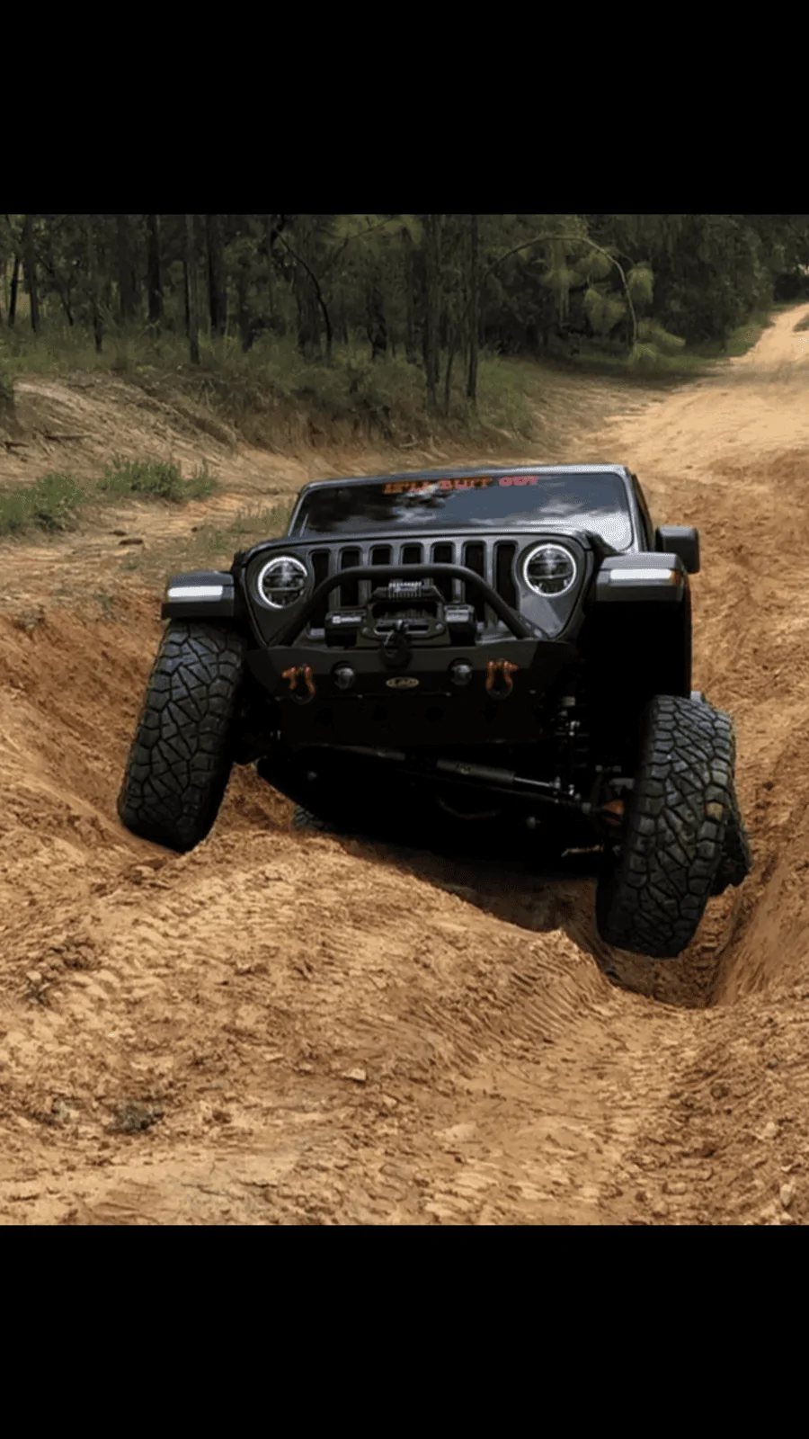

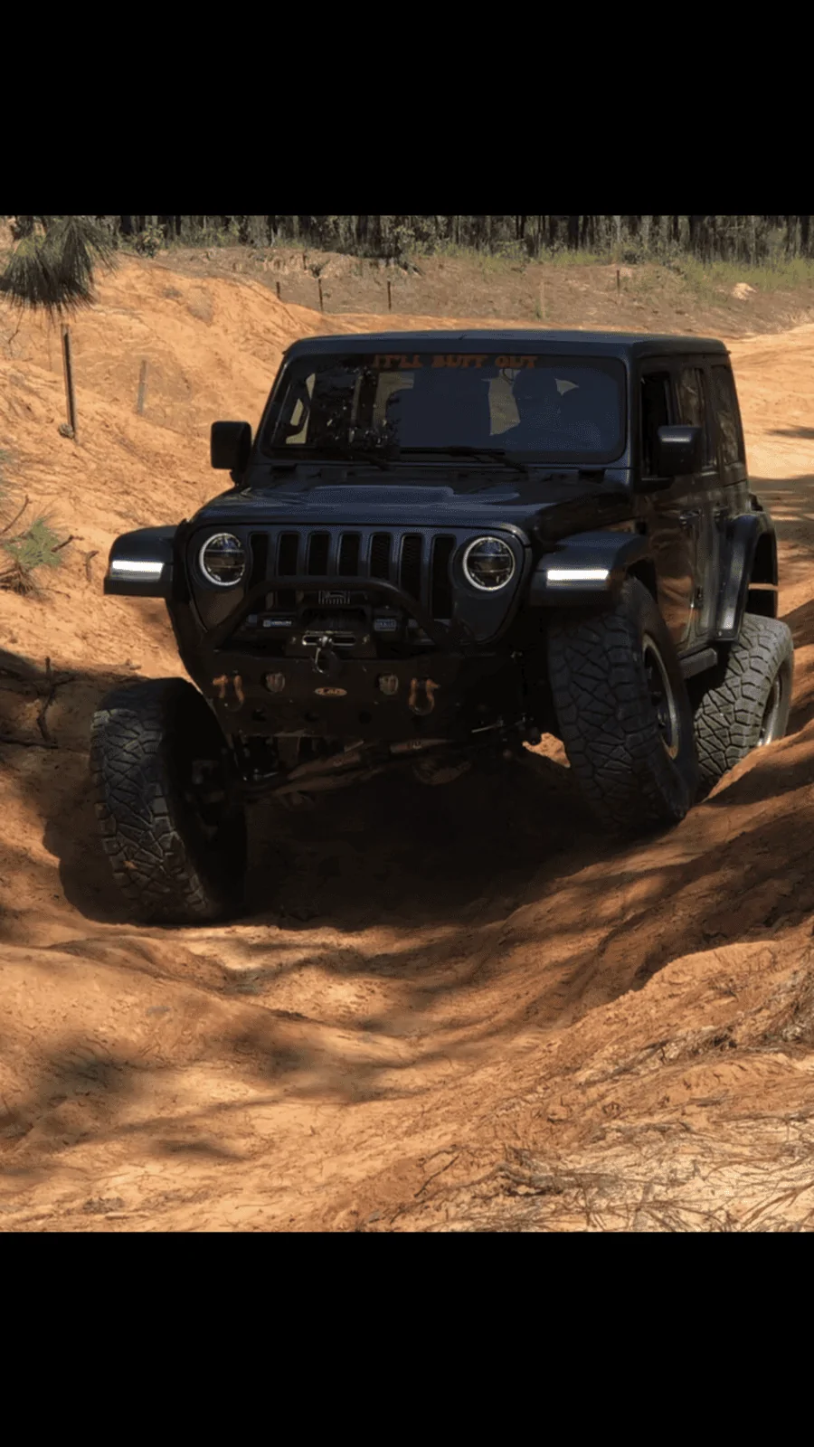

If the shocks would extend 3 more inches I might still be running it, who knows. I just felt I wasn’t getting the full potential out of my rig so that’s why I switched. Here’s a couple pictures to see the amount of shock travel and the difference in articulation. You can see Mopar shock is fully extended and it doesn’t let the wheel touch the ground in this particular situation....:)... sorry about the wall of text..:facepalm:
Mopar
Jeep Wrangler JL Mopar Lift Kit vs.... B37D5644-1013-4C3C-925D-A57073CA0BA4
Rock krawler
Jeep Wrangler JL Mopar Lift Kit vs.... 32A5B498-D889-4AB8-9BD1-8B7C65BA9F46

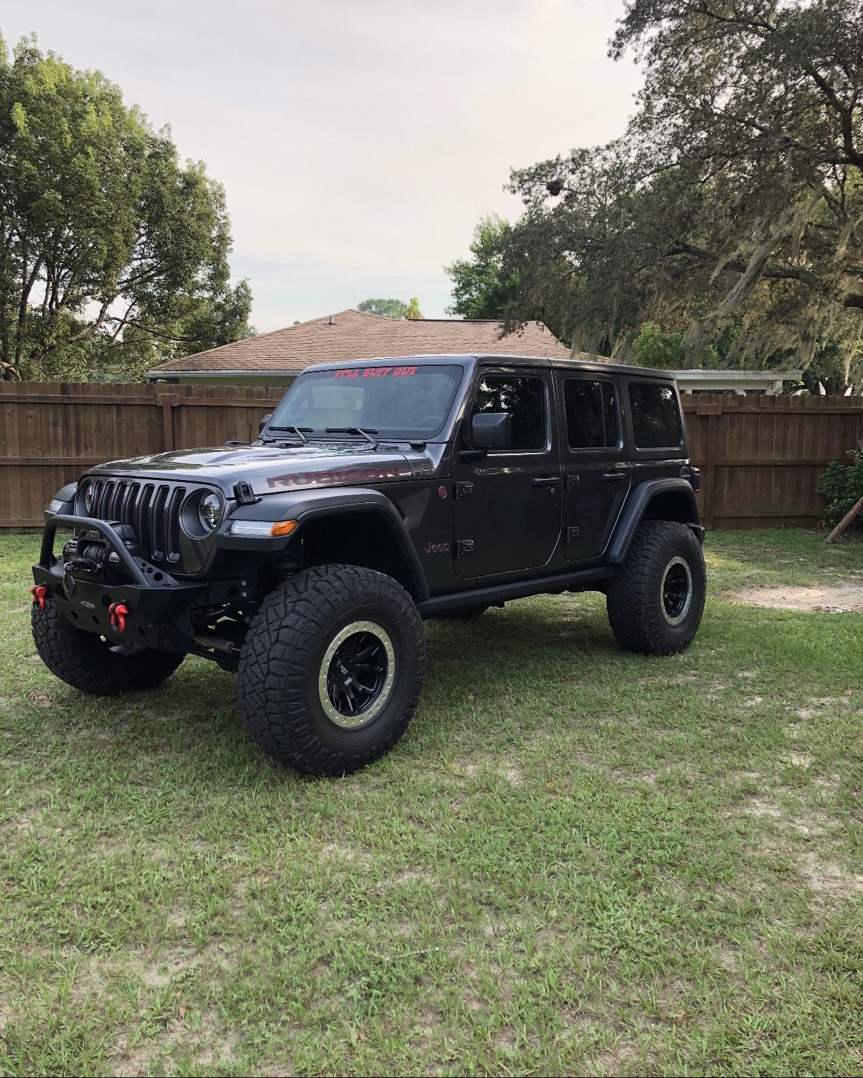

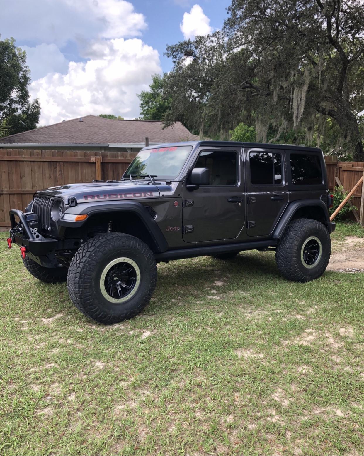

Here’s before and after.
Mopar
Jeep Wrangler JL Mopar Lift Kit vs.... 61765D0D-D370-4BB7-928D-0A8782885F2A
Rk
Jeep Wrangler JL Mopar Lift Kit vs.... C2070D36-AC9F-4D7E-8391-94CD76F299E7
