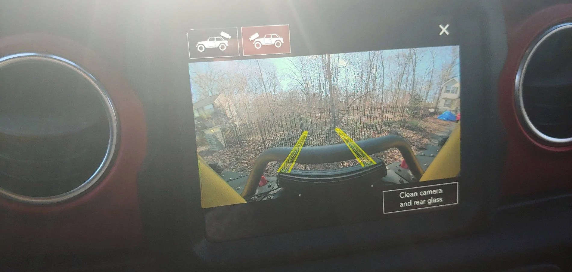

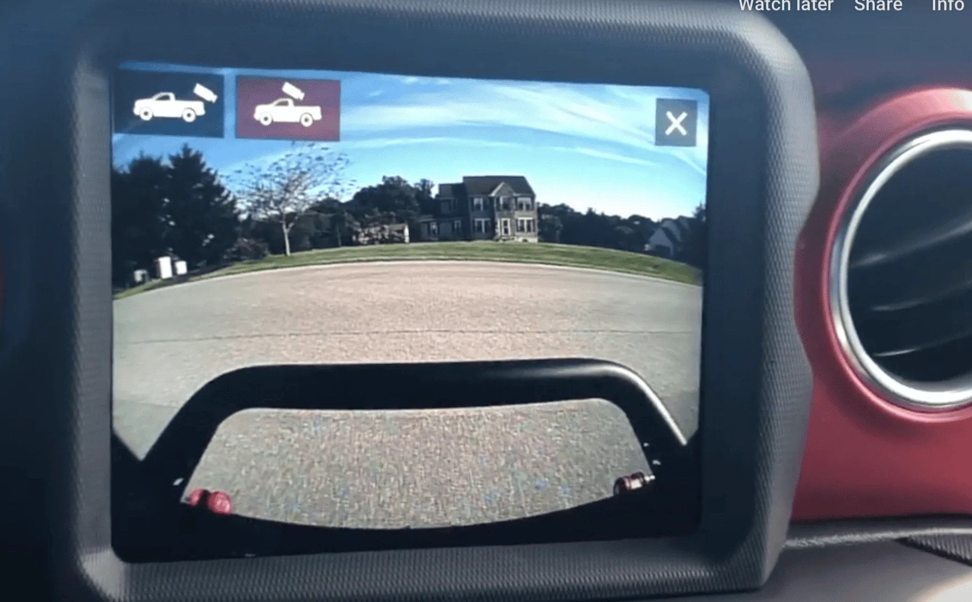

This is the view from the mopar '21 option with a medium warn bull bar and a nilight light bar. It works well enough for placing tires on rocks and not needing a spotter for some things. With the mopar head unit, you probably won't get better quality since the video input just can't support greater than 480
The factory front trail cam is high definition. With this option an extra video processing module is added that connects to all of the cameras and the one high definition input on the radio.
