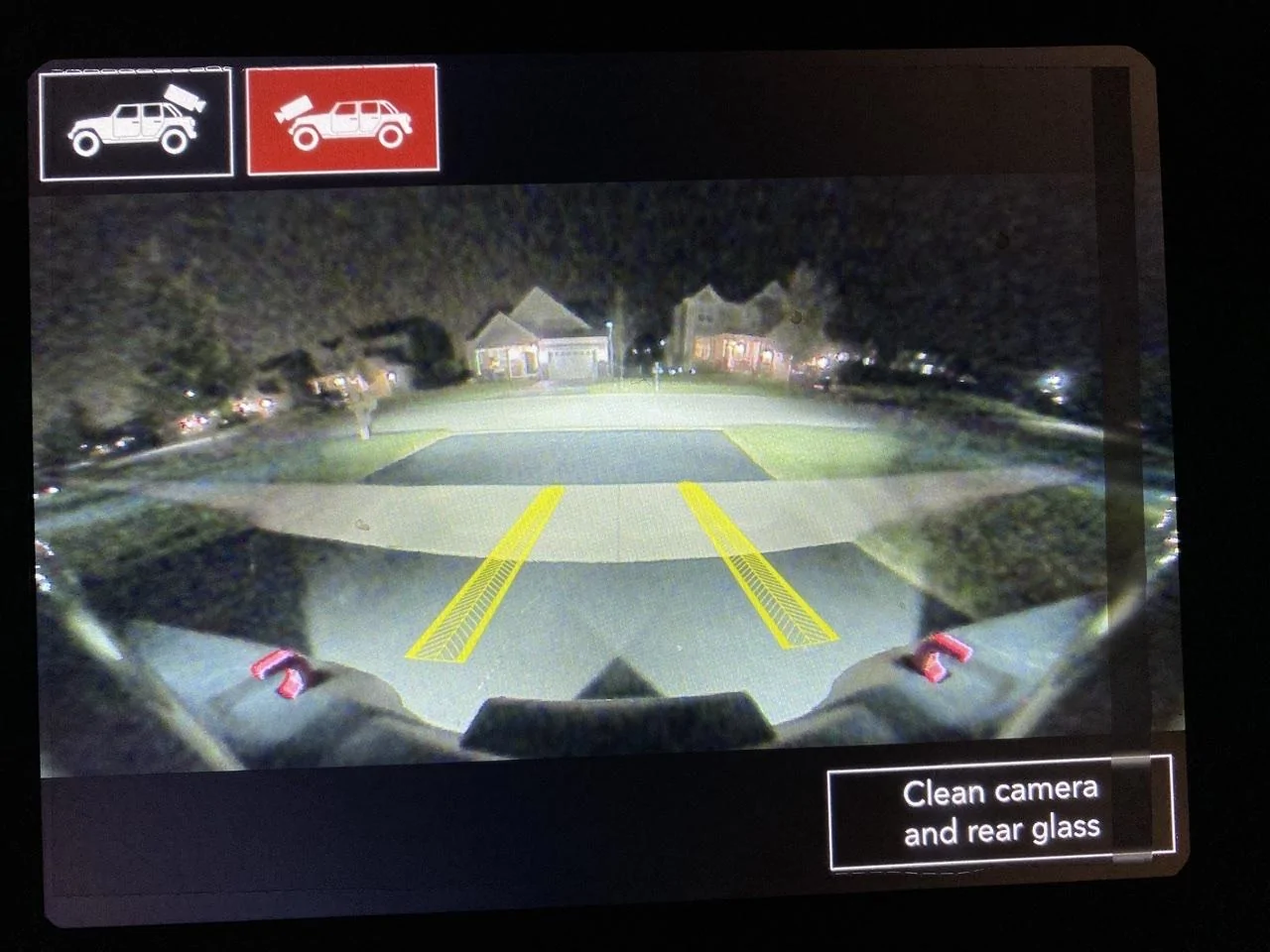

That is part of the camera not the Tazer I think. The camera I bought offers the lines like a back up camera. However if you do not want the lines you clip a wire and the lines are gone. That is why I beleive it is the camera not the radio of Tazer that does that. the Tazer just "turns on" the camera function in the radio.
With the camera you purchased, do the lines move when you turn the steering wheel? Also, what camera did you get?

Not sure if they moved but I doubt it. I didn't want them so I cut the wire sorry.
https://www.amazon.com/gp/product/B083SF5VVN/ref=ppx_yo_dt_b_asin_title_o00_s00?ie=UTF8&psc=1
There are inputs on the existing 8.4 systems for another camera. The problem is that it is only standard def as opposed to the high def cam used for backup. The limiting factor is the inputs on the head unit. Maybe in 2021 they will change the design but right now youre stuck with a grainy picture for a front cam.
This is fact. Doesn't matter how good of a camera you buy it is standard def and nothing like the rear. It will work just fine offroad or if you were trying to park to something close.

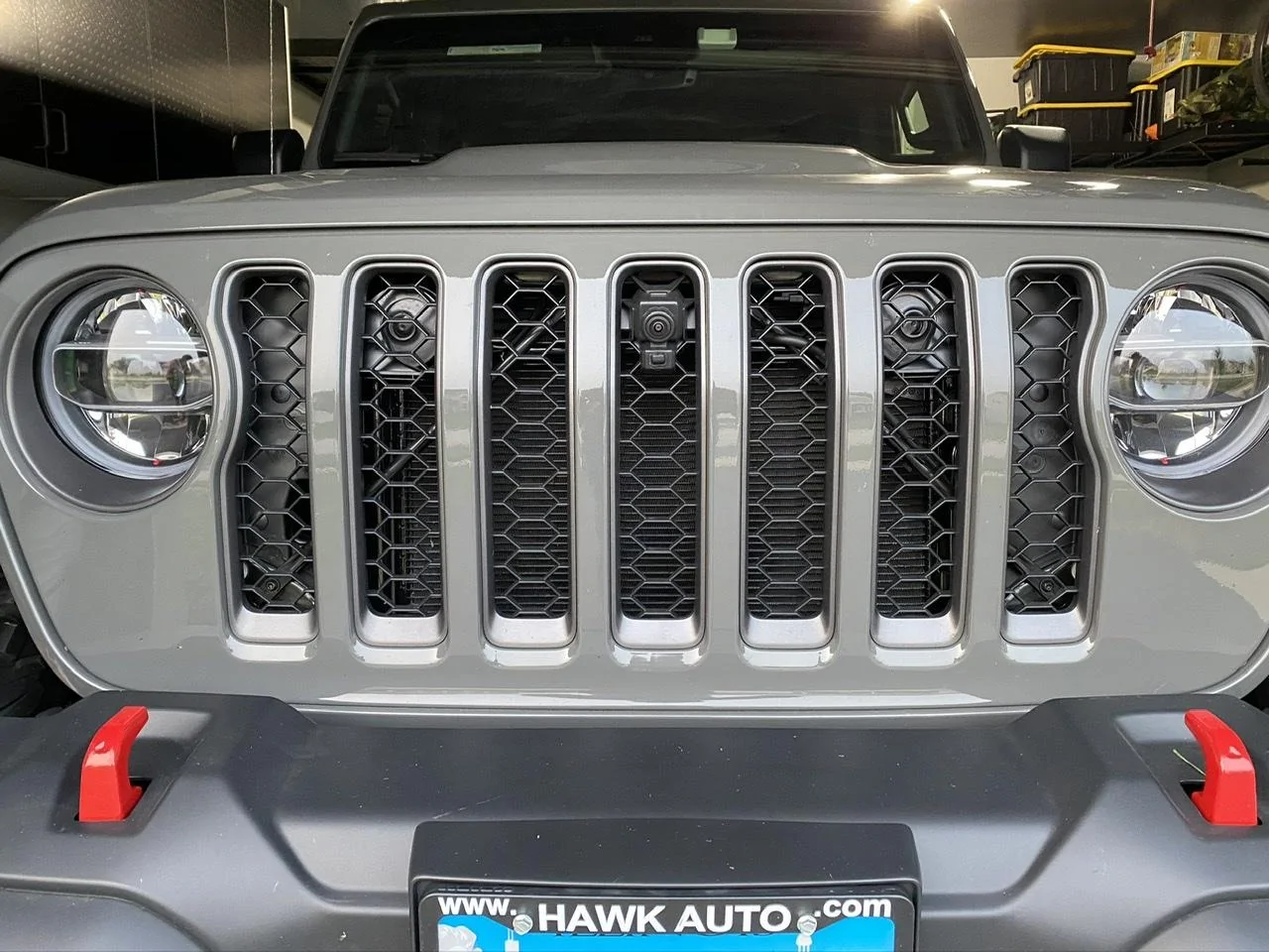

I heard all 8.4” Uconnect screens have the dual inputs for both cameras. I can confirm the 21 JL has it as an option. The camera is positioned in the place of a hood lock.
