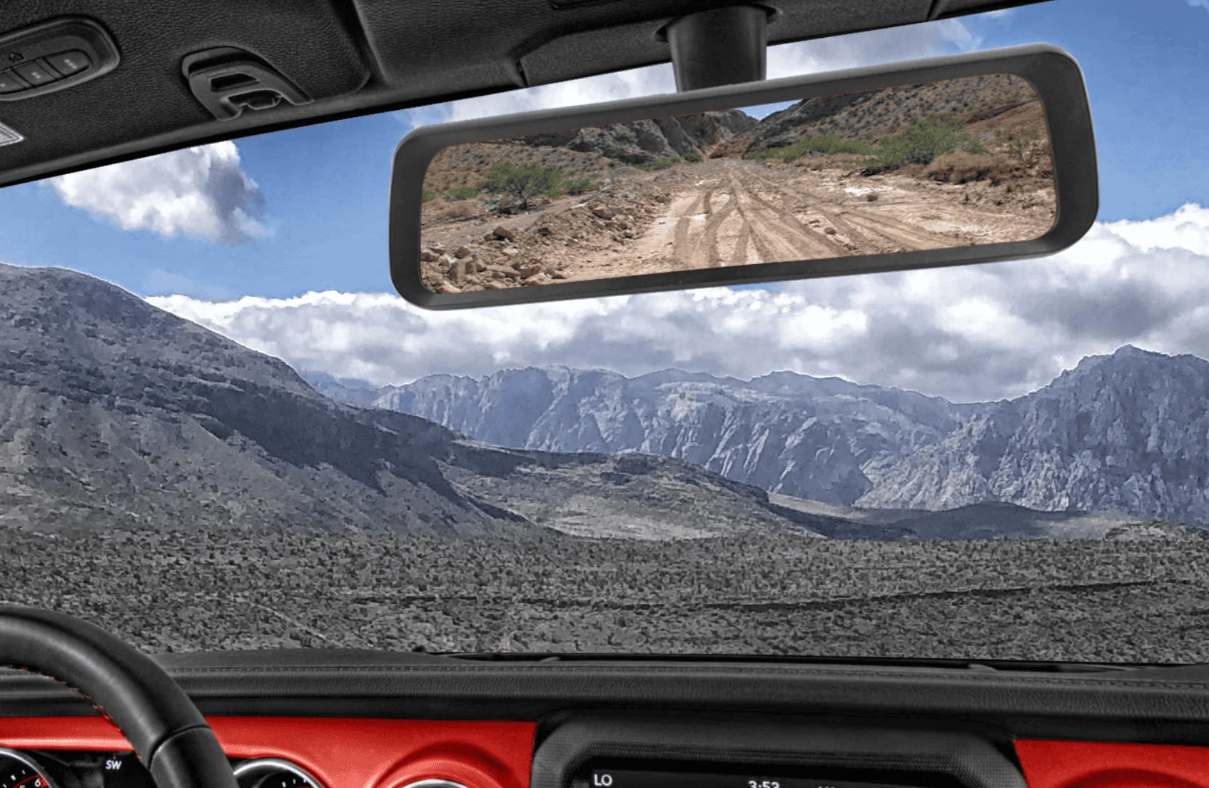

As with many JL owners, I also am searching for a good solution for a front trail camera. Just can't bring myself to go the Tazer route with a grainy 480i image, still not convinced that the cargo camera input on the OEM 8.4 Uconnect will not accept something greater than 480i resolution...I also do not want any 'temporary' mount using an iPad, want a clean & clutter free install. Easiest solution would be for Mopar to offer a retro-kit which would allow switching between the backup camera and trail camera, doubt that will happen anytime soon if ever...
I did come across this HD FullVEU mirror from Brandmotion. Their website says it only works with their camera at this time but to check back for updates. I sent their technical support team an email asking what would be required for this to work with the OEM front trail camera, this would be an ideal solution for my needs if it can be made to work!
Jeep Wrangler JL Mopar front trail camera Screen Shot 2020-12-06 at 7.52.59 AM
