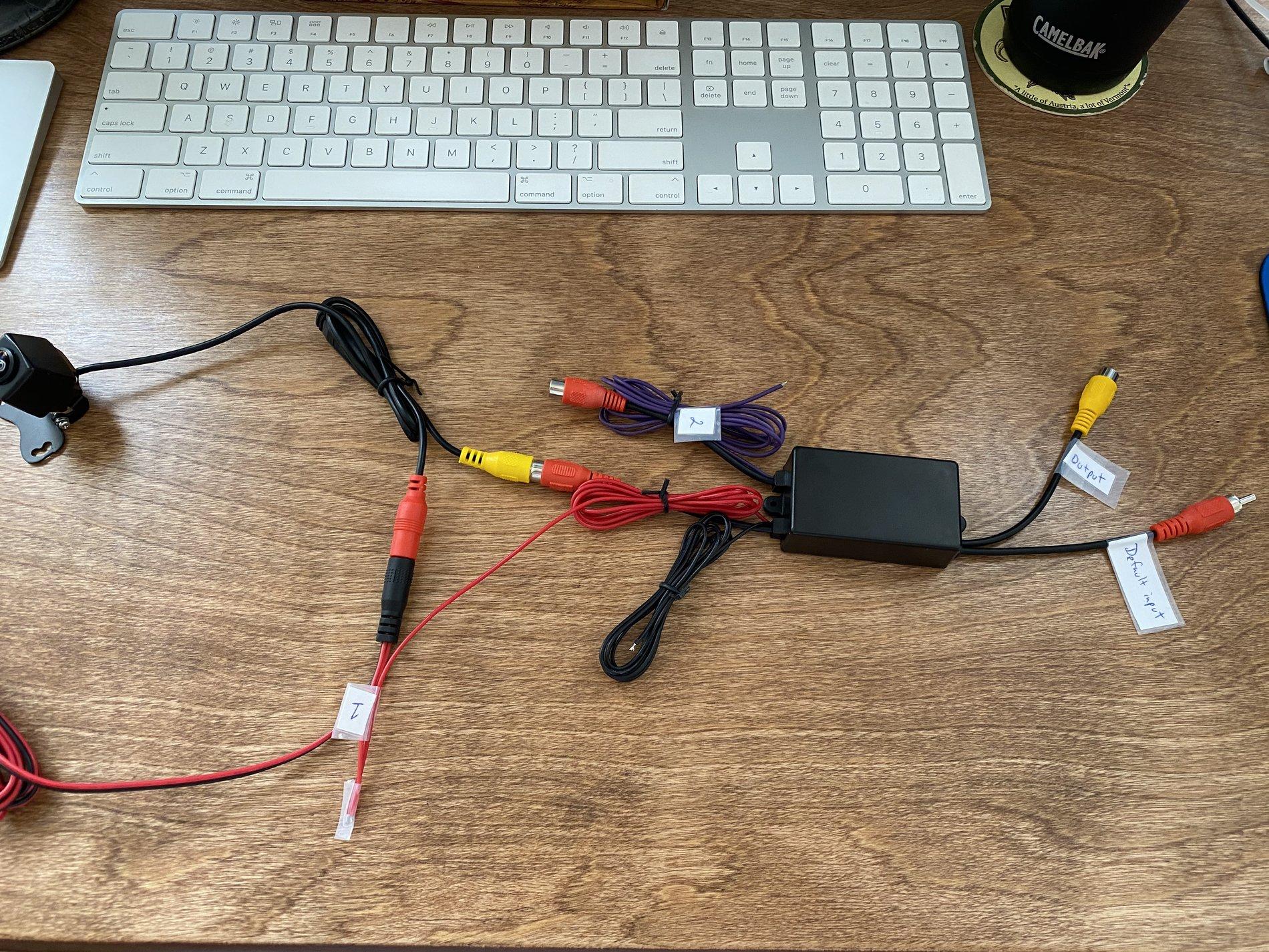

A coupe weeks ago I bought a Natika 720P camera from Amazon for $40. It has a yellow RCA and a red DC power plug. The supplied RCA cable has short red wires coming out of the RCA plugs. One end connects to the reverse signal from the head unit, the other end connects to the power wire. The power wire itself has red and black wires for 12v and ground, plus the short red wire to connect to the RCA cable's red wire. Not sure if it makes complete sense to me, but whatever. Here's a picture:
I planned to use an RCA switcher and a small DPST in the cabin to select between the cameras. Here's a picture of the switcher I bought ($26), which is actually a 3-way switcher, connected to the camera. I eliminated the long RCA cable for clarity:
The red wire (#1) would be connected to my in-cabin switch providing a signal to turn on the camera and tell the switcher to select that input. Bundle #2 could be used for a third video input. When I purchased this I thought the OEM camera would plug into that red "default input" RCA and the yellow "output" RCA would plug into the head unit. I had no idea what a Fakra plug was at the time. I was so young and foolish a couple weeks ago.
Okay, here's the question. Can I use a Fakra to RCA adapter to connect the OEM camera to the switcher, then use a RCA to Fakra adapter to connect the switcher to the head unit? If not, why? What is the bottleneck, and what would it take to overcome it?
