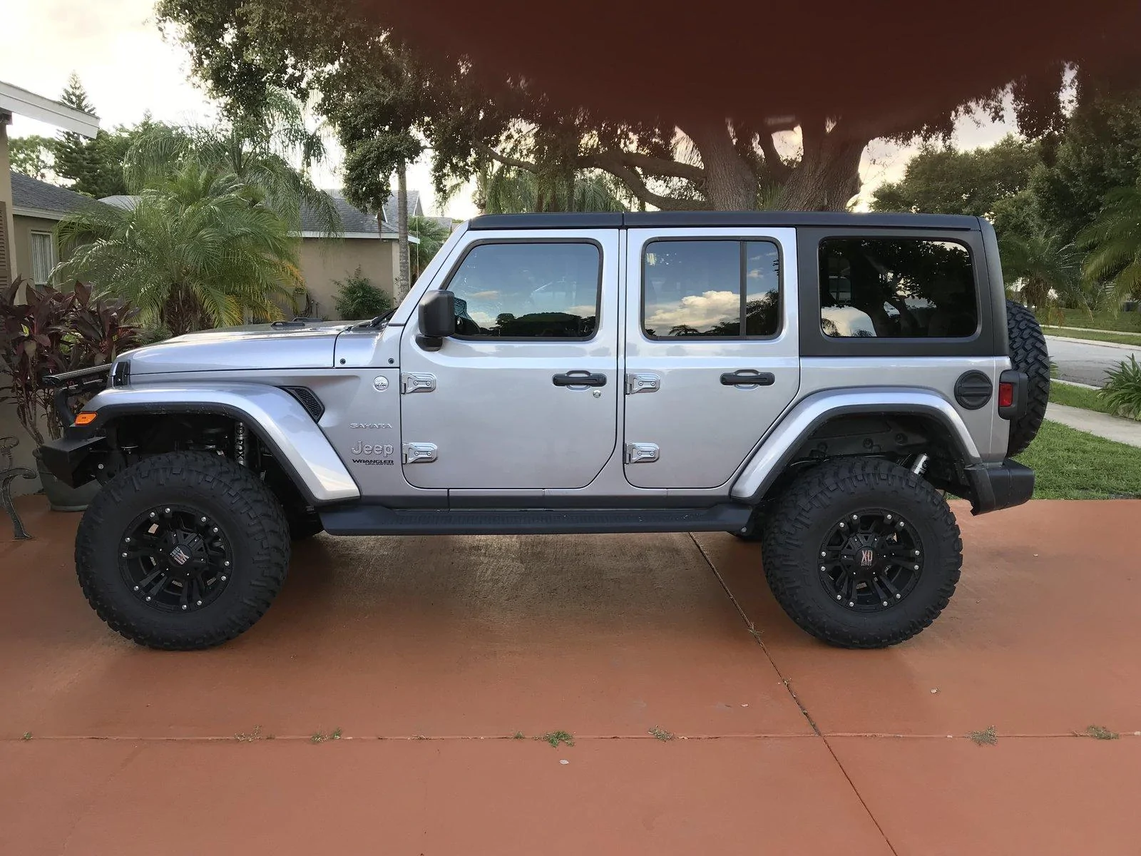

@Slim I fell into the installing of the back bump stops per the manual!!! Had to take them off today during the final spec torque process. Slim warned us, and at the time I did not see anything that would get in the way. IT DOES! Don't put the Rear Bump Stops on until After final torqueing to specs!
Looks good Fire Captain!

It looks great! Well done. I feel more familiar with my Jeep after doing it.

Looks great. How much more ground clearance does the lift give you?
I certainly appreciate your post, it was very helpful! I know more about the Jeep and suspension parts now also, have the pride of saying I did it, and lastly have some tools that I would not have if not for tackling the job myself, purchased with the money I would have had to pay someone to install it. I do appreciate it!
Thank you! I really wish I knew...I measured it last week, but didn't write it down. I am positive it is more than 2", looks more like 3-4", but I honestly don't know.
The lift allows bigger wheel tire combo. That's where you gain ground clearance. Add the lift and run stock wheel/tire and you gain zero as the front and rear diff is in the original pre-lift position.
