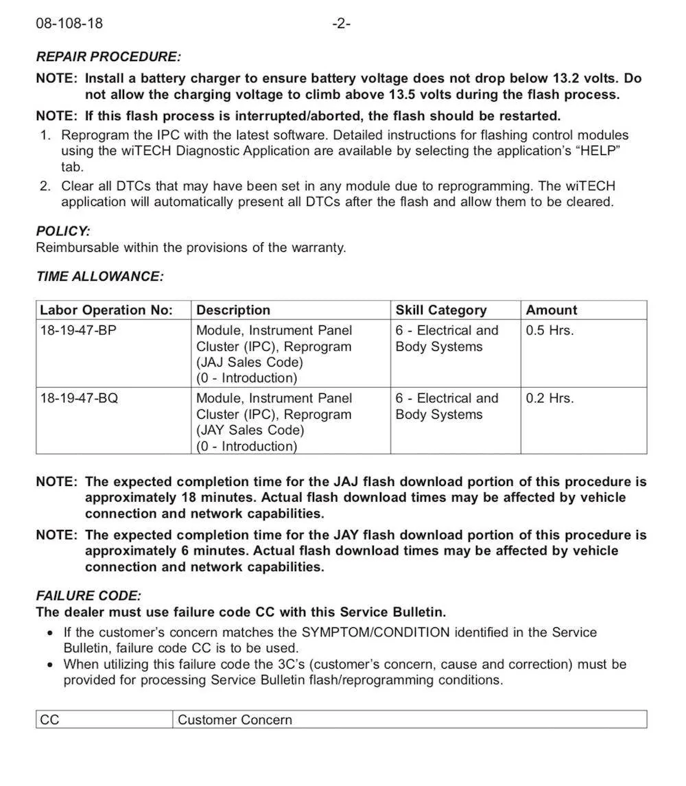

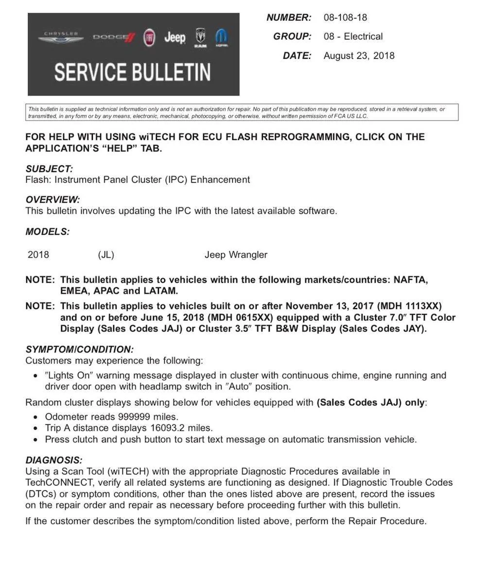

Well I got back from my out of state travel and proceeded to first use JSCAN to check for any fault codes and there were none so then I reset all ECU’s and then removed the SGW bypass module and start/stop elimanator and put all back to factory original.
I did a few restarts and all seemed normal but then the odometer disappeared again and the clutch message showed up but those are the only two intermittent messages I received so I may go to the local dealer and see what the cost is to have the cluster reflashed but if its really pricey i may just let it go as it works 99% of the time.

I don't get the 999999 odometer reading it just disappears along with the clutch message being displayed but all other parts like trip miles, mpg’s etc… show normal and if I shut if off and go back and start after the EVIC powers off the total miles on the odometer come back and says press brake to start but 99% of the time it works as designed.
I'm sure doing the TSB is not free and I have 91k miles on my 2018 but I will go in and get as estimate on the reflash when I have time.

I’ll see if I can dig out the paperwork when I had it done to see the cost. It’s probably in my file. It “may” have been a part of the diag fee. But things may have changed by now or I could not be remembering correctly.

Found my service order. $191.28 for the reflash. It annoyed me enough to get it completed. I had just purchased it, and I like to keep my vehicles tip top.

I'm sure its gone up some since you had yours done so when I have time I will go in and give them the TSB number and see what they give me for an approx cost.
