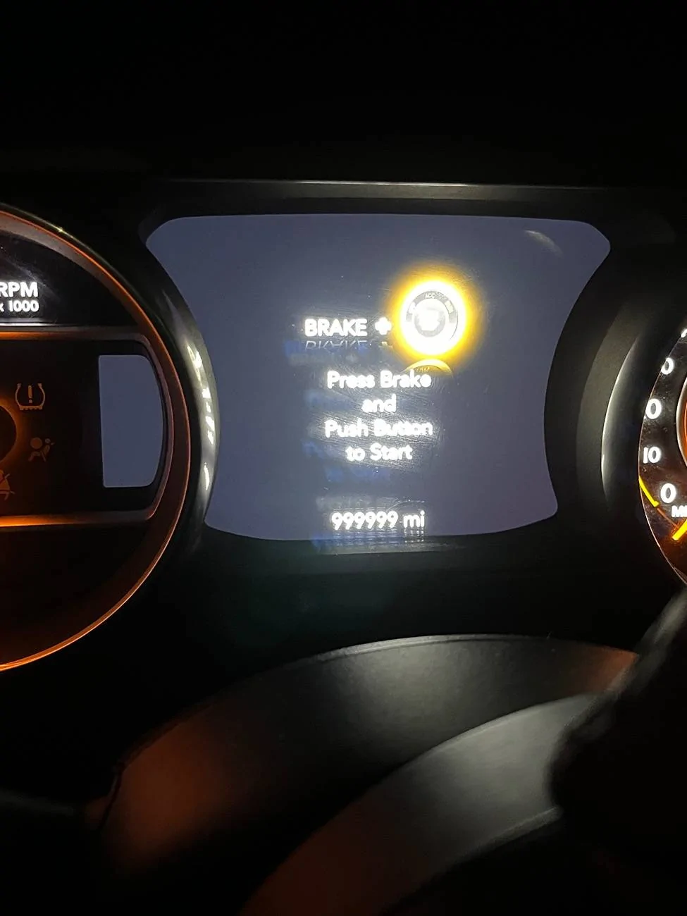

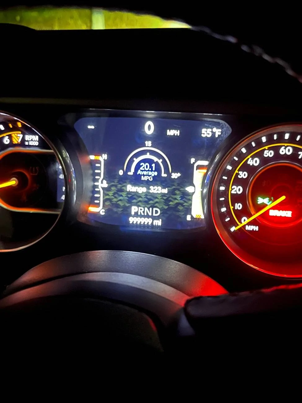

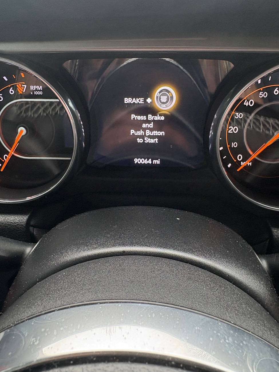

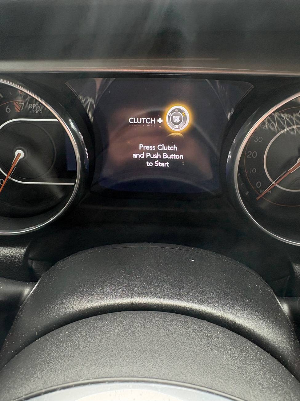

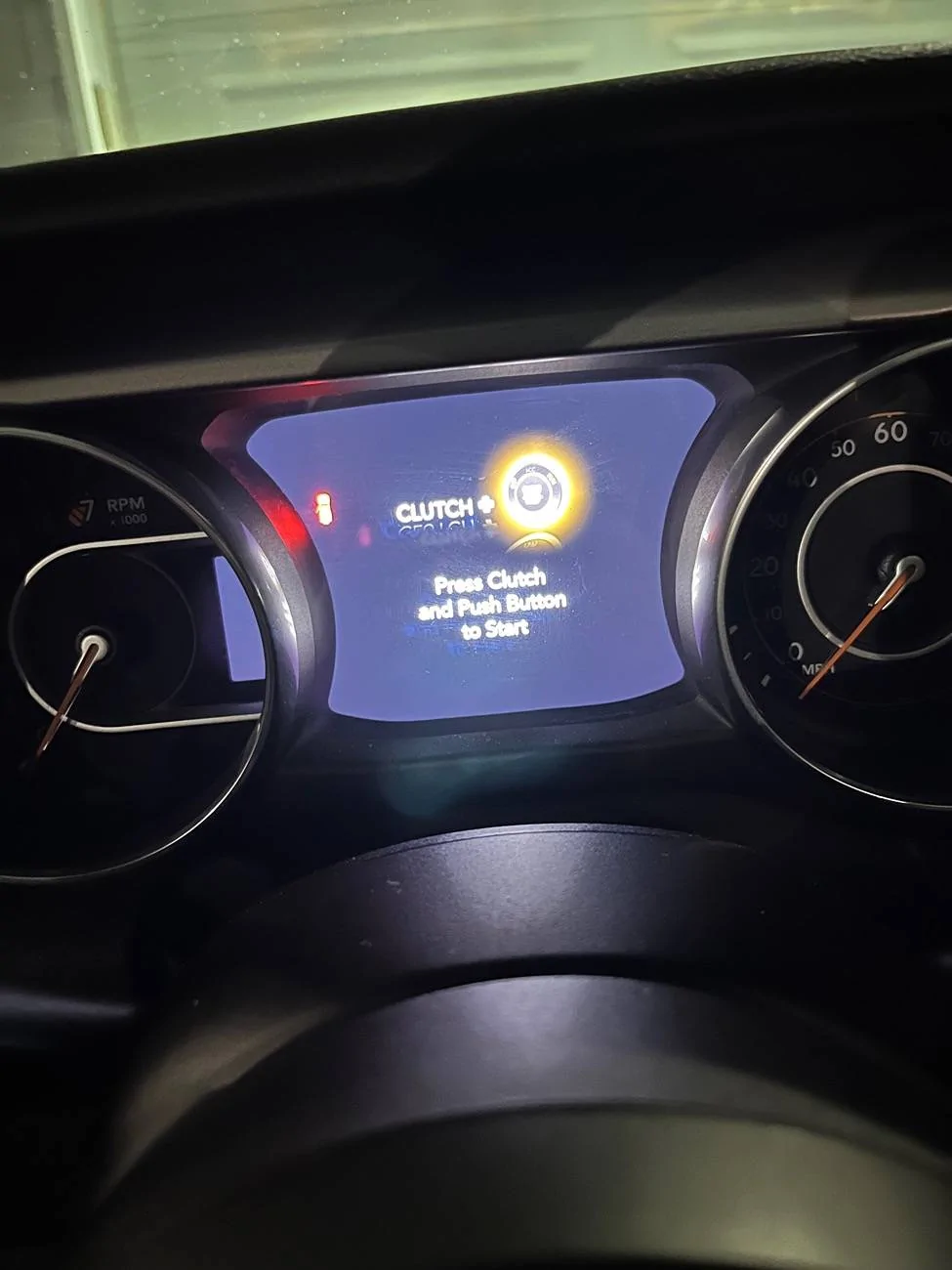

I would not ignore it, but it is your ride. This is a couple takes of mine. I have an auto and it displayed clutch.

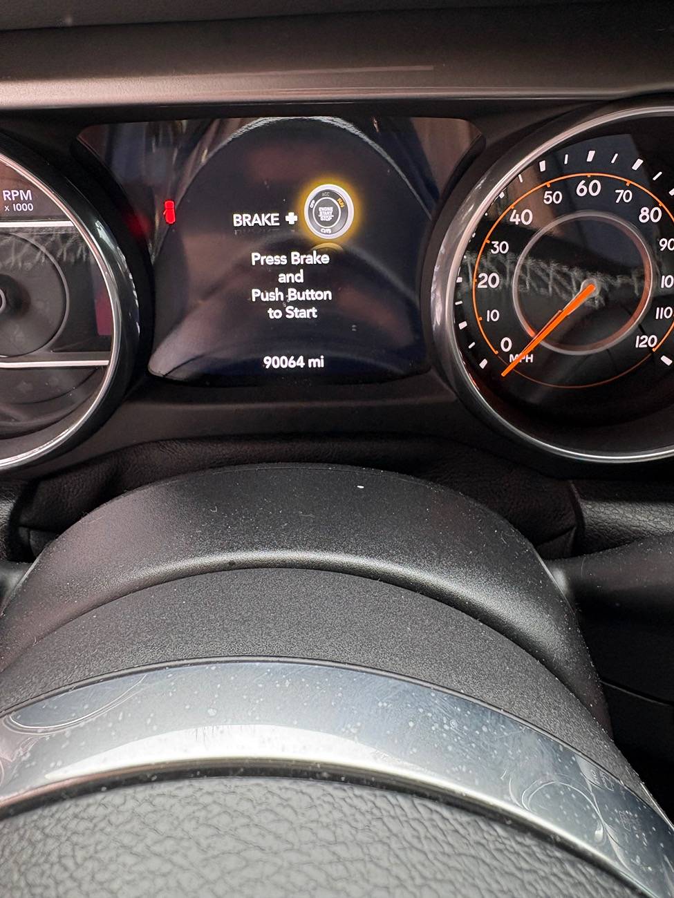

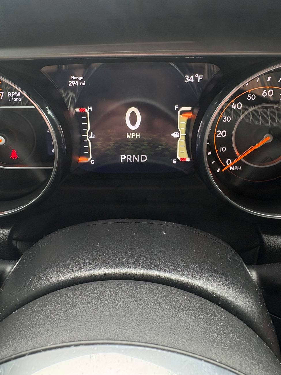

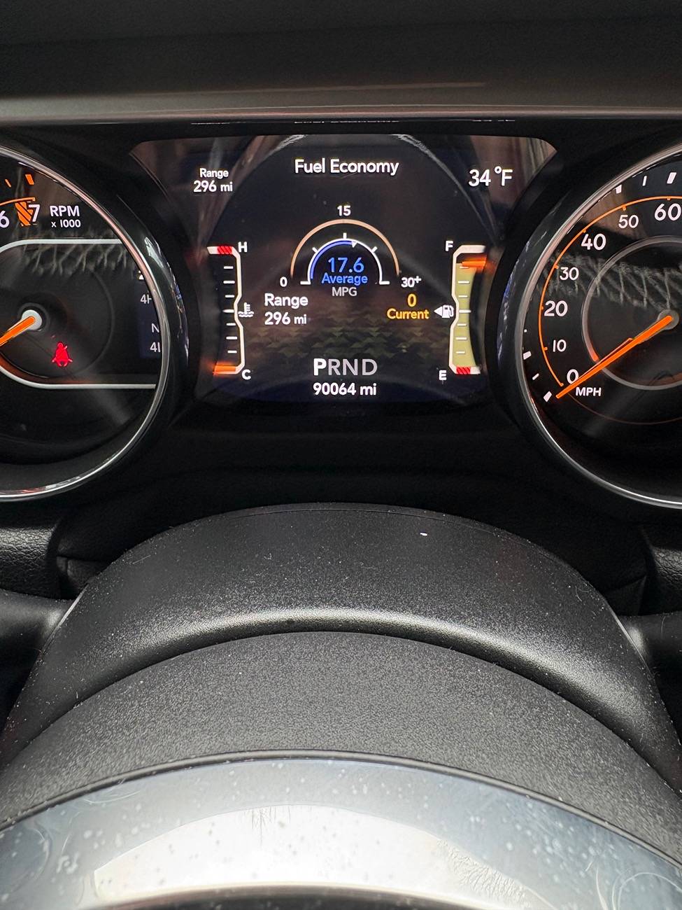

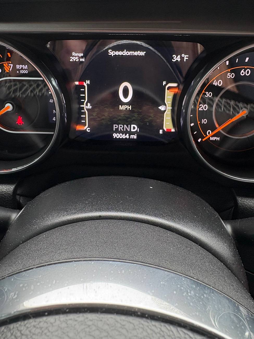

I just want out and got in and on first start all was normal so o started it let it run a few minutes and then shut it off and checked all fuses to ensure they were seated and all were so then I got back in and it displayed press clutch to start and odometer total was gone so I shut it off and waited 10 mins and checked again and it displayed press brake to start and odometer was back 🤣🤣
