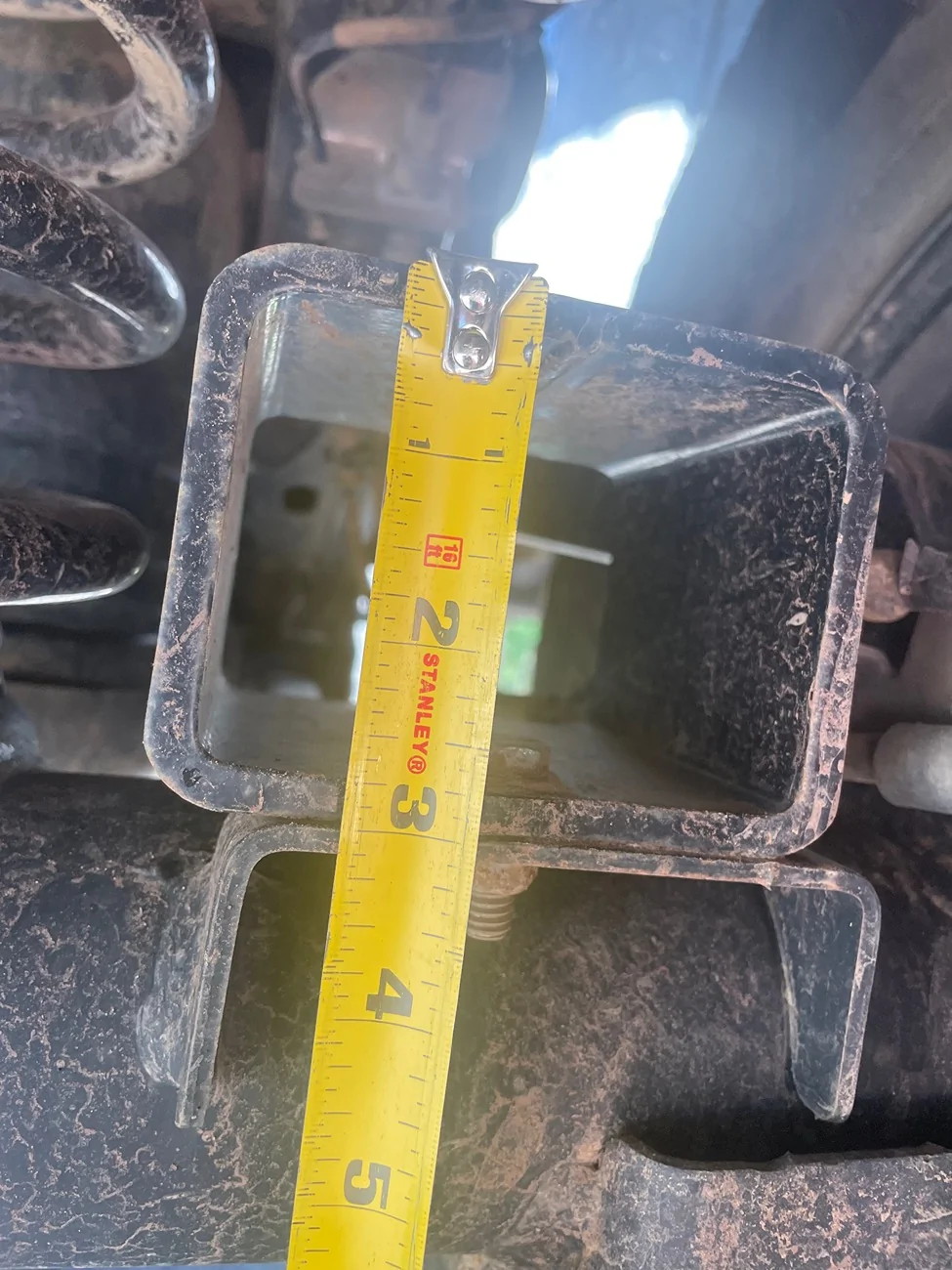

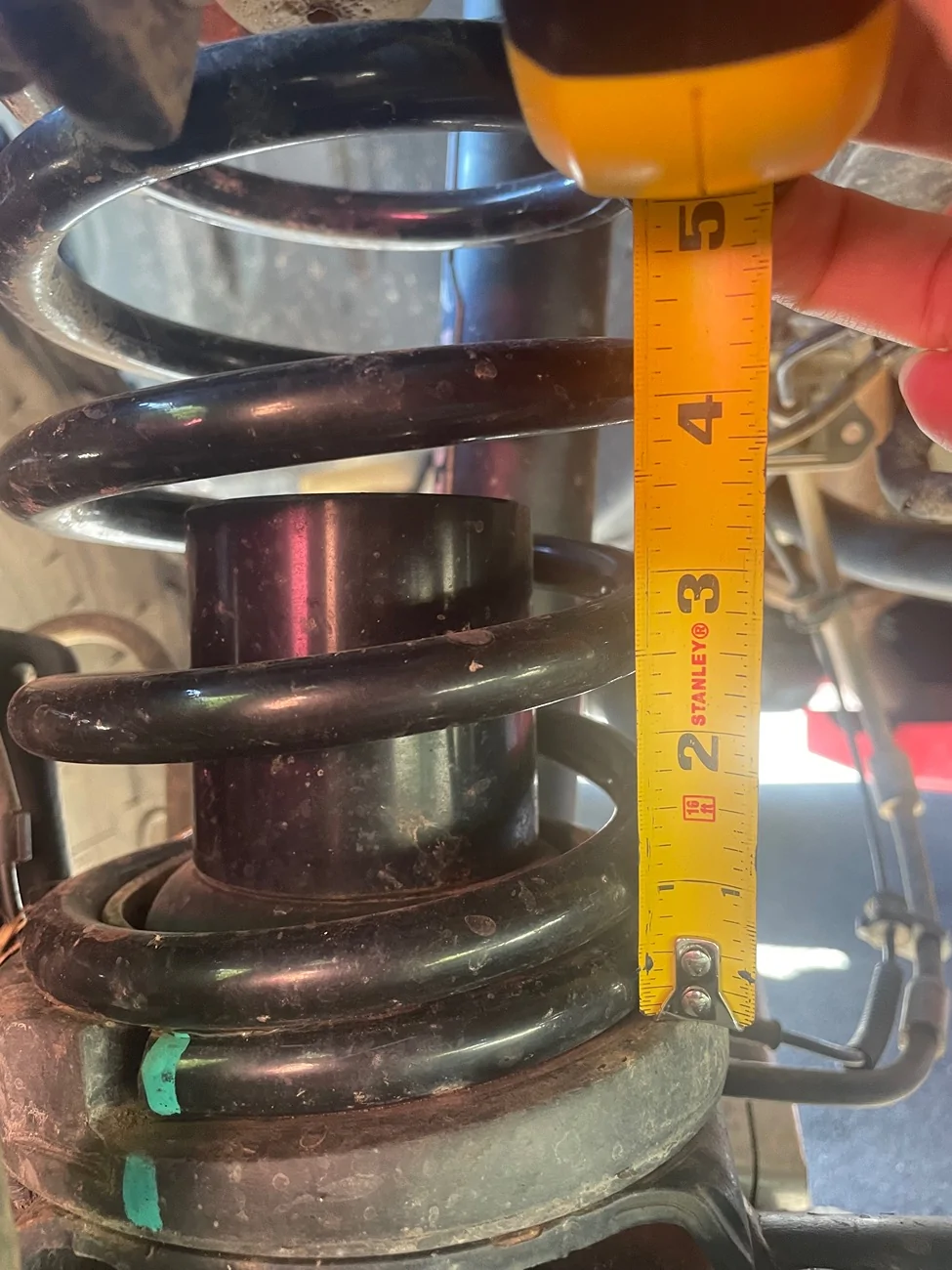

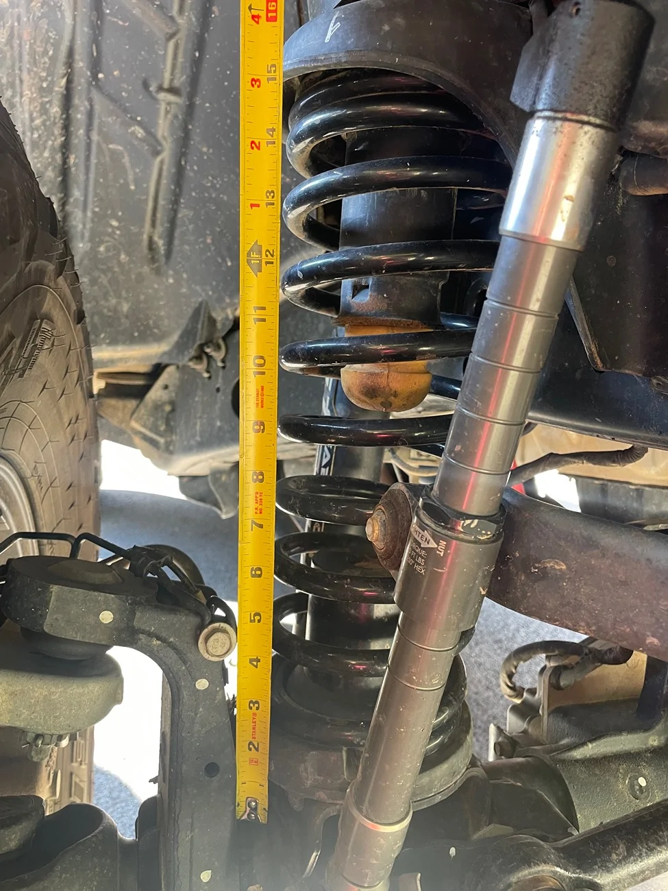

Took some measurements, note that the Jeep is on a very very slight incline.
I measured to see the lift height and it’s showing almost 5 inches taller than your diagram. The lift is supposed to be 3in for Rubicons, mine is a Sport but that still seems like a lot. And the slight incline shouldn’t account for the extra 1-2 inches. But we can look into this later lol. Does this mean I should use the 3.5-4.5 inch Ranchos? The rear bump stop is 3inches and the front 3.5 but I’m measuring from the coil correction pad.
All of this is starting to make my brain hurt, I really didn’t think it was going to be this much for just shocks.
It is hard to tell in the picture, but are you measuring to the top of the axle tube in the front?
You can also just take a measurement center of shock bolt, to center of shock bolt.
Top of the axle tube. I can measure from the shock bolts if that'll give a better idea.
Definietly looks like you got some height. Normally the spring correction pad goes around the bump base, so it looks like 2.5" front and 3" rear bump extension.
Looks like you're running something like 5" of uptravel in front from the picture, which should put you at 3.75" over a rubicon, solid amount of lift and uptravel. If you want to backcheck, I'd expect your front shock eye to eye measurement at ride height to be 23.75".
Just to clarify my concern with the shorter 9000s, they have an extended length of 25.21" which would have given you less than 1.5" of downtravel (I'd expect you'd be able to feel that top out on the road over bumps).

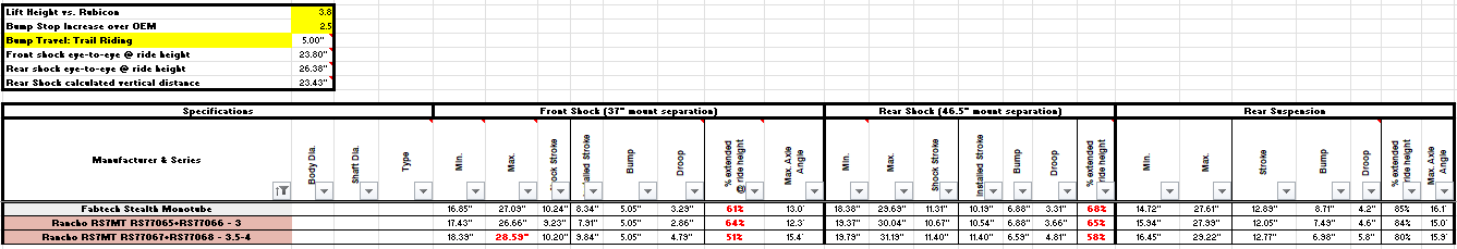

Alright, I've got your RS7MTs and Stealths loaded into AnnDee's spreadsheet for you with my assumed lift and front bump:
Jeep Wrangler JL Mid-level shocks 1756216934466-gw
The longer RS7MTs look like a good fit. If you off road a lot, 28.59" of extension is flirting with drive shaft wear on a stock driveshaft in my experience, that's with the 2.0L (4xe in my case) front skid bar touching the slip joint boot at full droop. But, it gets you a nice 50/50 balanced up/down travel, basically maxing out your stock drive shaft off road flex.

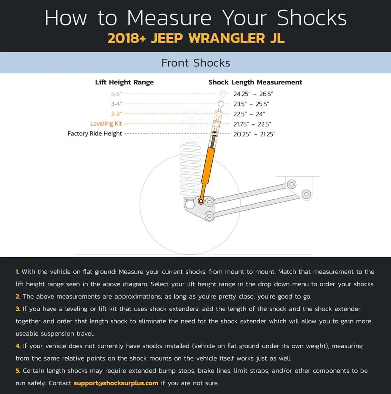

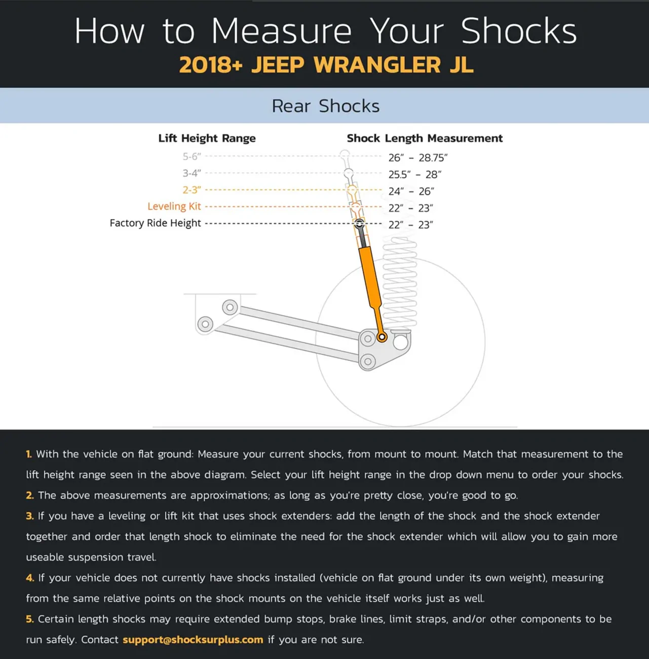

I would encourage you to use this schematic and measure based on these "guidelines". Pictured are the stock lengths so measure yours and then see if your sitting at 3". If you are sitting at more then that then go with a longer shock. Many companies are really good if you call them with measurements they can help fit you into what you need. This thread may also help you it sounds like a 2dr sport is about 11" and a rubi would be about 12".
https://www.jlwranglerforums.com/forum/threads/help-how-to-determine-lift-size.115142/

Just measured and eye to eye on the shocks are 24 inches front and 25.5 inches rear.
First chart says stock sport is 19 7/8 so I got at least 4 inches of lift.
Took a rough guess at travel length but measure the clean part of the shock at little under 5 inches in the rear. So that gives me a rough idea.
Thanks for all the help. I think I can figure out which shock I need now.
