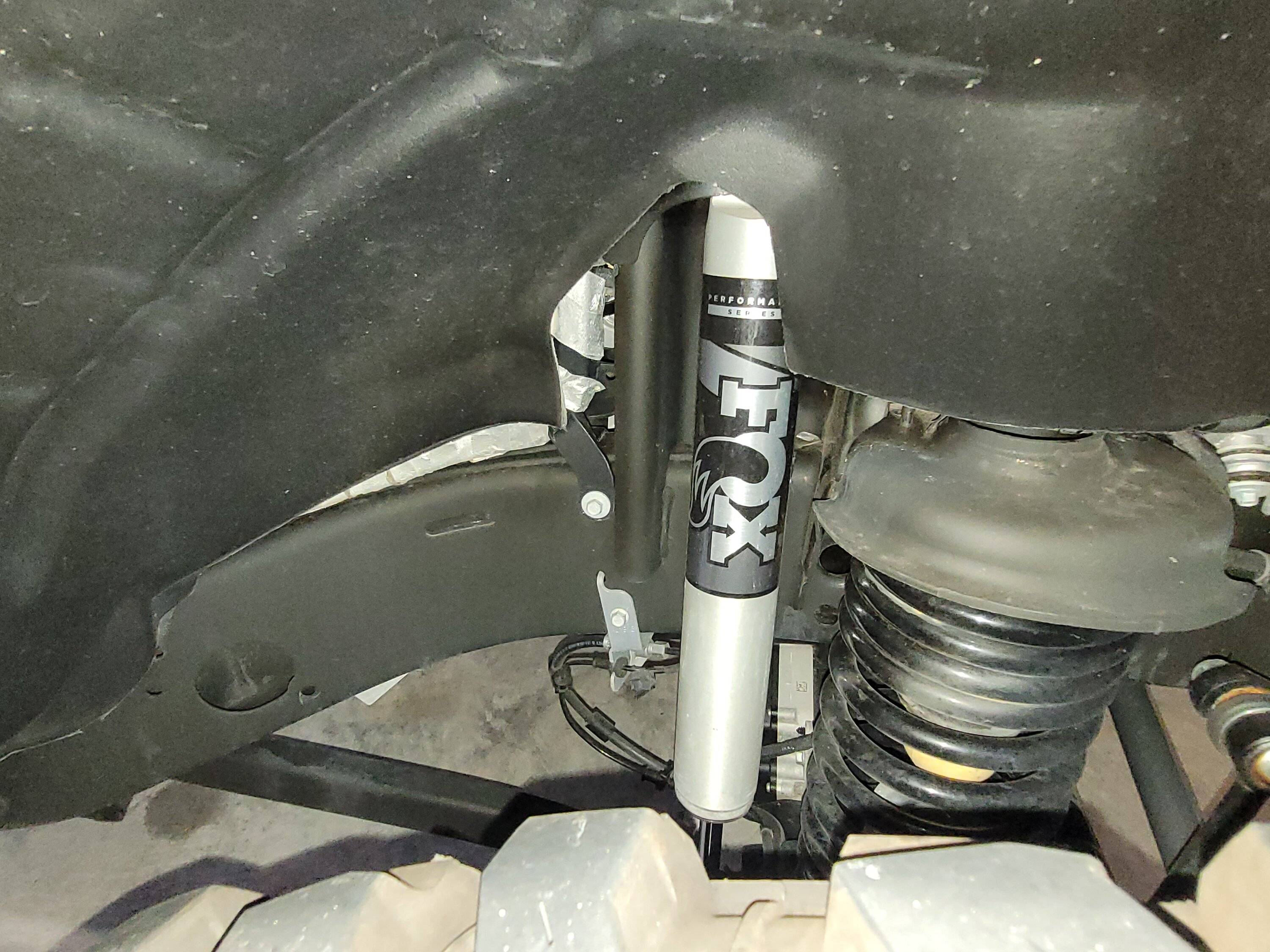

Hi,
I just recently purchased a used 2021 Jeep Wrangler Unlimited Rubicon. It came with 37s, Fox performance series shocks, and what appears to be a decent size lift. The dealer didn't give me any specs but said the prior owner did some mods to it. Is there a way to try to figure out how many inches it's been lifted? Thanks.

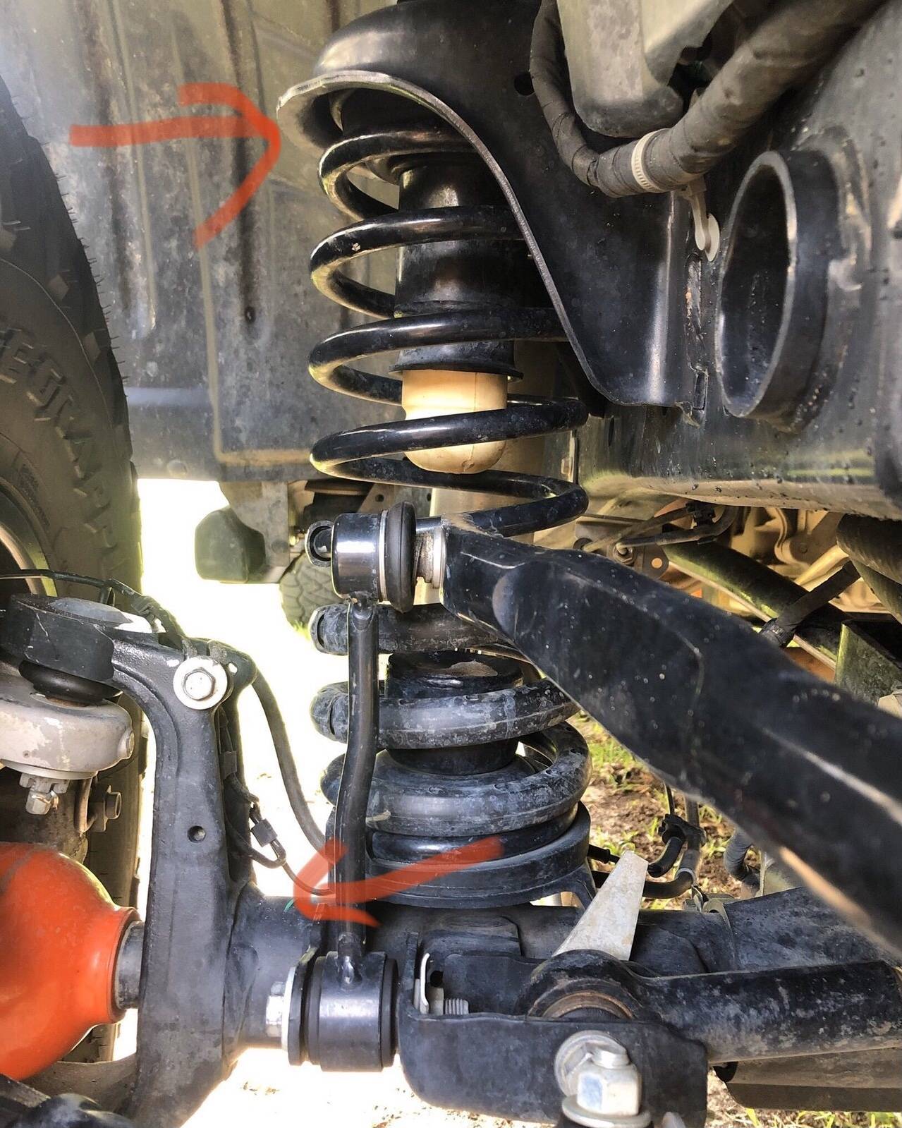

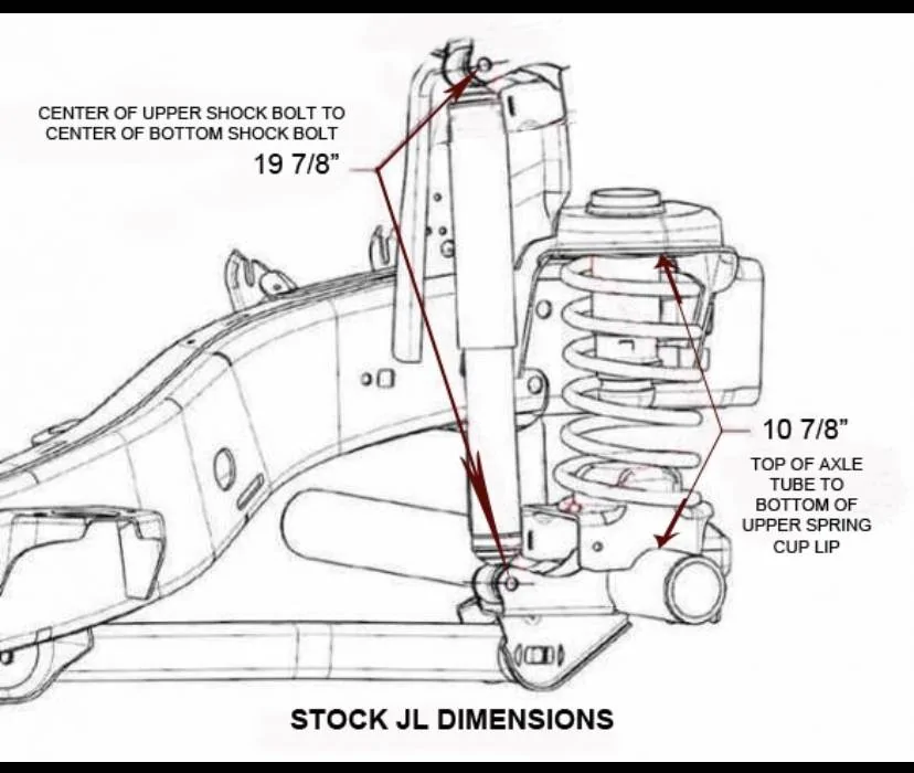

Measure from top of the axle to the bottom lip of the upper coil housing like in the pic…… the stock rubicon is 11-1/4” ish, give or take a 1/4”, whatever your measurement is minus the 11-1/4 is how many inches of lift you got….
Jeep Wrangler JL Help: How to determine lift size 4685EF16-E083-4C52-B1B9-A0F8B0353817
The springs look like Rock Krawler triple rate springs and the front bump stops look like JKS aluminum bumps for JK but not sure, just from looking at your pics. The control arms look stock, but can’t see if they have drop brackets or cam bolts on them… if not then you should address your caster it will drive a 100% better….
If you take some pics of the track bar and sway bar links, I might be able to narrow it down to what lift you have….Are the Fox shocks 2” or 2.5” diameter ??

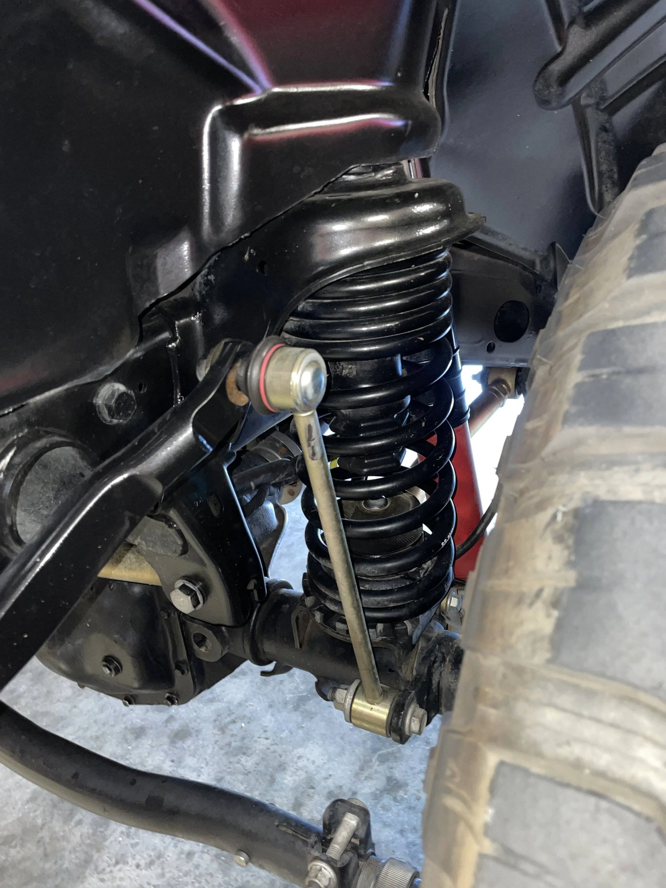

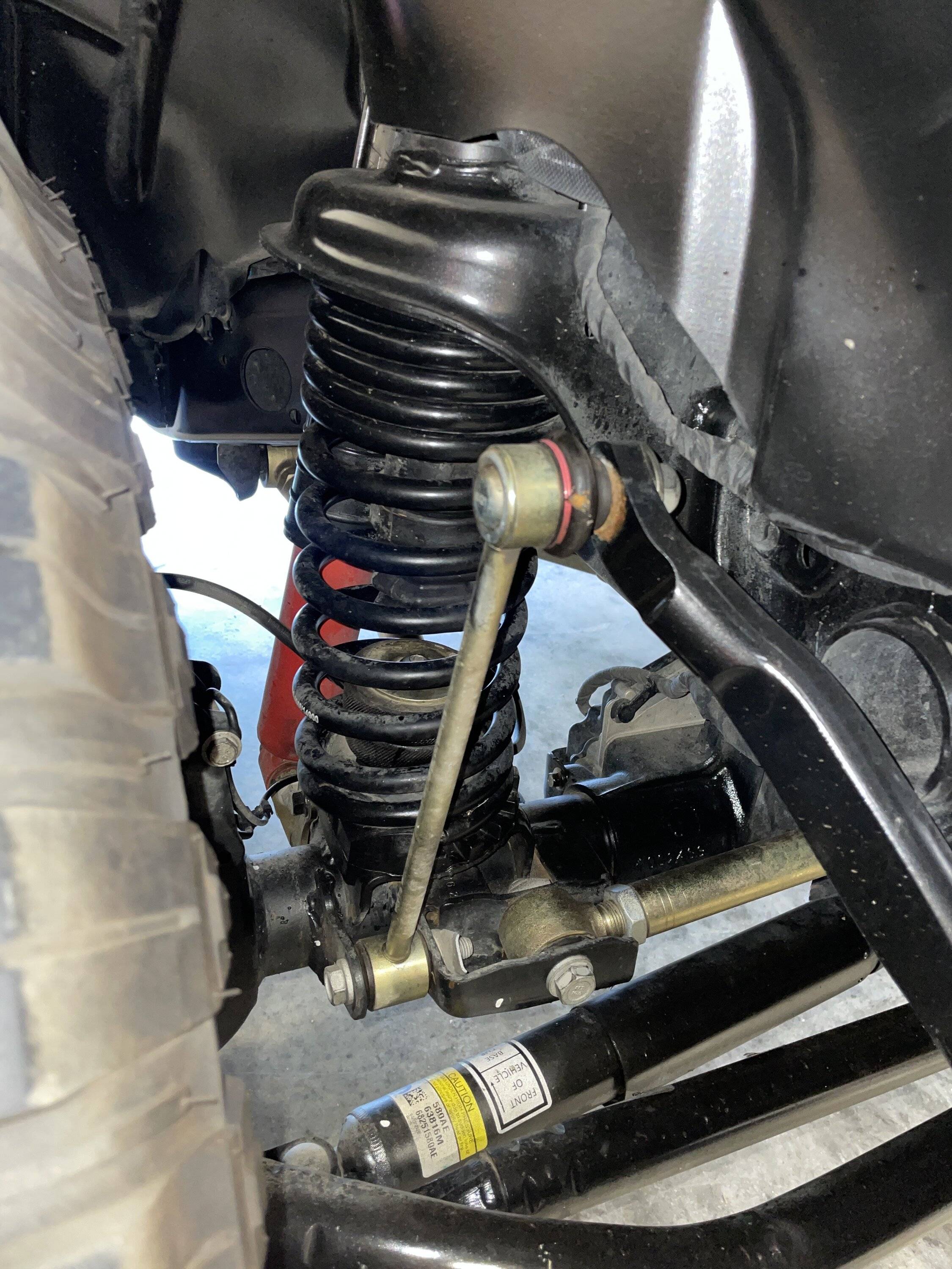

Hi Roky, i don’t have any history on our “new to us” 2020 JLR, so I followed your suggestion, and measured 13.25 inches. That would suggest a 2 inch lift? Thanks!

That photo I posted is based on a 4 door Rubi….. I’m not sure of the factory measurement on a 2 door…. If you could find one to measure, or find someone to get the measurement for you then you’d know for sure, but looking at your photos, I’d say you got 2-2.5” of lift…. Looks like a MC lift, so that’s a bit confusing because MC notoriously lifts a bit higher than advertised…….

To take the tire size out of the equation you have to measure only the the suspension components as per the diagram.
There will be variations of course, like those with max tow, the rear is higher which affects the rake. Some Saharas (but not all) seem to have more rake and a bit lighter spring in front for a smoother ride.
