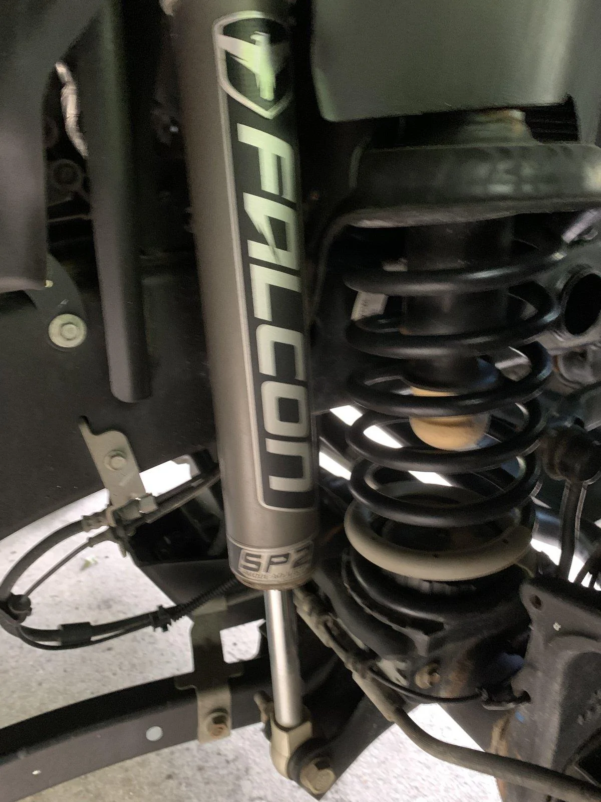

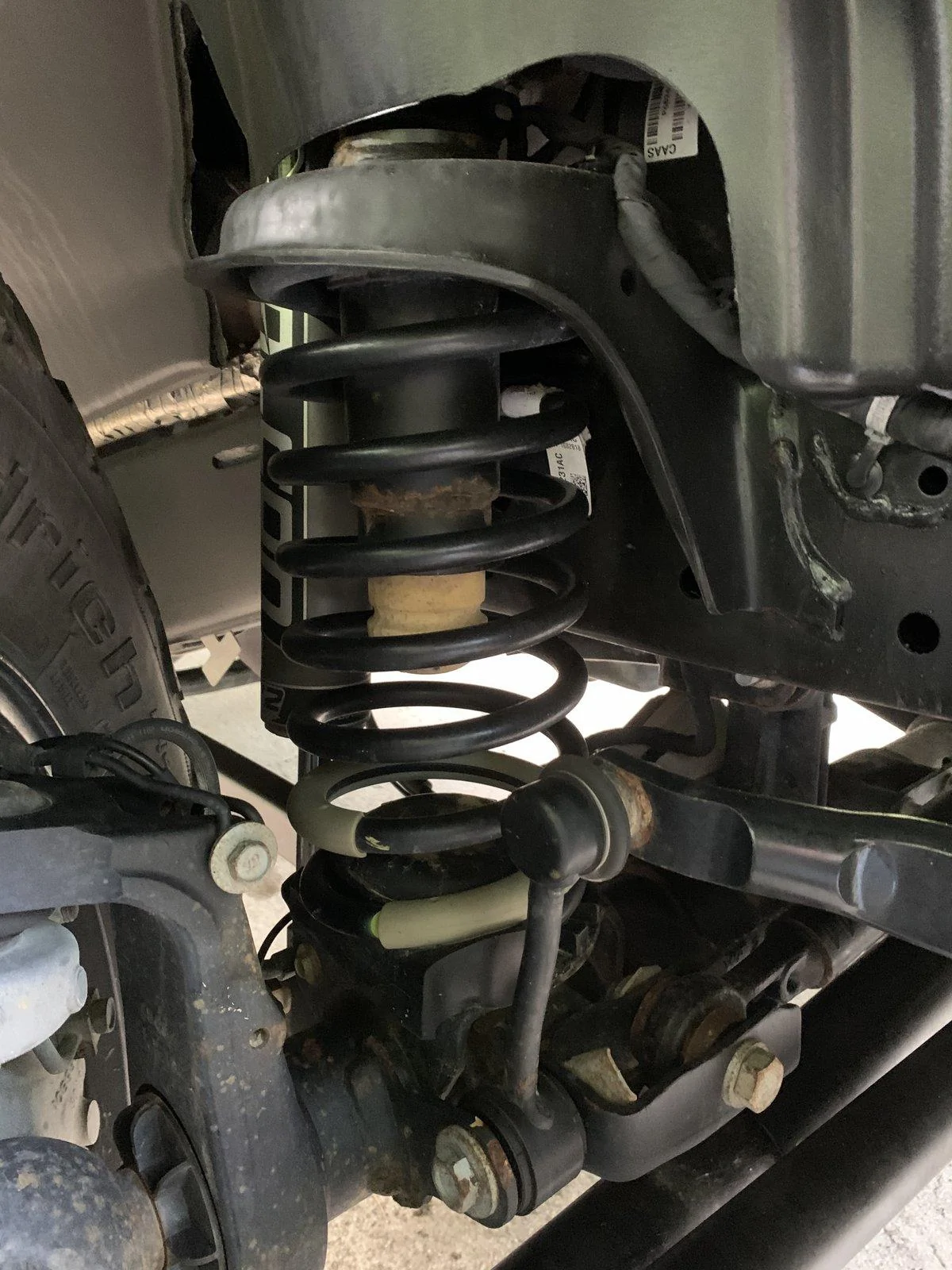

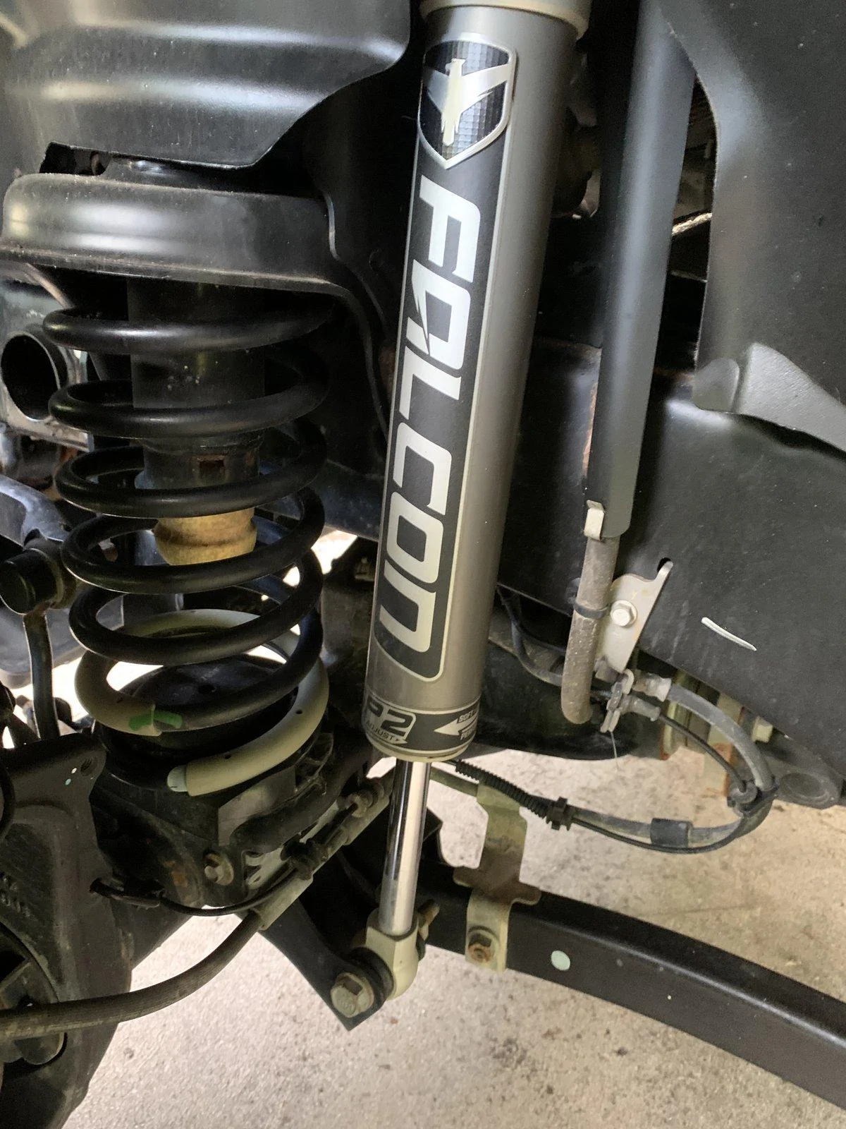

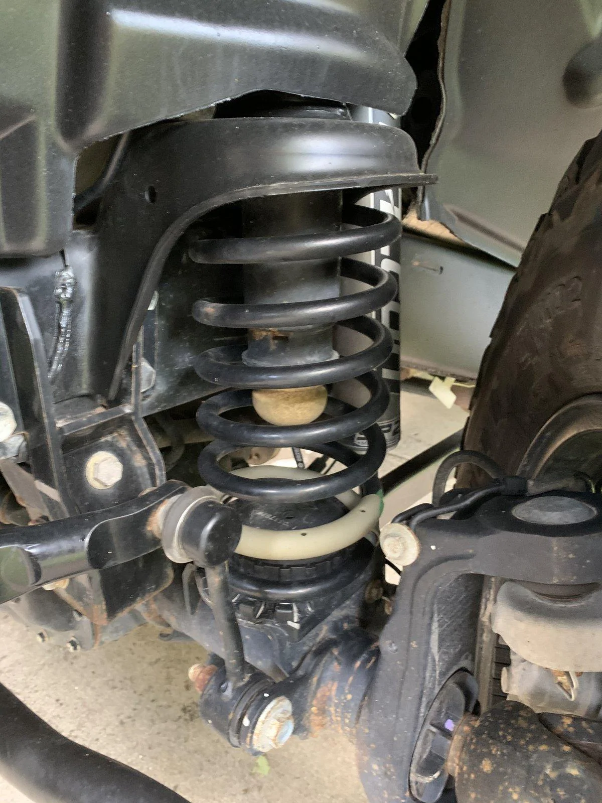

I'm trying to determine if there is any sort of lift on my '18 Rubicon. What would be the easiest way to figure out if there is a lift, or if someone just swapped the shocks? Would sway bar links be a good place to start? Does anyone know the length of the stock links on a Rubicon?

check the spring numbers. there should be a tag on them. The mopar lift comes with fox shocks. Those links look mopar they look stock. But looking at springs should tell you.

I see 231AC. the 31AC I believe are 2 door stock rubi springs. so you dont have a lift. I have rubi springs. Mine is 32AC, from a fully optioned 2 door.

Something else you can look at just to see, the Falcon shocks should actually say right on them somewhere how many inches of lift they are intended to be used for!
