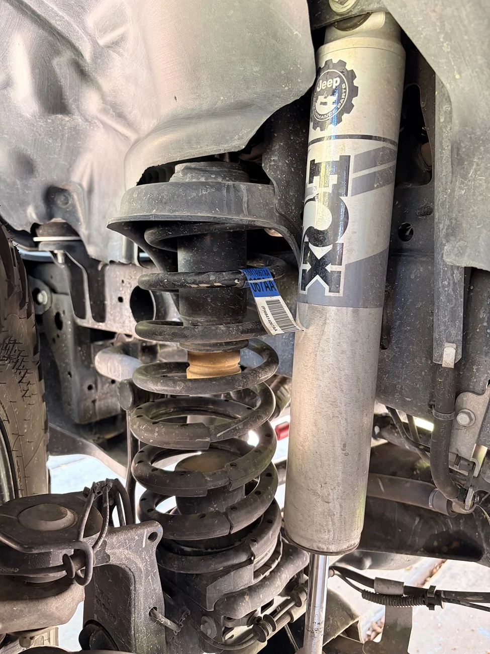

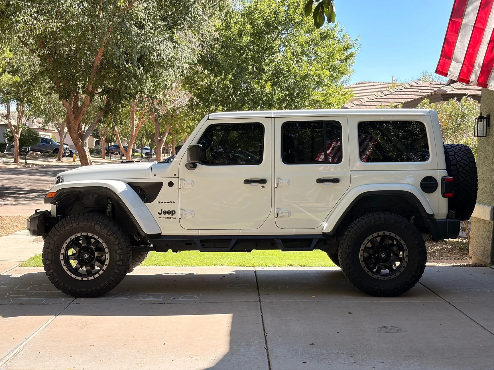

Hey guys, I just bought a 2019 Wrangler Sahara 2.0 and it already had this lift and 35” tires installed. Can someone help me identify which lift kit this is and possible the height? Thanks!

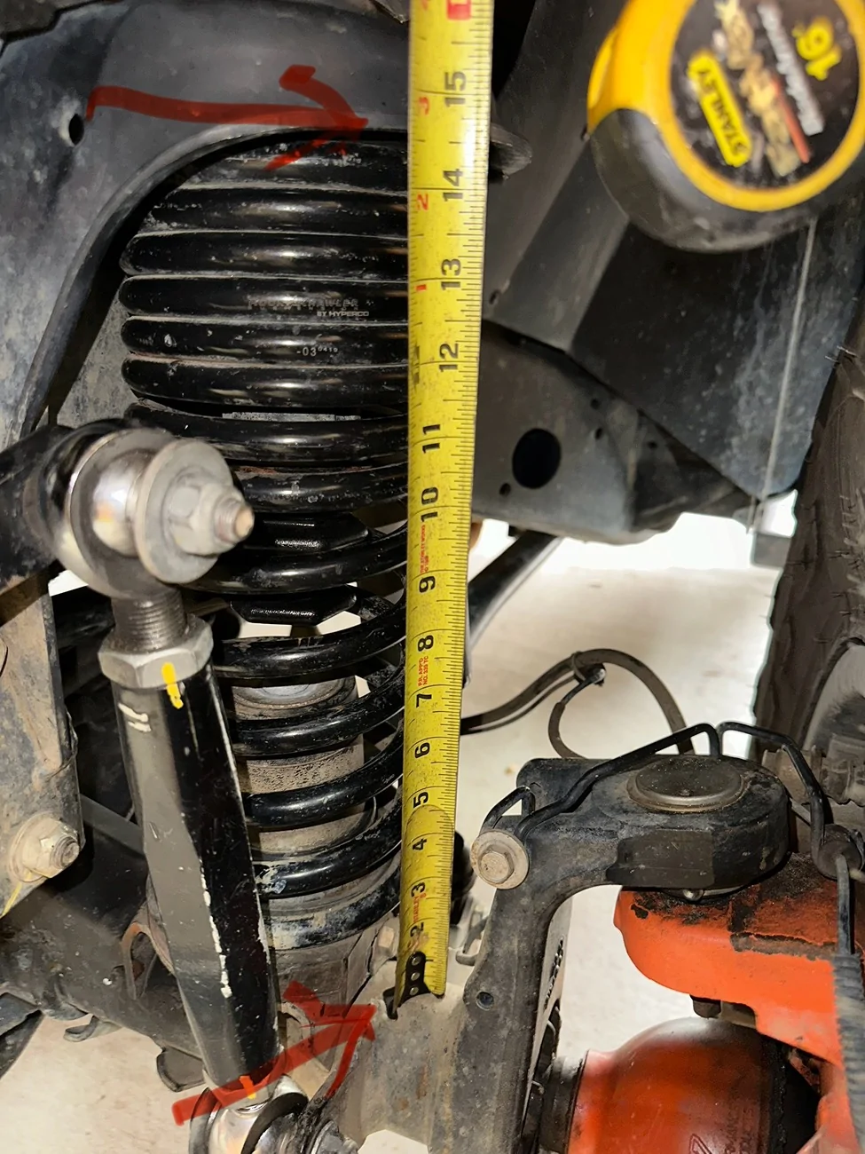

Looks like the Mopar lift, called a 2” lift but has been known to give over 3”. That’s based off of the Rubicon, you probably got a little more than that….. if you measure like in pic, I can tell you pretty close to how much you got….from top of axle tube to bottom lip of coil bucket…

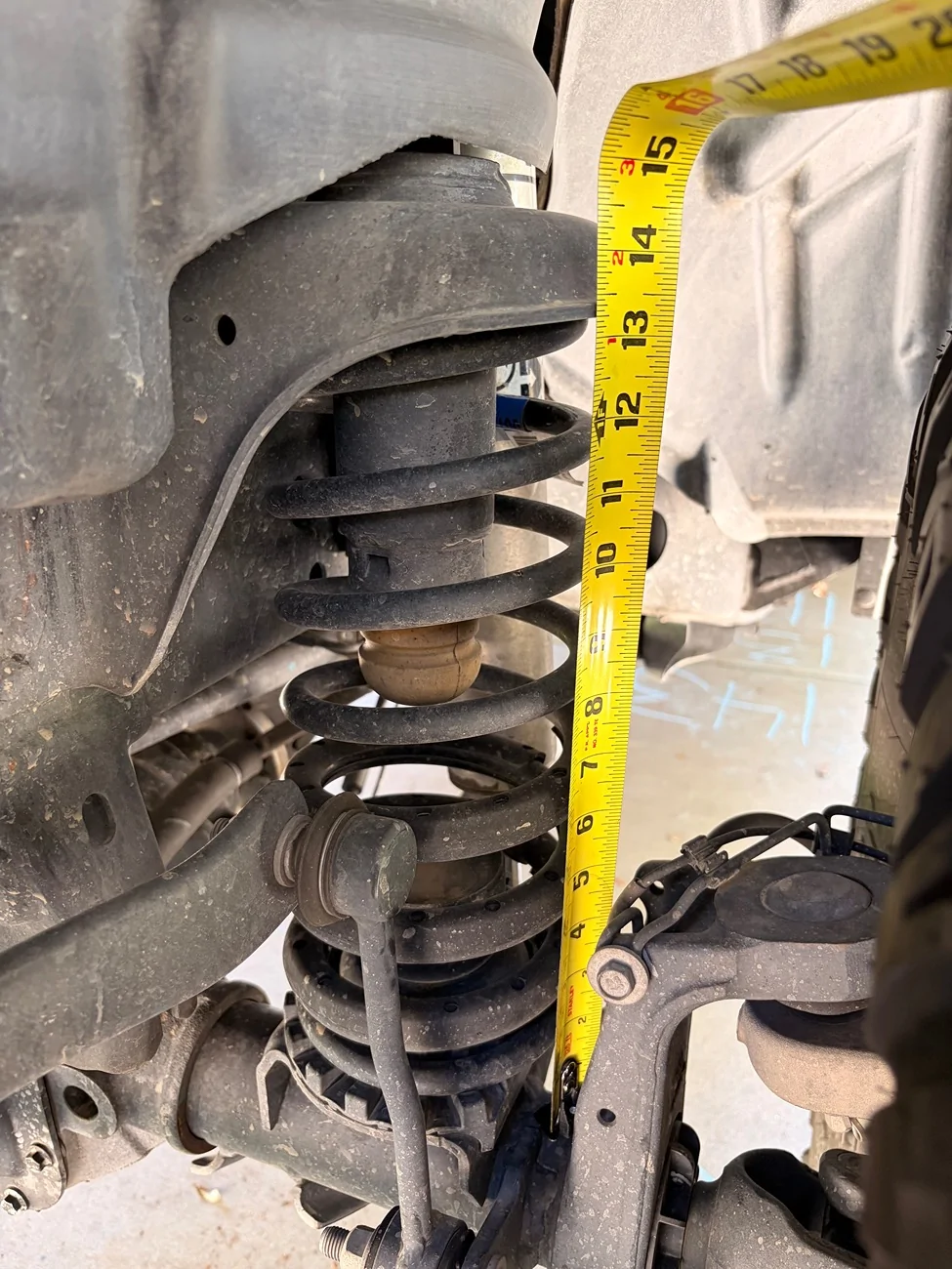

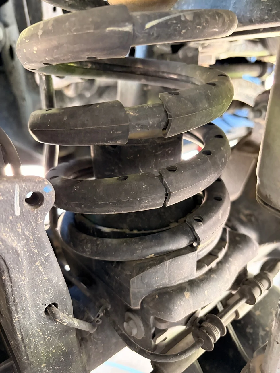

Thanks! Here is a pic of the front springs

Sure man , no worries….According to my measurements back then, (my 2018 Rubi was 11.25, and my buddies 2019 Sahara was 10.25) you got about 3” of lift… There’s another pic of that measurement floating around on here but I’m not sure what it’s based on…might be some kinda average or something…. Whatever it is I don’t go by it…of course this is just an estimate, each jeep, although they’re supposed to be cookie cutters, they’re all a little different….✌

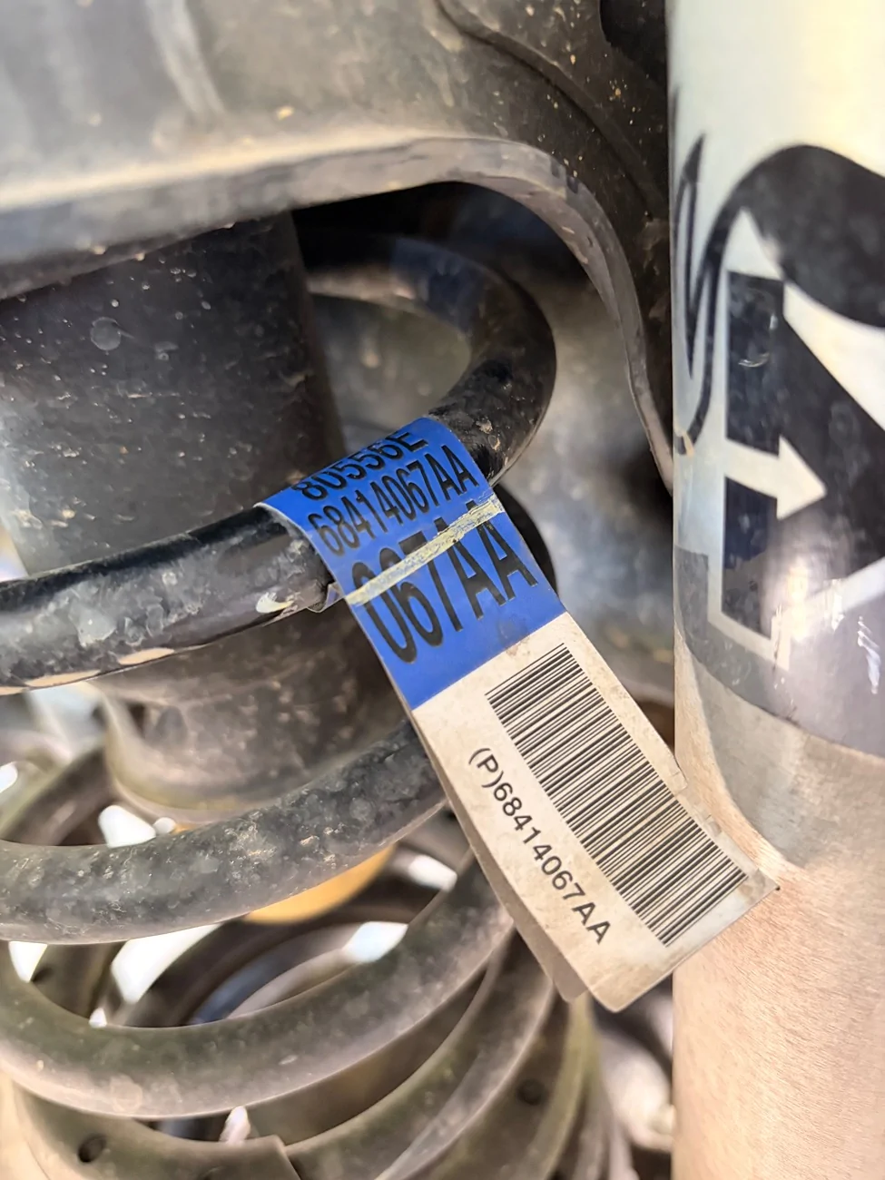

Those shocks give it away, and the tag on the spring just ensures accuracy. Definitely the Mopar kit with the Fox shocks. It's rated as a 2" kit, but is notorious for lifting more than that. Looks like you have the higher Rubicon fenders as well if I'm not mistaken.
Thanks! Yes I thought they were higher than the normal fenders. Previous owner must have replaced them.
