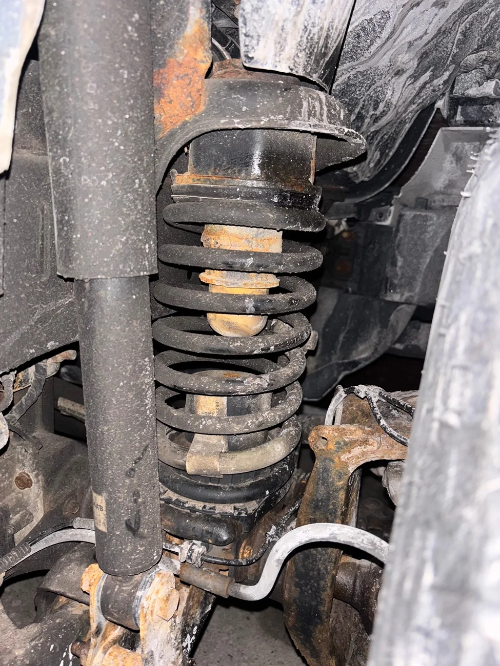

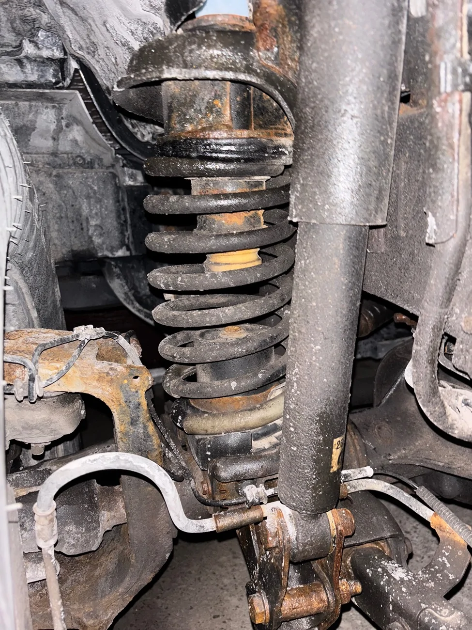

What’s this kit? And how much lift is giving? My jeep has 255/70r17 “looks silly” and it is still quite high lol. I see tall vehicles under me 😅

Looks like a really poor quality spacer lift with shock extensions. Just pull those out and you'll be fine.

like shagles said ditch the junk puck and you will get a much better ride. You also have shock extensions on the oem shocks.. I'd suggest looking locally and finding some oem takeoffs that are rust free personally or a pair of stock height bilstein 5100's to firm up the body roll.

As said before it’s a cheap spacer lift. Looks to be around 2-3”, easy to remove with just jack stands.

If you're going to go to the work of removing the spacer stuff, then you might as well put new shocks on while you're there.

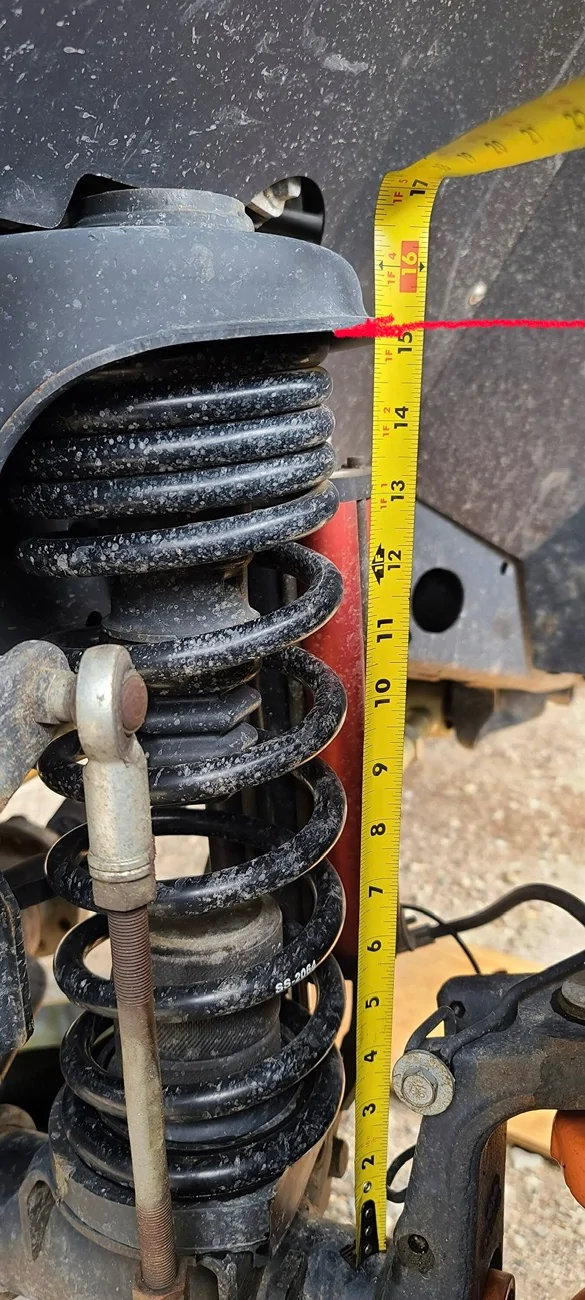

For a real answer, post a pic showing an accurate measurement
