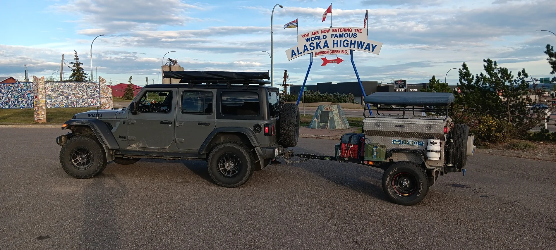

Shocks are so subjective. One person's too soft is another person's too stiff.
I replaced my factory XR shocks for Fox 2.0 IFP shocks (for 2 to 3" lift), then took the Jeep up to Alaska and Canada. Lots of bad roads up there. Was pleased with their performance.
Jeep Wrangler JL Mid-level shocks 20250817_191659
