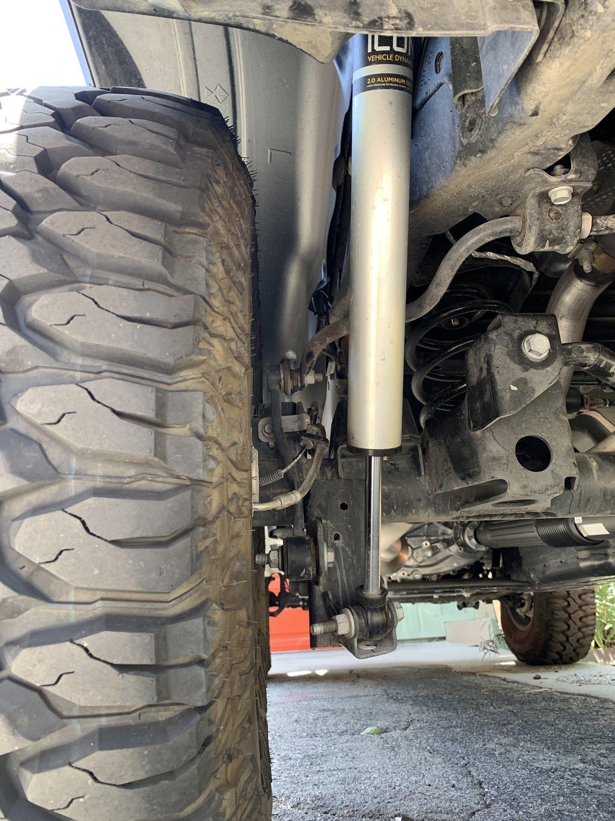

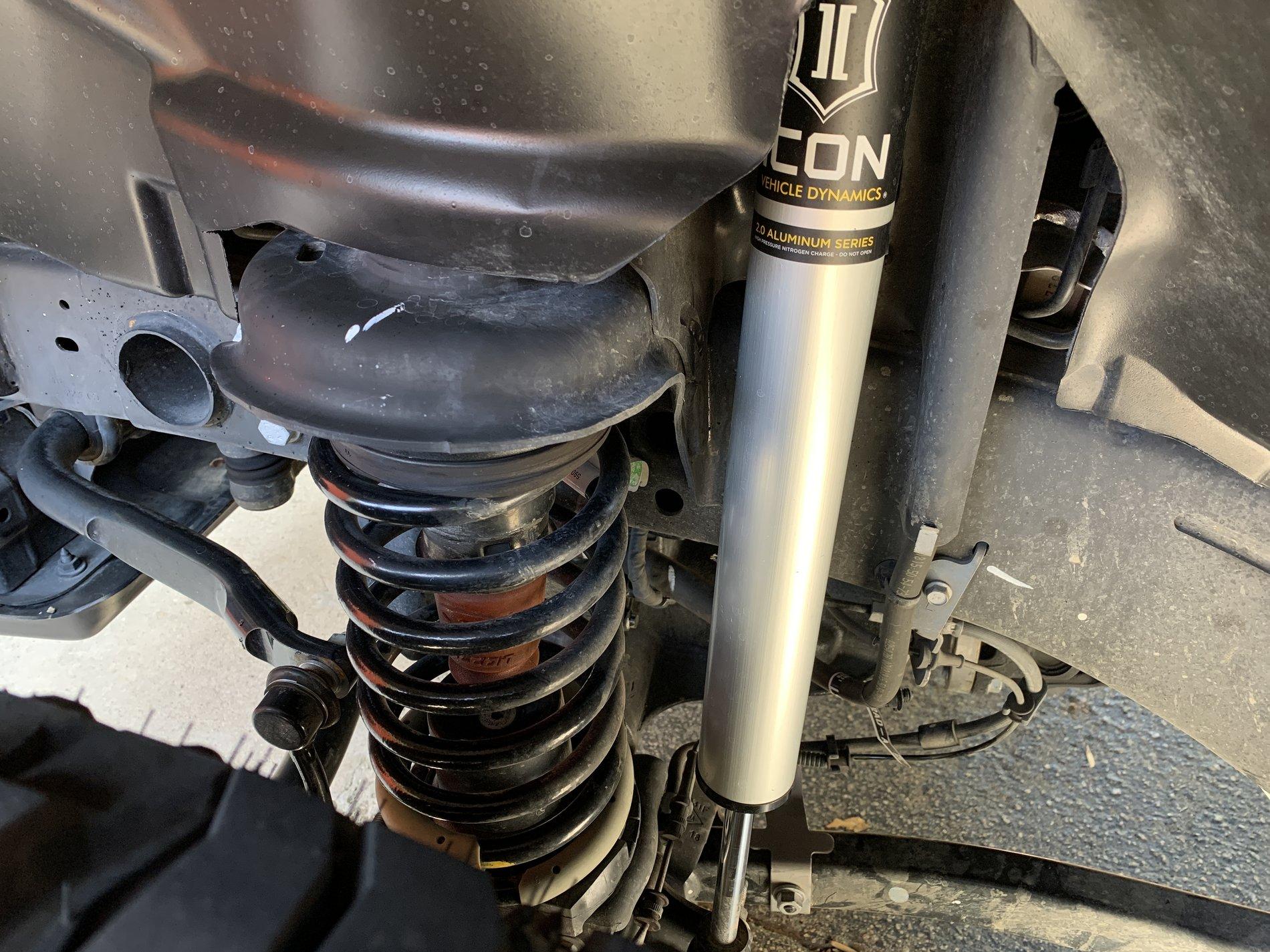

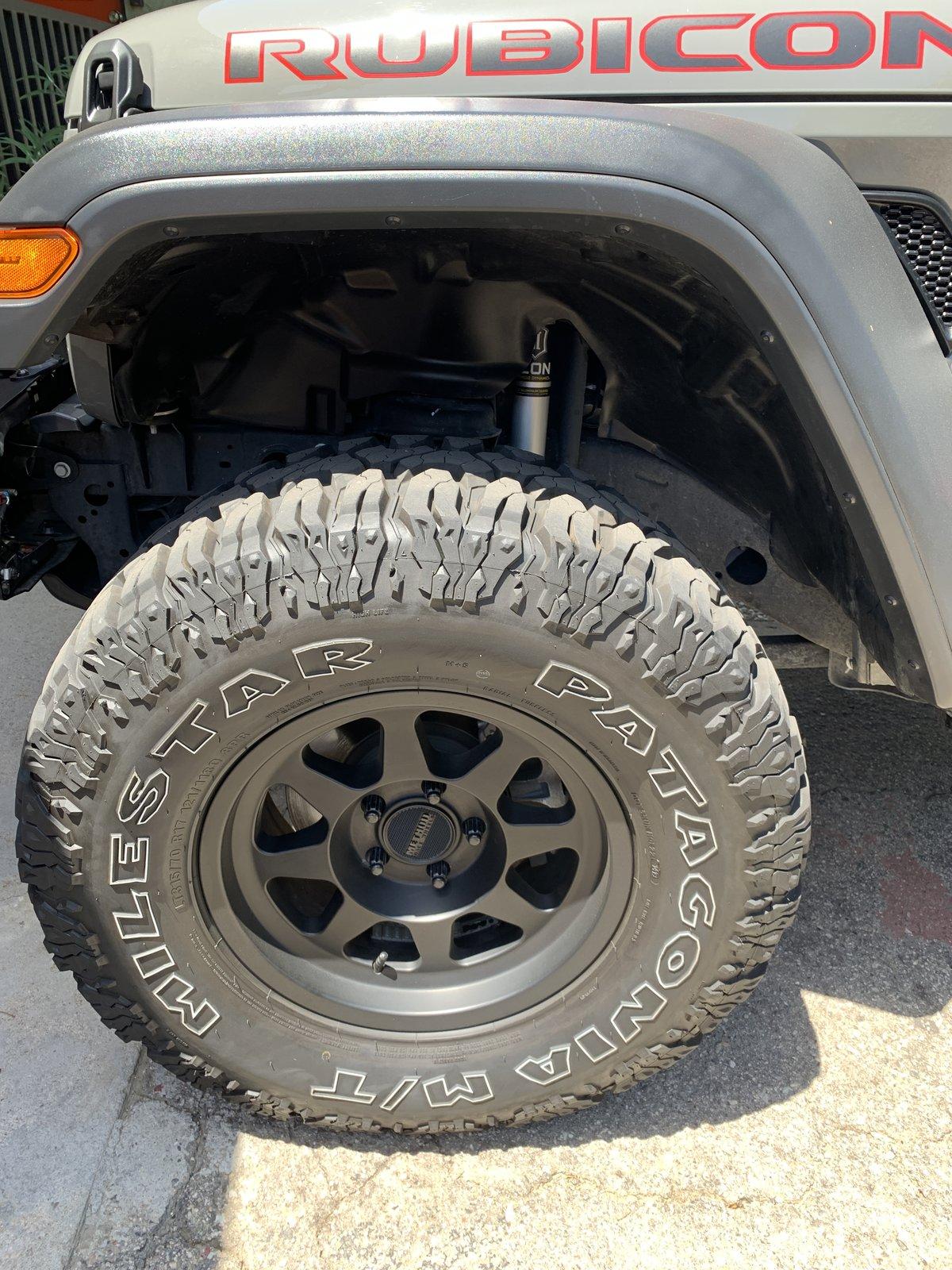

@Cthehentz - My Rubicon is on 35's with the Teraflex ST1 spacer kit with bump stops and I paired it with the Icon Vehicle Dynamics 2.0 JL shocks.
Not a lot of reviews on these in the JL community, but the shop owner where I had the work done recommend these over Falcon SP2.1. Aside from the OEM steel bumpers, I run light on the trails (no winch, rack, or crazy overlanding gear) and these were a good fit without dropping the extra coin on adjustable shocks.
2k miles later and am pretty happy with them. On road handling is improved (comfortable, but not too stiff), but the biggest improvement has been felt on the trails: straight cruising on the bumpy dirt roads and great control/response on the slower technical stuff.
Good luck on your search!

Thanks for the advice and great pictures. I have located most of this kit minus one shock, it seems every website I find has half kits in stock that are of good/decent quality.
