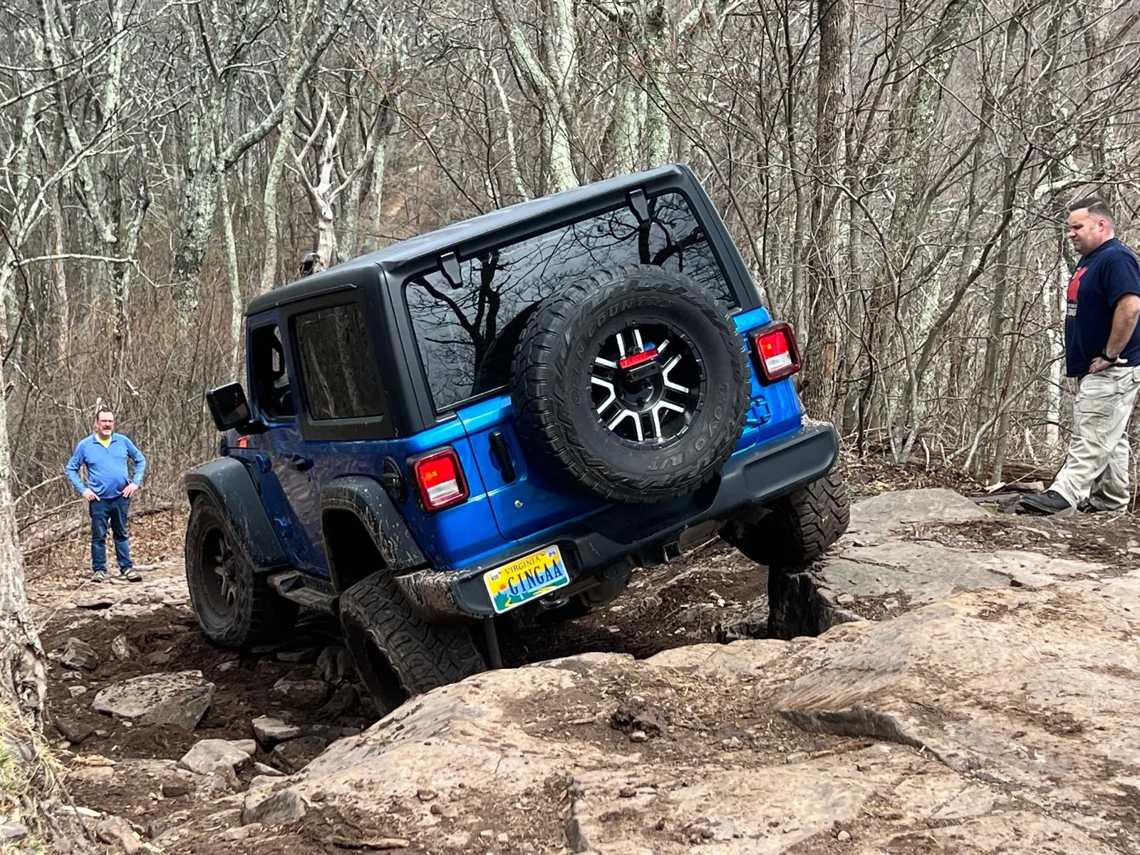

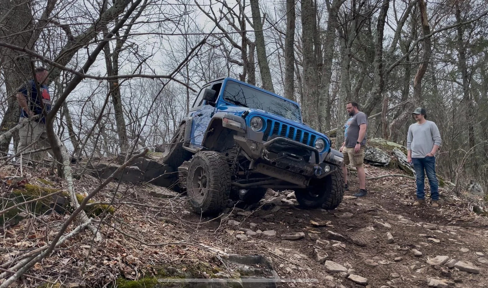

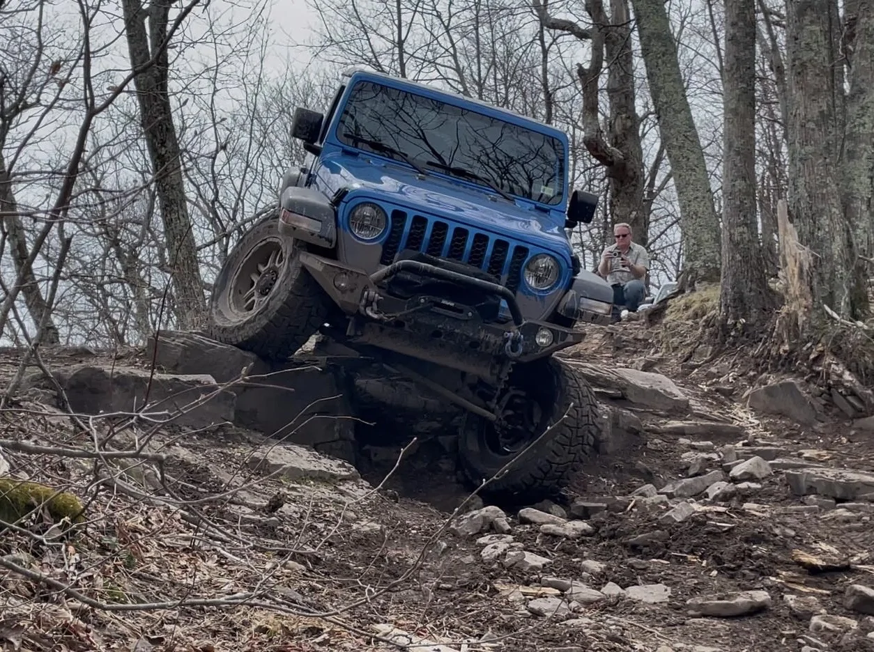

Need some new shocks for the Jeep. 2dr currently have a 3in lift. This is a weekend vehicle and we go wheeling about 1 every other month on average. I also plan to sell the Jeep in ~3 years so don’t want anything too expensive. I’m looking to keep it at $600-700 for all 4 shocks. Maybe $800 if it’s considerably better.
My favorite at the moment is Rancho 9000xl. I love the adjustability of it. I’ve heard Fox, Bilstein and Falcons are all too stiff. I’m looking for more comfort but capable when we go off road. Let me know if I’m wrong about those 3 or any other suggestions welcome. Thanks.

Nice pictures. Looks like a fun trail, and the mud level just below the headlights looks interesting as well.
