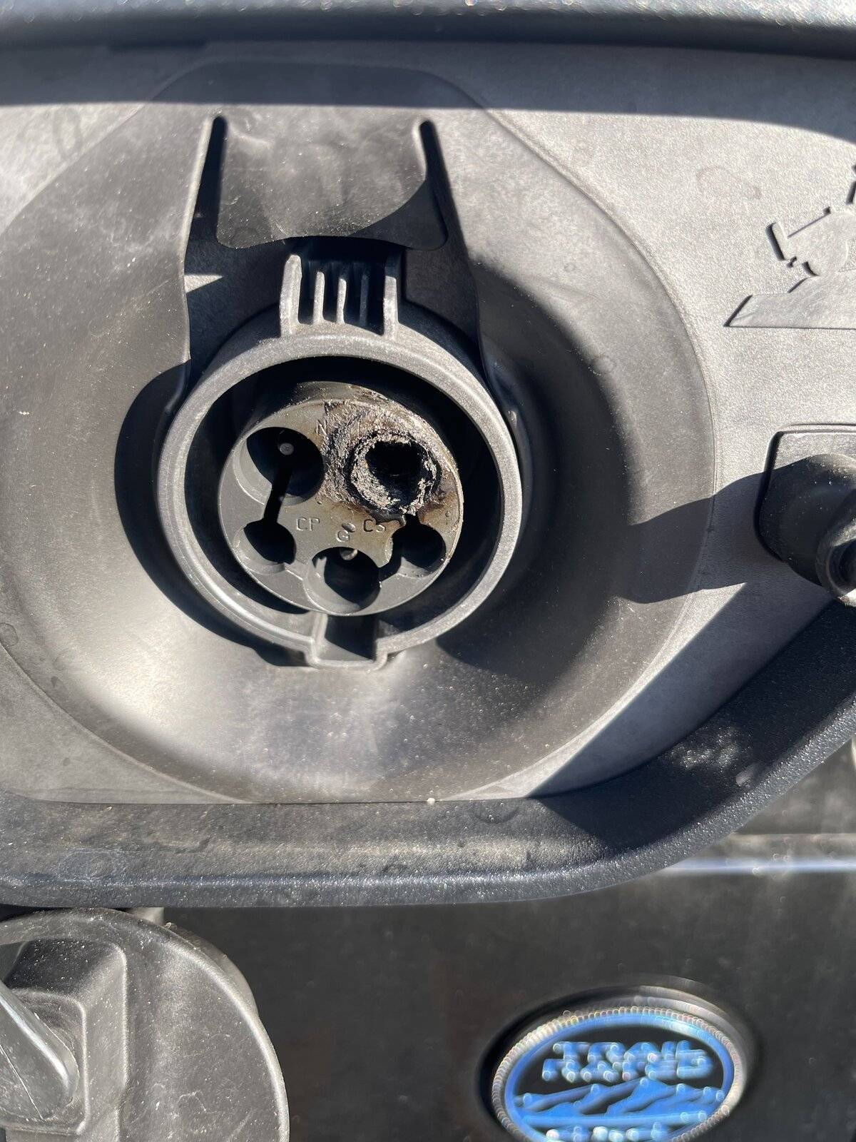

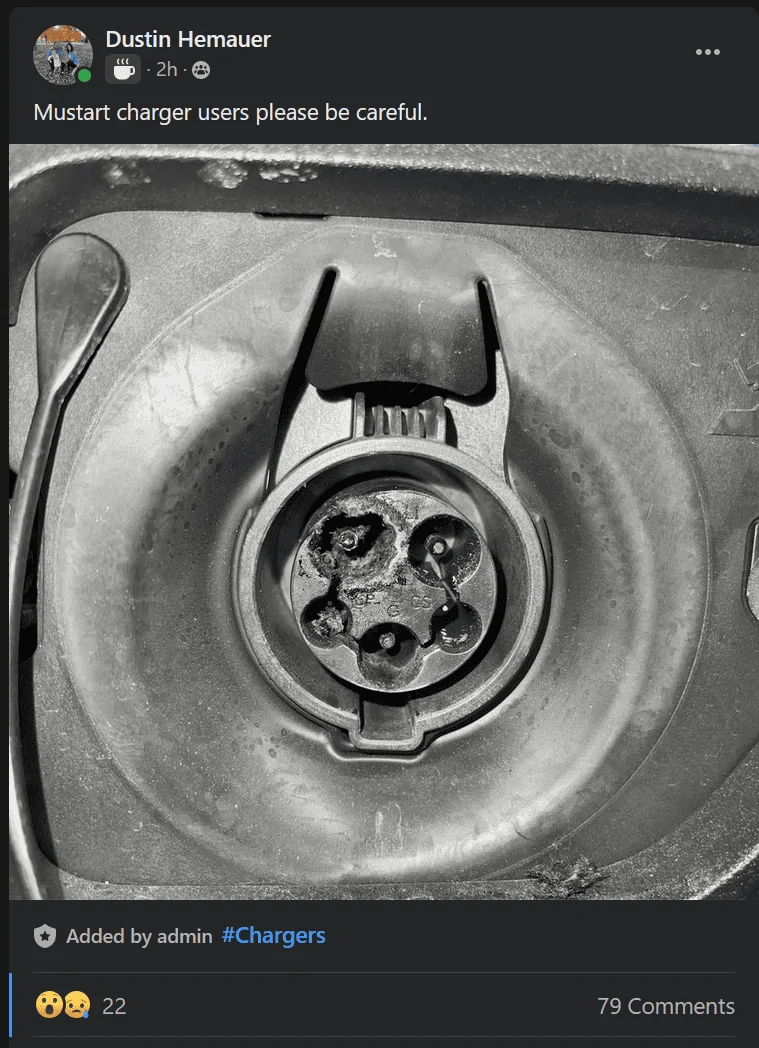

I woke up this morning to the charging port and charger on my 4xe melted together. This ever happen to anyone else?
Need more details such as what charger were you using? Pics of charger?

Wanted to bump this back up after a discussion in one of the facebook groups and coming across this thread.

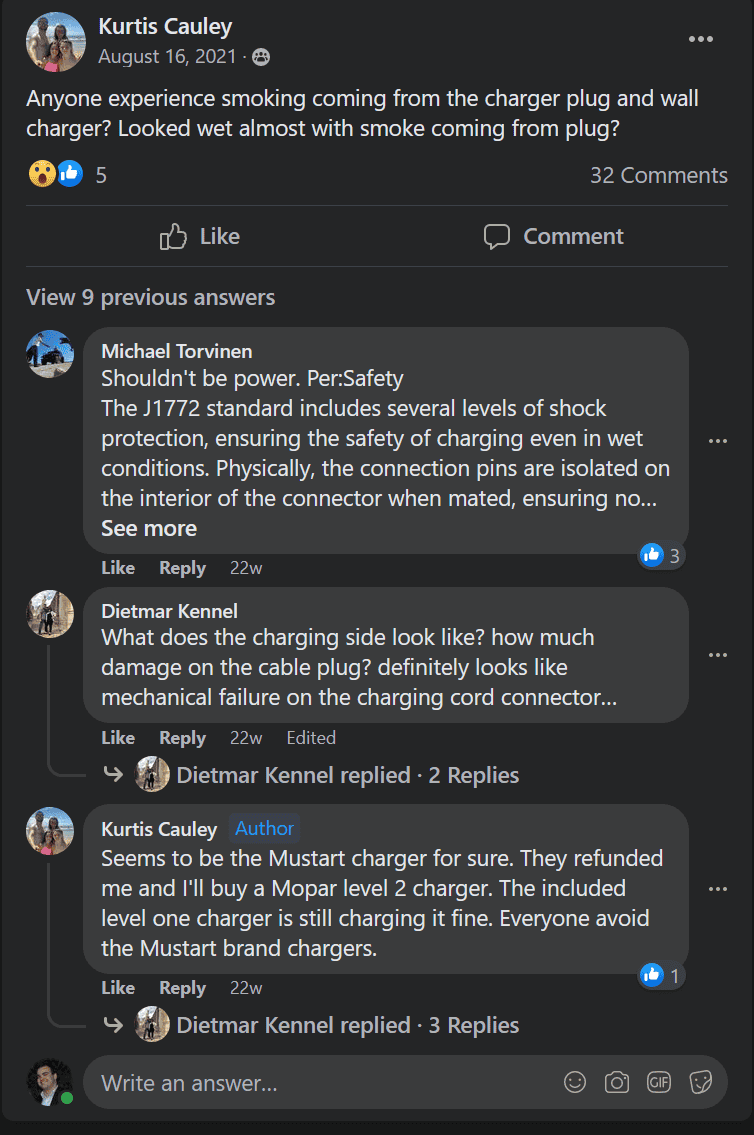

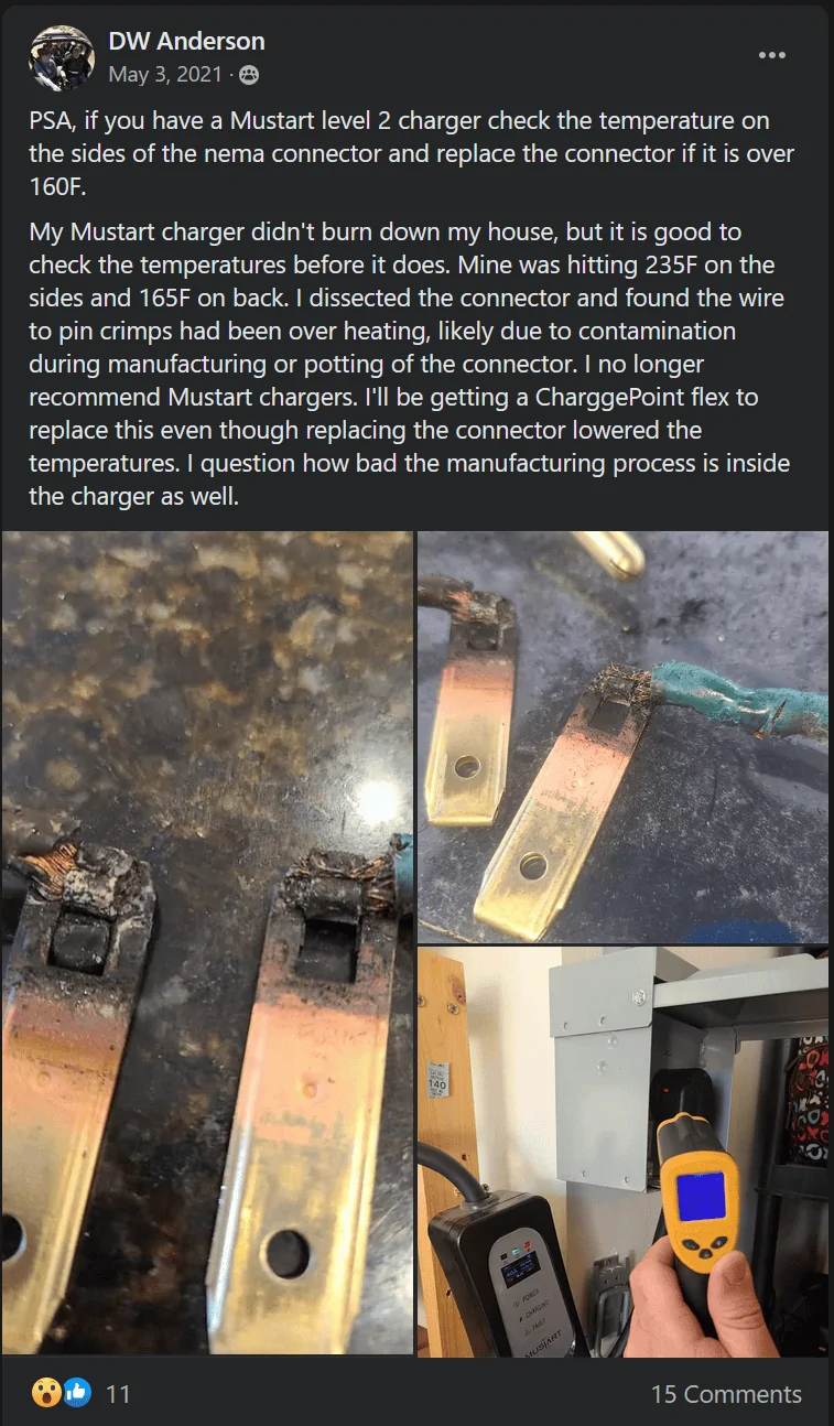

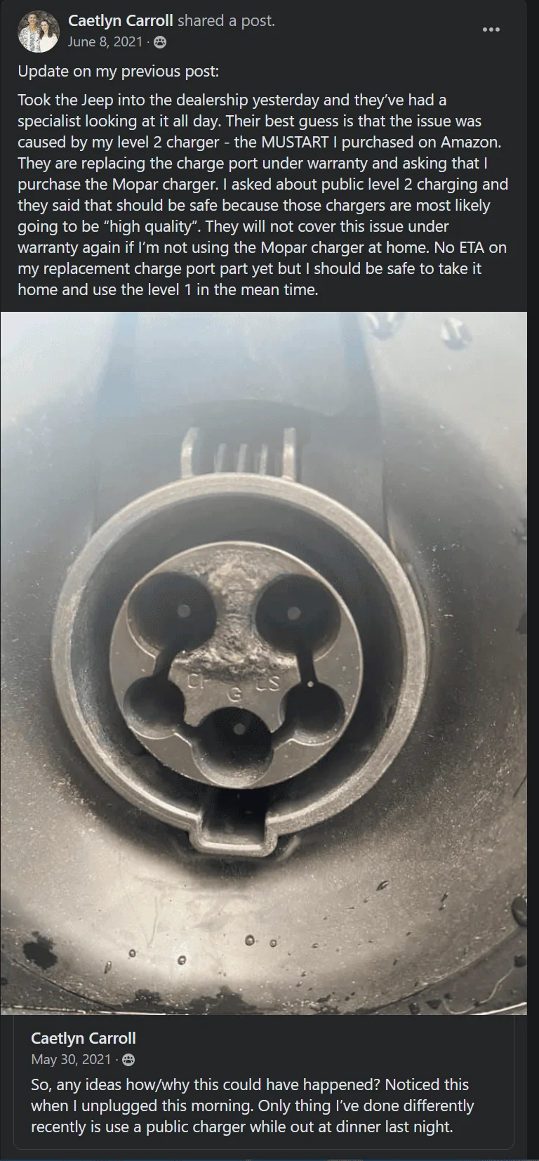

Most/all of these melting charging port issues seem to be the result of using the Mustart brand EVSE off of Amazon. This is a problem that is not unique to the 4xe. Has happened to lots of other brand vehicles as well.

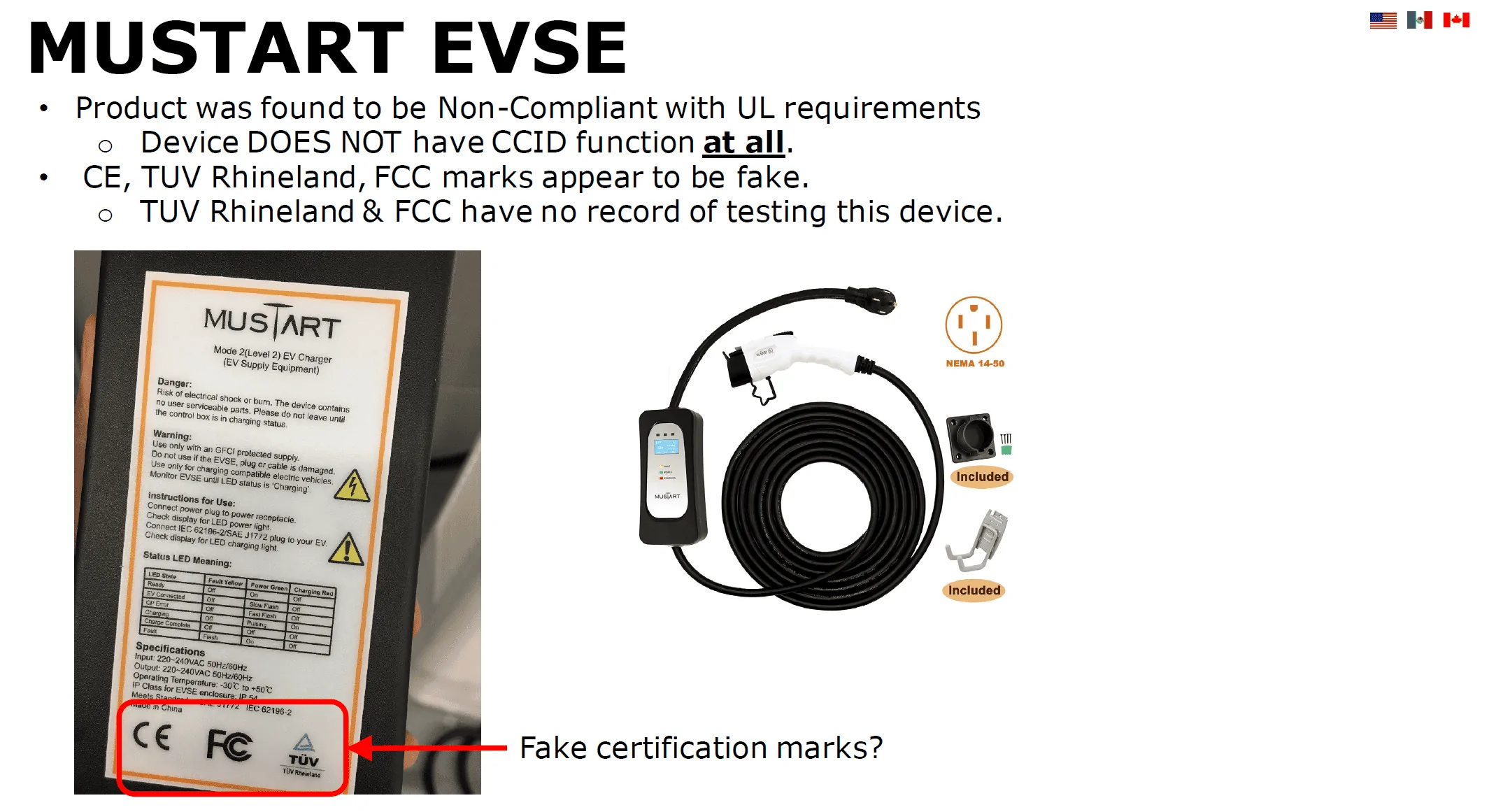

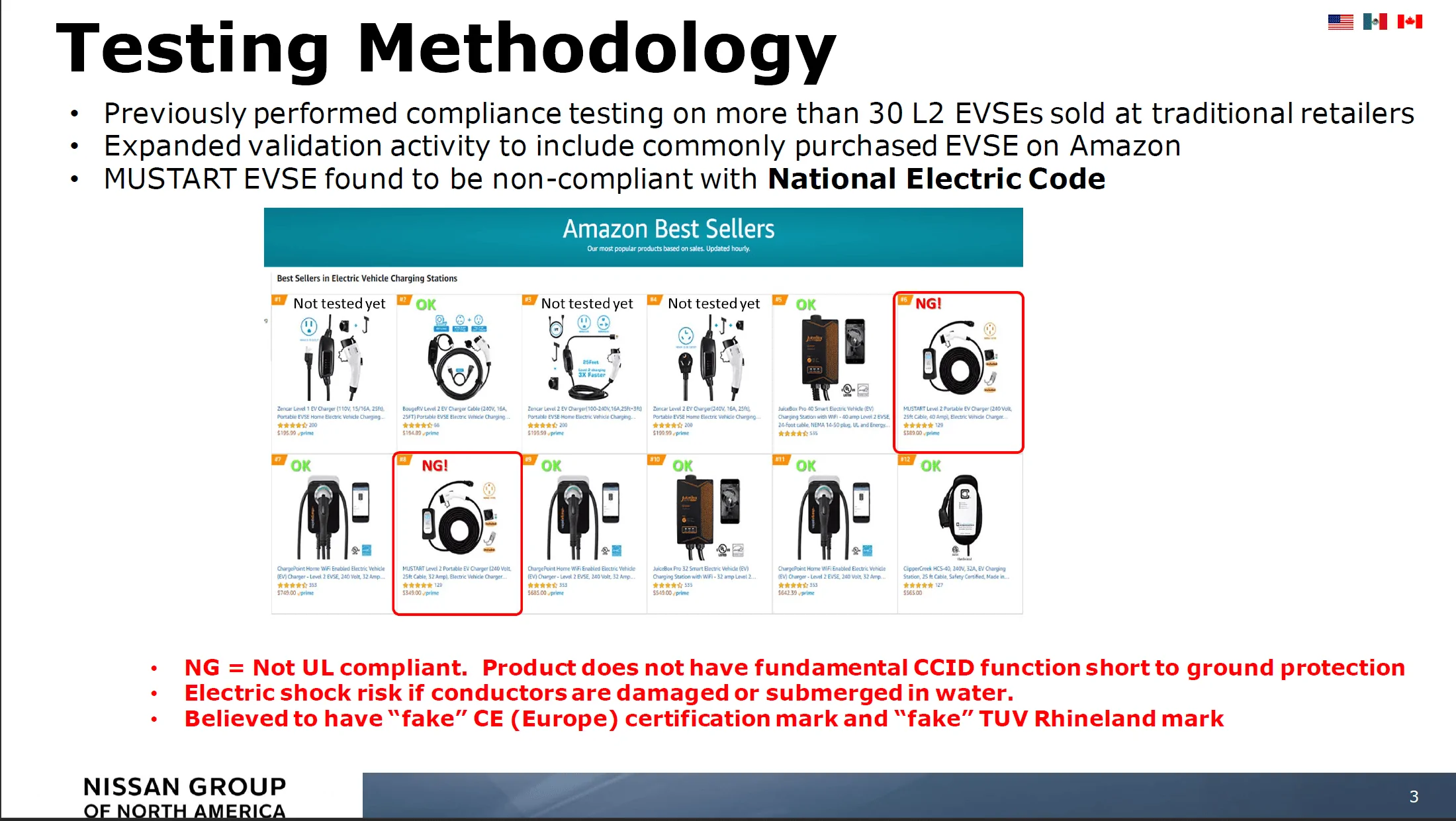

Nissan Motors ended up doing a study on off-brand EVSEs and found that the Mustart brand EVSEs are lacking the CCID protection circuitry they claim to have and appear to have faked all of their certification tests.
https://assets.ctfassets.net/ucu418...h_2019_EPRI_IWC_-_EVSE_Safety_Analysis-ET.pdf
We have used a Mustart level 2 charger on our Pacifica hybrid for the past 3 years without issue. I will need to do some reading. Thank you for the heads up!
There are quite a few people that have posted in the various 4xe groups about melted charge ports, charging system failure, etc and they all seem to be using mustart evses. There are also a lot of people that use them without issue. Probably one of those cases where as long as everything works exactly as it should, there's no problem, but as soon as a fault happens and the ccid circuitry should step in, it doesn't and you get catastrophic failure instead
