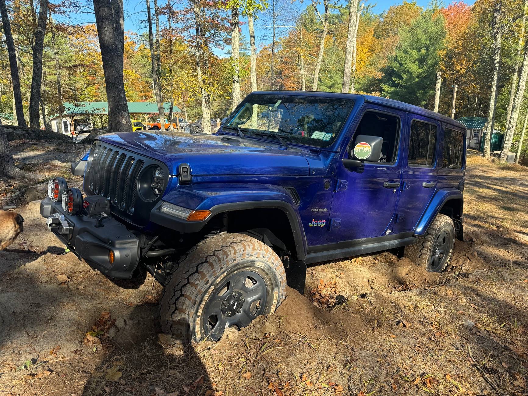

Jeep Wrangler JL LSD or No LSD? 20240826_191226

I can for once offer some first-hand experience (feel free to draw your own conclusions, of course):
  • Installed f/r truetracs and regeared my Sahara about a year ago (maybe two?)
  • Couple weekends back I attended an offroad bootcamp class and there was a non-LSD stock sport. They took advantage of the different vehicles (4Runner, Bronco with rear locker, Rubi, non-LSD stock JL sport and my JLU with the true-tracs) to show us how differently each system behave in a sand pit.
  • As expected, my Sahara with the truetracs was the only one that made it out of slippery situations without engaging anything extra (there was nothing to engage, either!).
  • All made it through all obstacles, but the BLD in the non-LSD Jeep definitely wasn’t up to the task on the first trt and required picking a different line, for example.
I say he's got the wrong tire. An all terrain in that mess. My Rubicon with lockers off and BLD will get through it. Though I run Falken M/Ts as a daily driver.
that is a good point - the stock JL had BFG Ultra Terrain’s which are very mild AT tire if memory serves.
