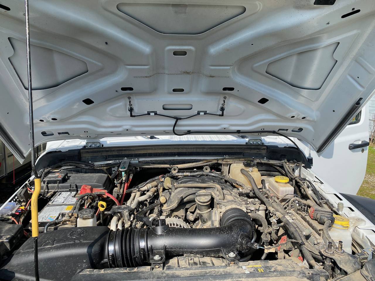

Vent the motor compartment better.

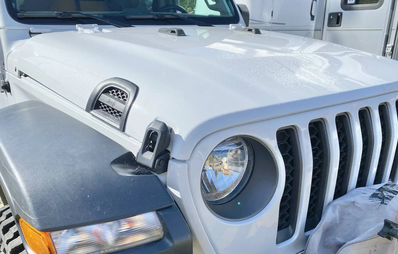

lst let more air in by Installing the larger JT grill mesh
Jeep Wrangler JL Loud Fans???? JL Hoodw CAI and raised hood venting

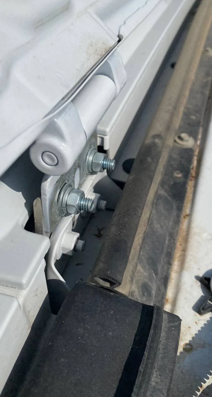

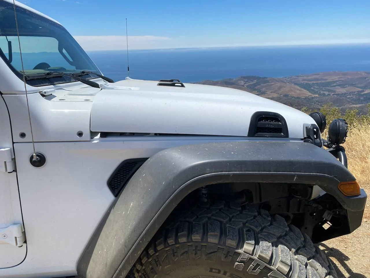

2nd let more pass out easily by pulling the under hood sound liner, the horseshoe shaped engine cover and raise the back edge of the hood by extending the hood hinges.
Jeep Wrangler JL Loud Fans???? JL underhood
Jeep Wrangler JL Loud Fans???? hood hinge extension a (1)
Jeep Wrangler JL Loud Fans???? JL hood with hinge extensions
These changes will not stop the fan from running loudly but it has helped mine from running as much. And in my case, were an easy, inexpensive DIY project.

Sorry, but that hood mod makes it look like you've been in an accident.

Forum follows function, IMHO it looks...COOL. Your factory fake simulated Rubicon hood vents look... fake. I only point this out because you called me out for functioning feature. Like a blower intake popping out of the hood, it is what it is... No worries, Cheers
