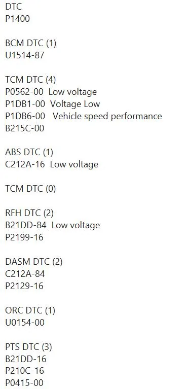

It was there for a month So that could be the case, thank you
Especially true if you have accessories (like in my case, electric steps). I was gone for two weeks and the 1st time I drove the Jeep all of the codes below appeared. After driving it a few days to get the battery fully charged up again, they all went back to normal.

Without the DTC’s from the ABS and TCM, anything else is purely speculation. You might as well be asking a magic 8 ball.
