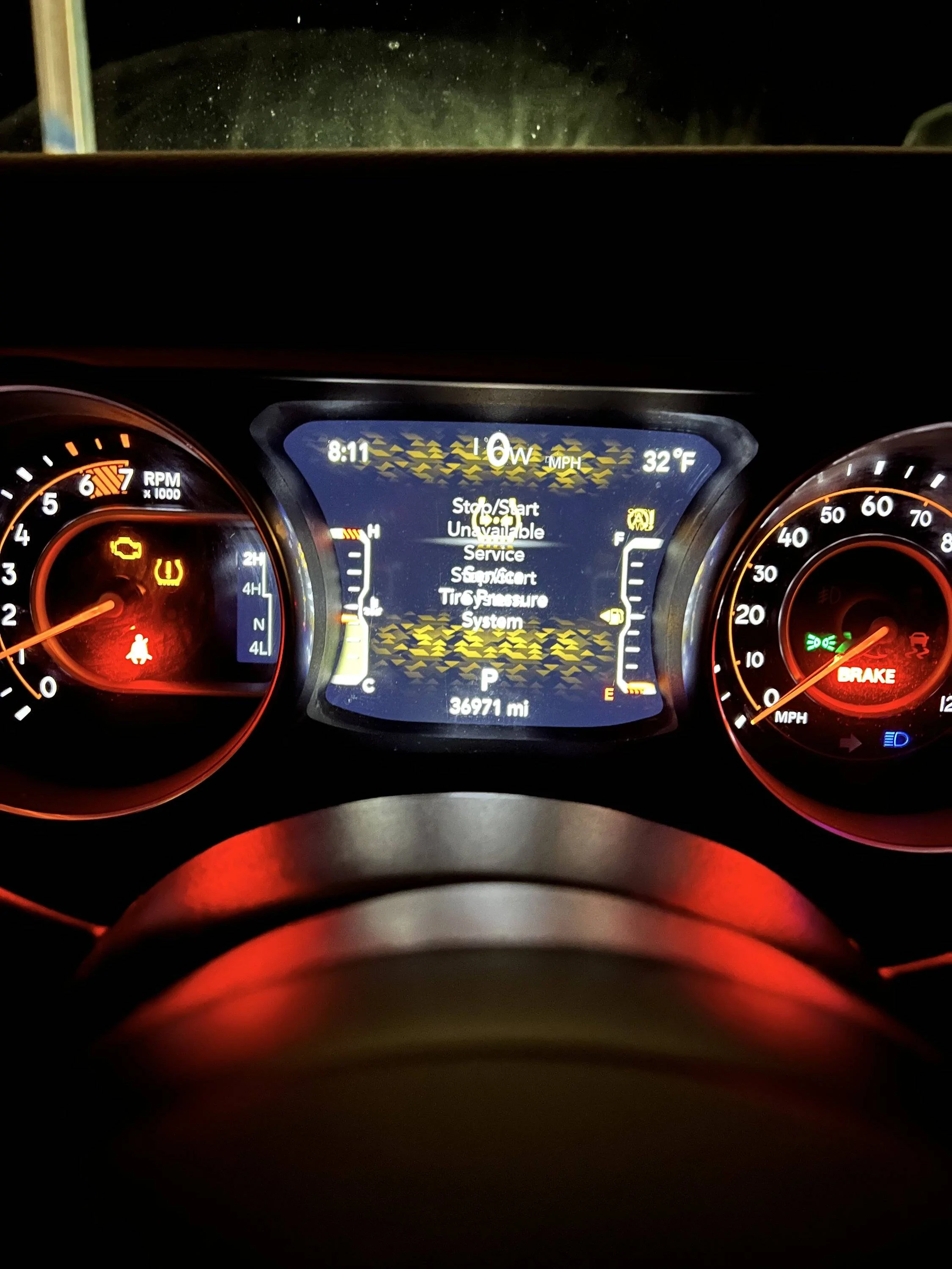

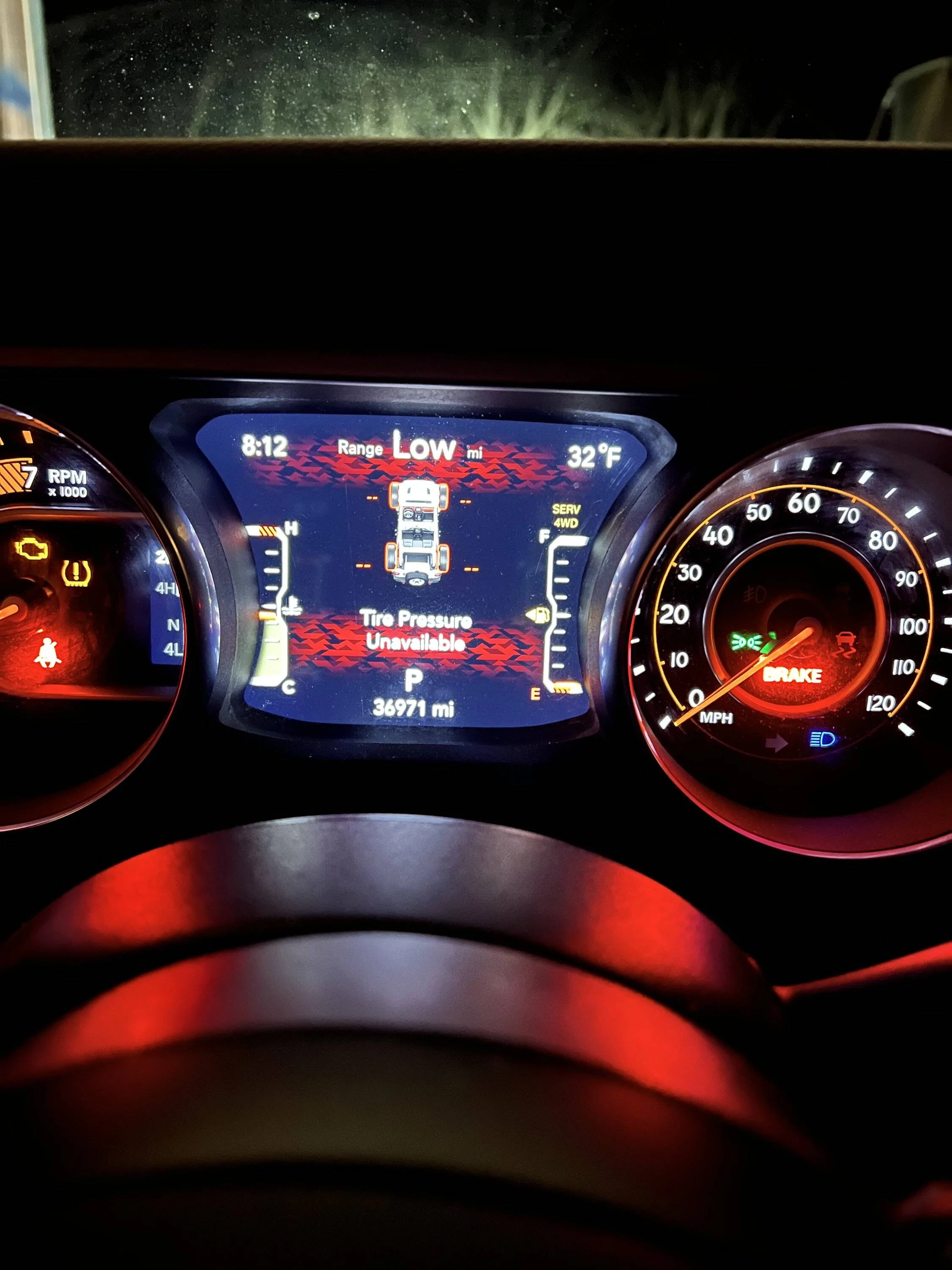

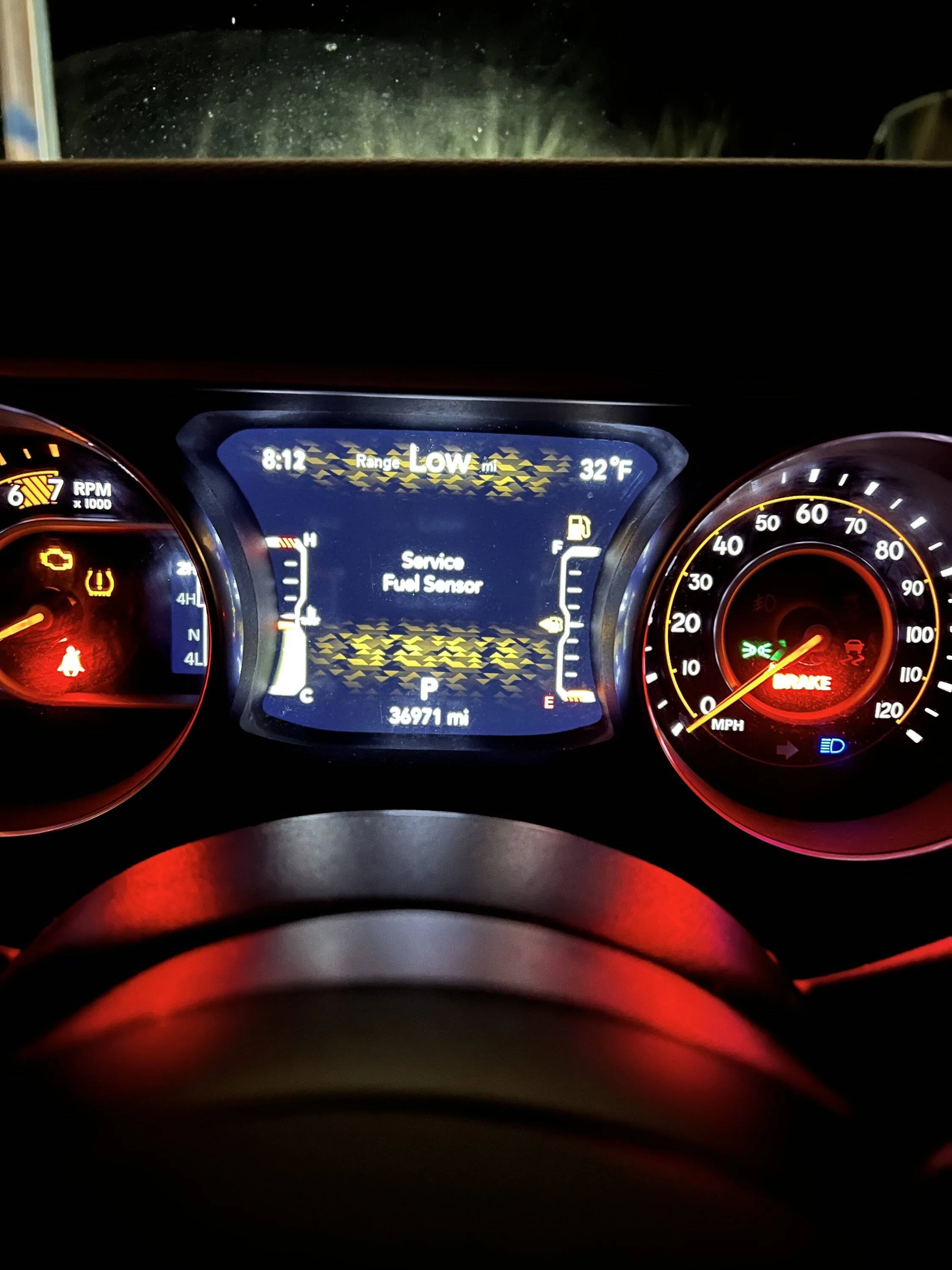

Hoping someone can help me before I have to take to the dealer. Wife started our 21 JLU last week and dash reads “fuel sensor unavailable”, “TPMS unavailable”, “service 4WD”, “start/stop unavailable”, and the “check engine”. Jeep starts and runs fine. Thinking it would have to be a module or bus for all these system to stop communicating at once. Anyone have any ideas???
Edit: was able to pull code P0463 with an obd2- Fuel Level Sensor “A” Circuit High.

Nothing yet still showing the same. Hoping someone on here can help me get to the bottom of it.

Aux batt was my first thought. Voltage is good on it. Check all fuses for connection and made sure all relays are making. Thanking maybe a CAN buss issue, but not sure if any of them would affect communications of all these systems

No, the only thing I had done was hook up some lights to the factory aux switch about a month ago.
