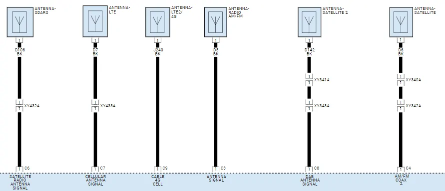

Does the preview channel work? That should prove out the antenna.
GATORB8
May 30, 2021
8,896
11,833
CLT NC
21 JLURe, 06 LJ, 25 HDZR2
At least in the wrangler. No seperate fuse, looks like the Sirius antenna is one of six!
