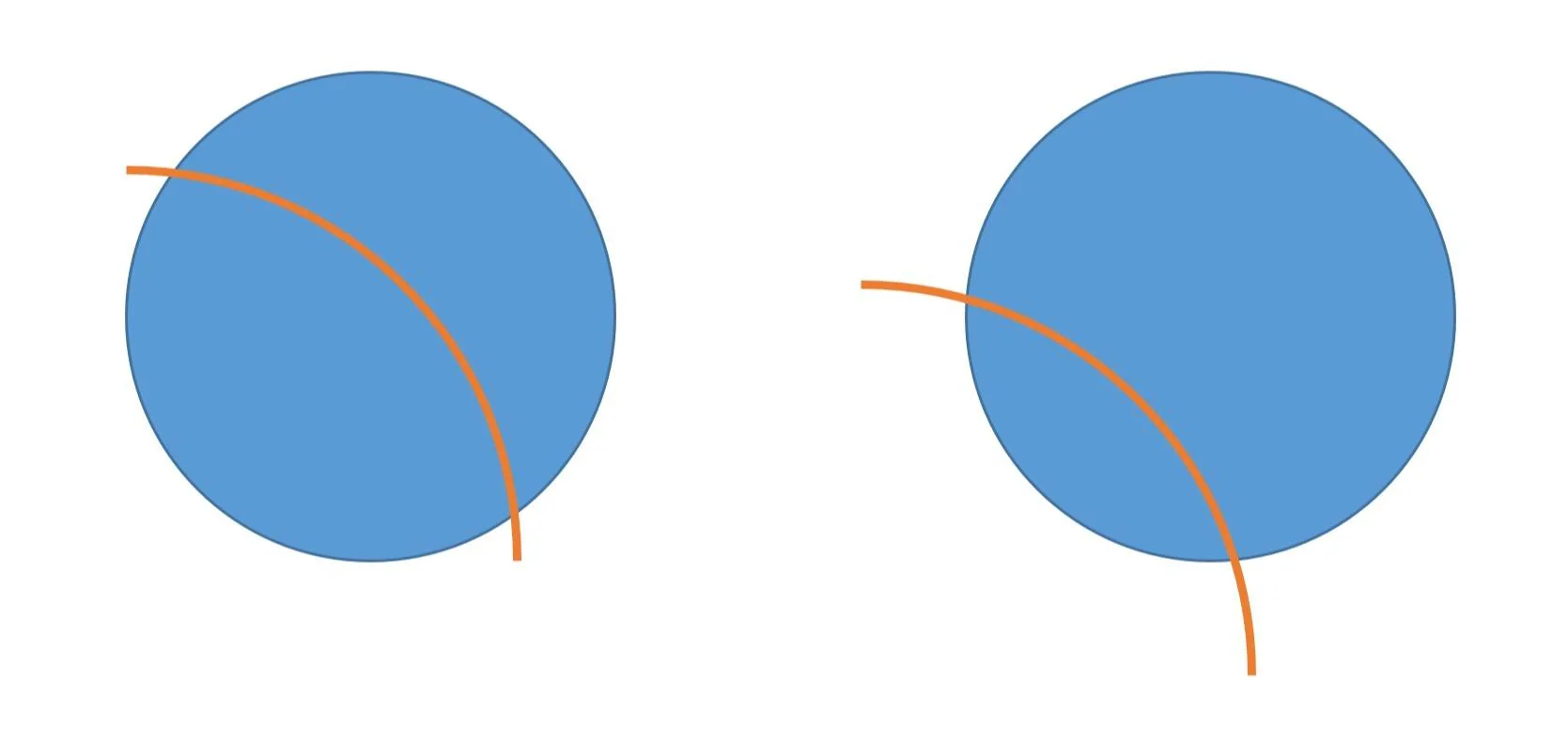

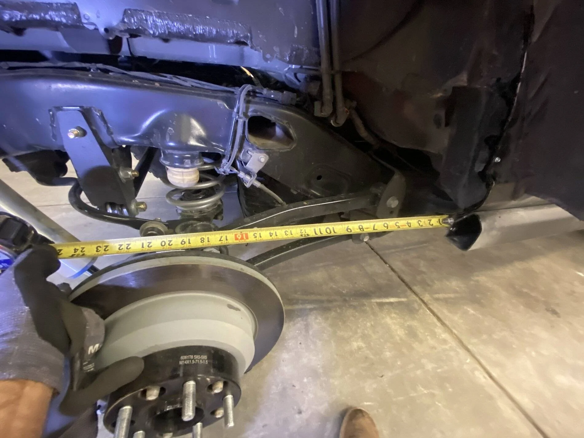

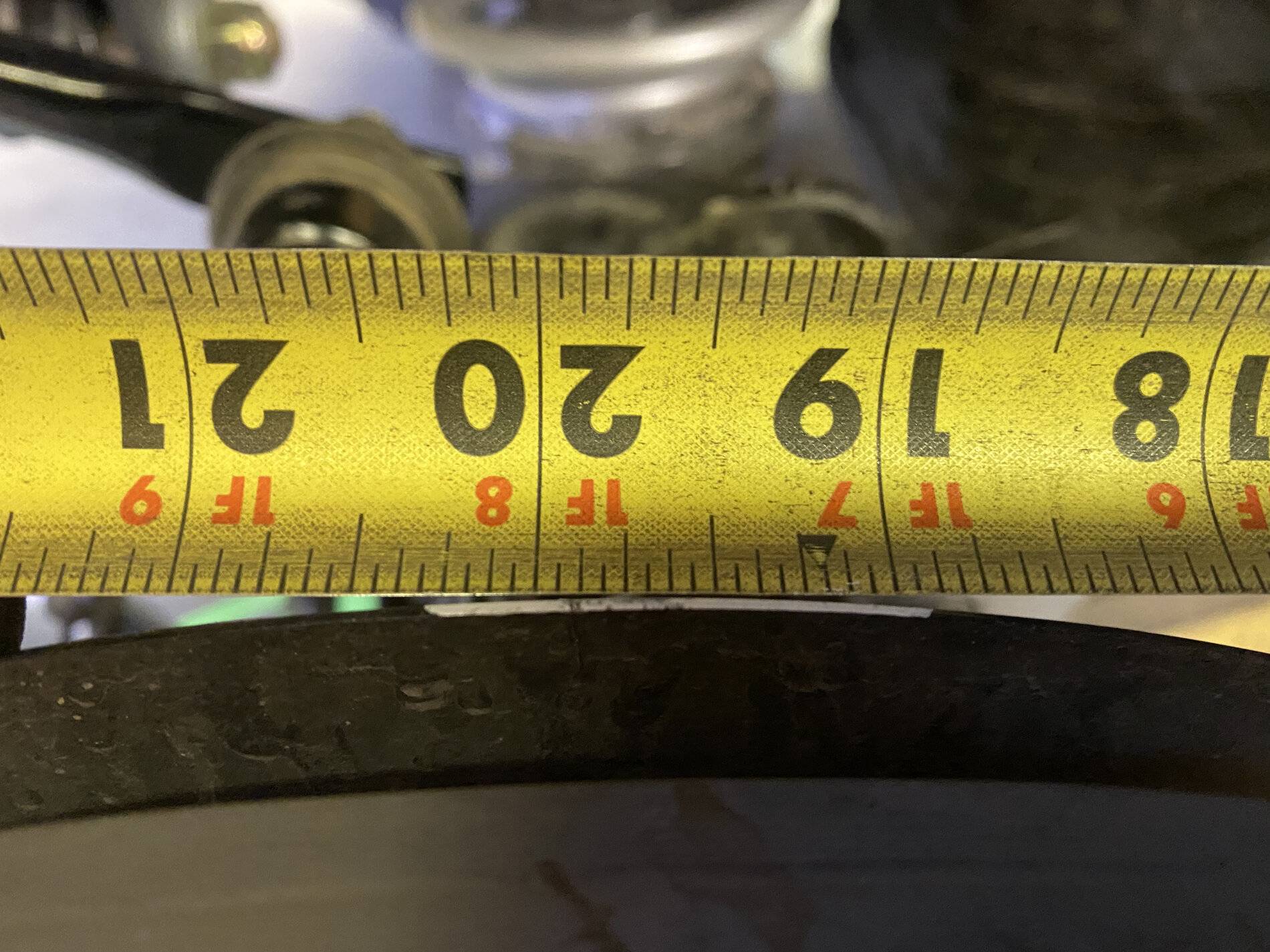

Control arms are not the same length, so their arcs are already different. This means at some point in their travel they will already bind once the bolt can’t compress the bushing any more. You’re starting out compressed, so at best your up-arc will bind early. More likely, both directions will bind early.
Maybe your shocks will limit travel first, but you’re still going to wear out your bushings faster with un-necessary stress, and potentially lose ride performance in the pursuit of a caster number. It’s just a number, not a magic boost in handling.
