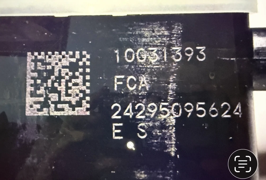

So how do I know what sensor would I need if I just need one for the rear? Where do the other 4 sensors go?
Any part number if I am ordering again?
I had ordered this OEM Mopar 68544629AA Locking Axle Sensor
The kit consisted of 5 sensors which had slightly different calibrations. There was a trial and error process to find the correct one. The other 4 were not used. The kit was very expensive, upward of $500. I would simply bypass the sensor with one of the jumper bypass wires sold by either Z-automotive or on Ebay.
