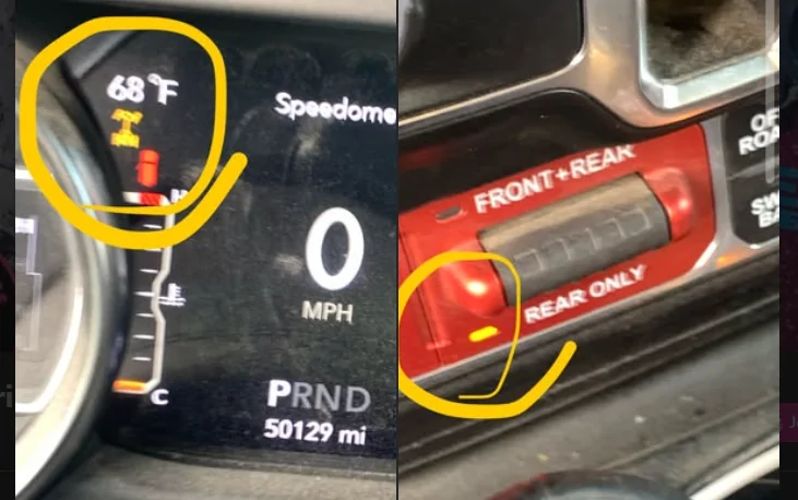

These are the dash lights that will illuminate for the failed position sensor, correct?
Jeep Wrangler JL Locker Position Sensor Potting - DANA 44 yjsyxayfeszb1

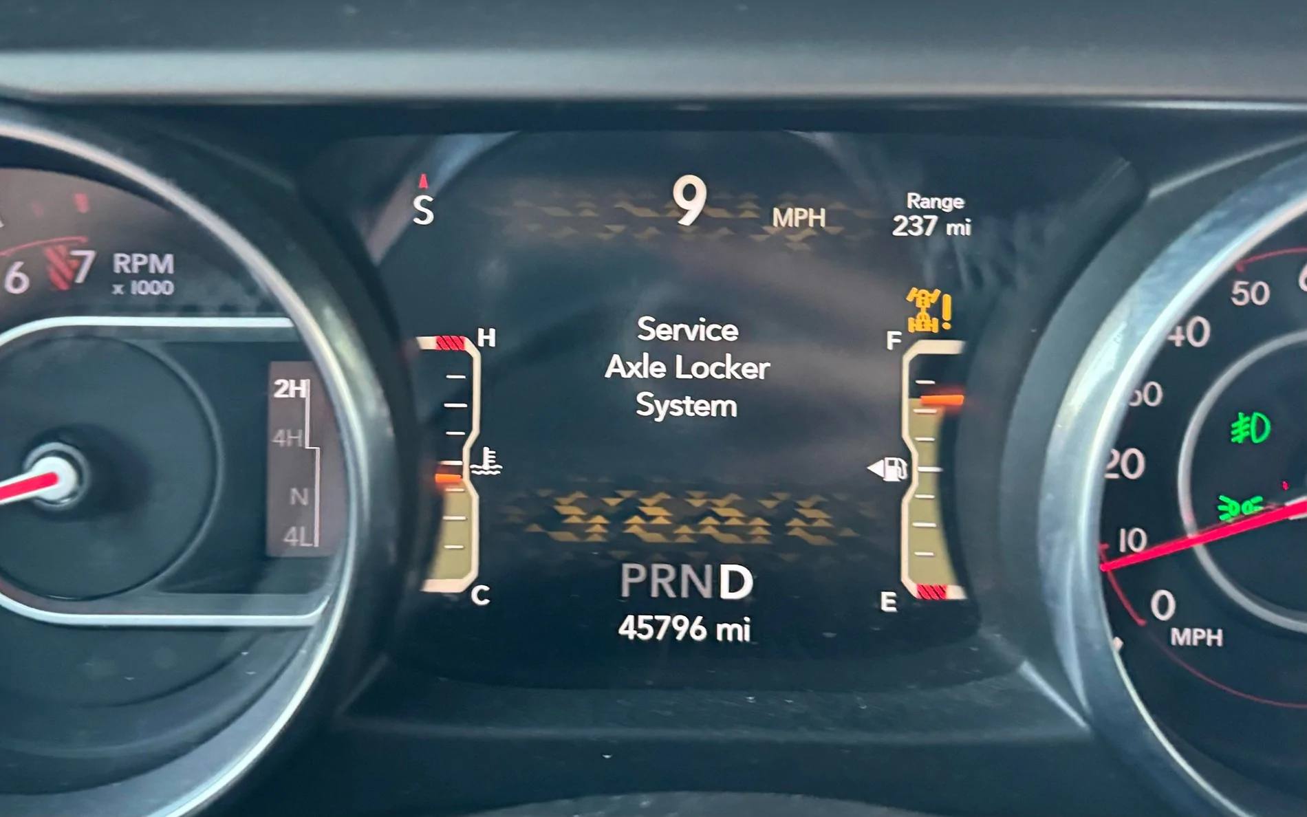

I get these warnings about 90% of the time when its warm (almost never when it's cold) out thanks to the body shop putting the wrong front axle in after my accident. Lockers don't function when the light is on, they function normally when the light is off. There is a stored front differential position sensor short to ground code.
The other day this dash light started flashing along with the light next to the rear locker switch.
Jeep Wrangler JL Locker Position Sensor Potting - DANA 44 asdf
I've been too busy at work to experiment with anything or pull codes, does this just mean my rear sensor is going out now, too?
Not my pics btw, my Jeep is dirty but not that dirty 🤣

So @chevymitchell @Terrymo....we changed the sensor and the light is still flashing. Do we need to cycle something? Or drive it for sometime for the flashing light to disappear?
If you have a good sensor of the correct calibration installed, it should extinguish the light.
The sensor is a hall effect position sensor. The Mopar repair kit consists of 5 sensors, each with a different position calibration. I can only imagine this is necessary because of manufacturing variations of where a small steel on the locking plate, moves in and out of the slot of the sensor. The sensor kit has a process of testing to find the appropriate sensor.
