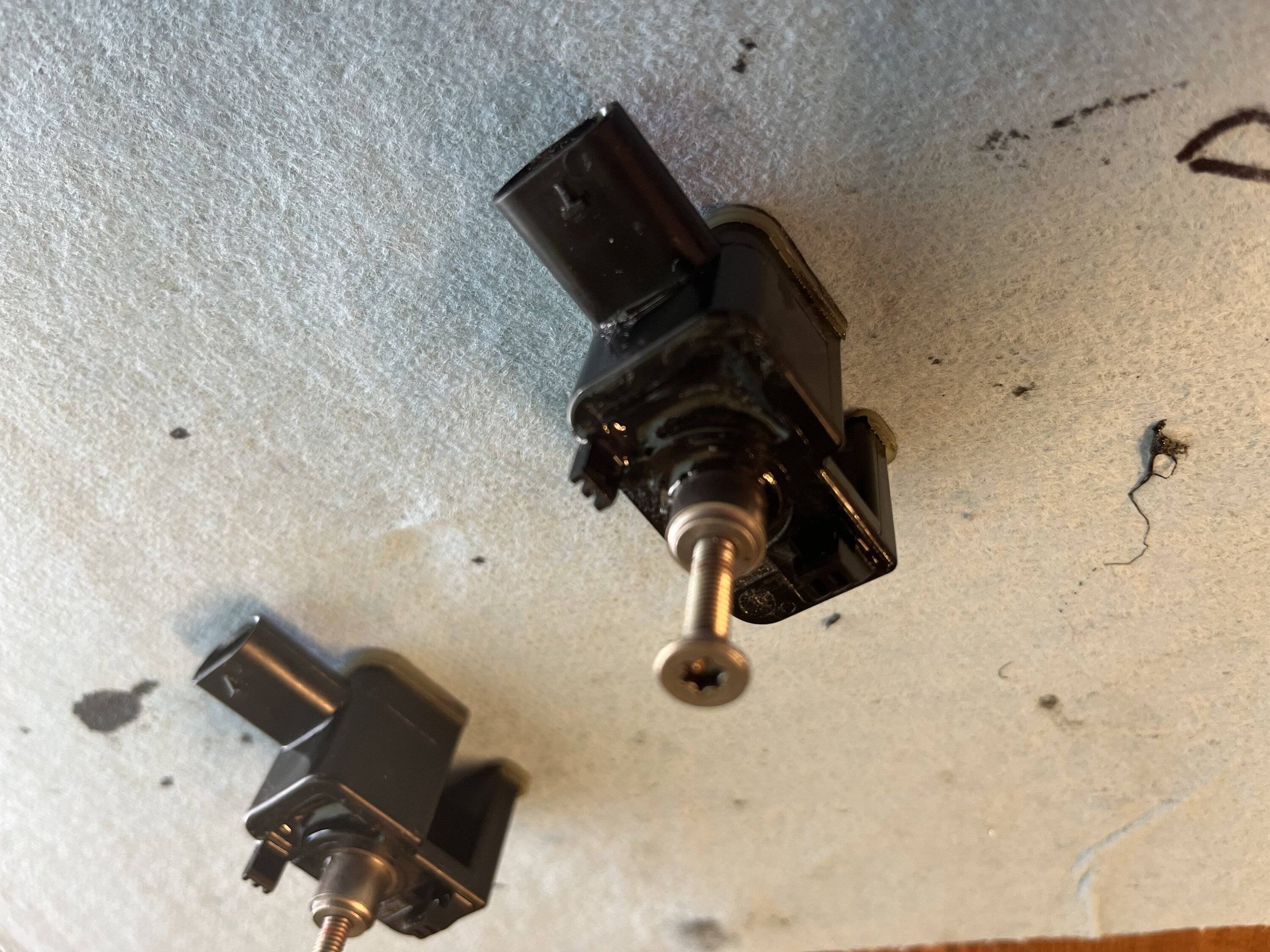

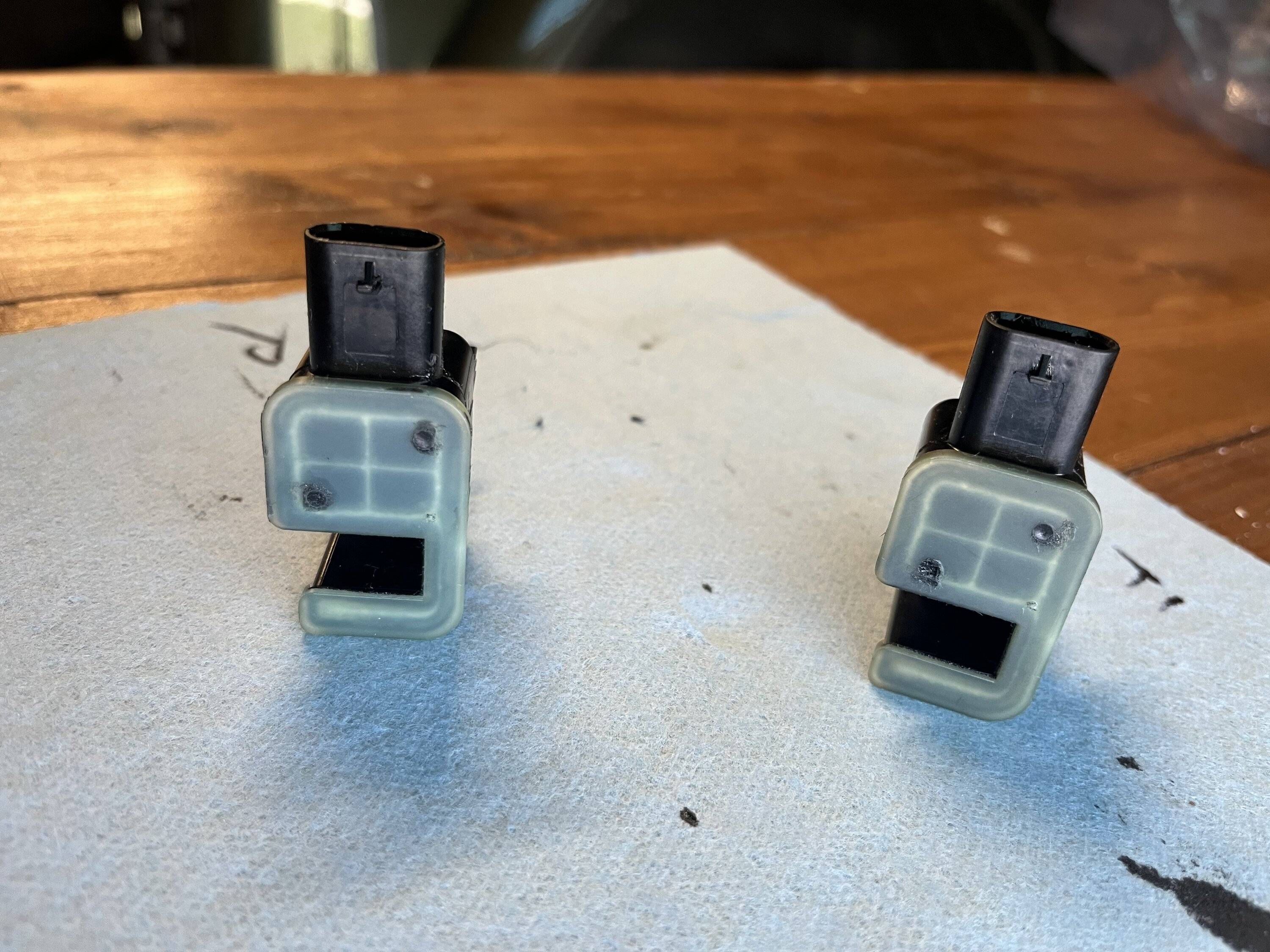

You say 12 hrs min before install, but 24 hrs ideal. Is that 24 hrs from initial pot or after the acetone cleaning (which had been at 5 hrs cure time at the point) How critical is it to give a full 24……I may need to reinstall around 19hrs so I can get to work.
chevymitchell
chevymitchell
Shawn
Feb 18, 2018
112
5,017
12,147
Pueblo West, CO
Avi Engineer
It's really critical. If you heat the material up before it's cured, it'll bleed out of the sensor.
The 12 hours is accelerated time before install, but the 24 hours is important. That time is a moving target depending on humidity, temp, etc...
I wouldn't risk pushing the cure time of a chemical. You can help the off gassing by setting it in the sun, but it only helps it by a few hours.
That 24 hours is from potting. 19 hours should be enough.

Gotcha. I def want to give it the full 24 cure time. I’ll be 24 hrs from initial pot, so that’ll be perfect. I thought it sounded like I had to to wait a full 24 from the 5 hr initial cure to clean up the outside. Thanks again.
