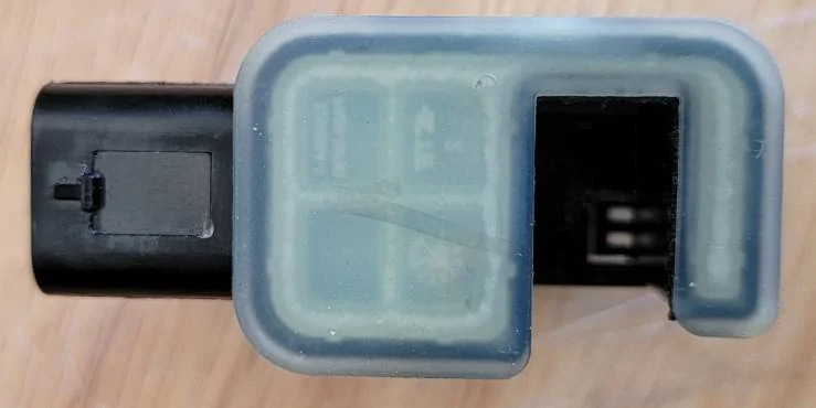

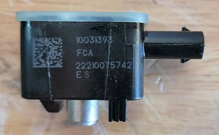

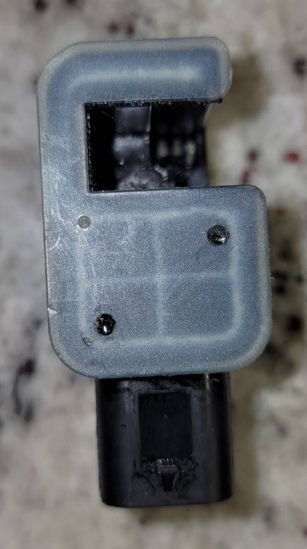

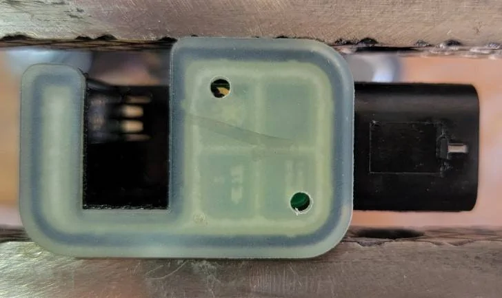

Dealer just replaced my rear locker after it failed again. I can also confirm there is no change to the sensor (see pics)
Pulled it last night and got it potted.
Hopefully it will work for years to come.
Thank you for the write up!
