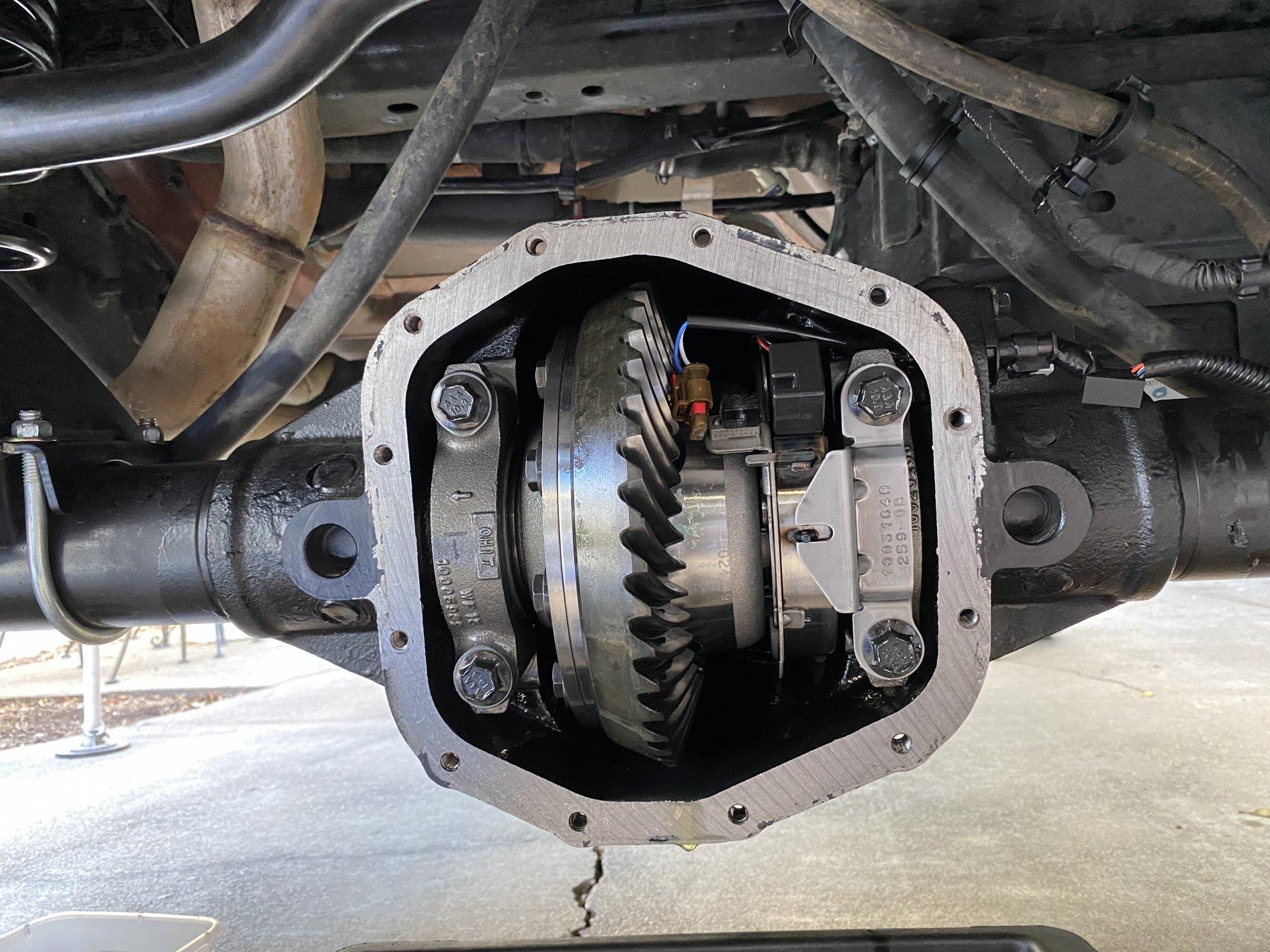

@chevymitchell and I saw the same thing on my Jeep and wondered the same thing. I guess it's possible but I can't say for sure. I did the same and cleaned it off really good.That sure is some clean diff oil draining out of there. What do you have, like 10 miles, on those new axles?
Oh, and for everyone reading, mine had a bunch of metal shavings on the magnet that moves in the sensor slot. It was pretty silver, so cleaned it off and the magnet is black again. I wonder if this would have caused problems in the future if it collected too much.....

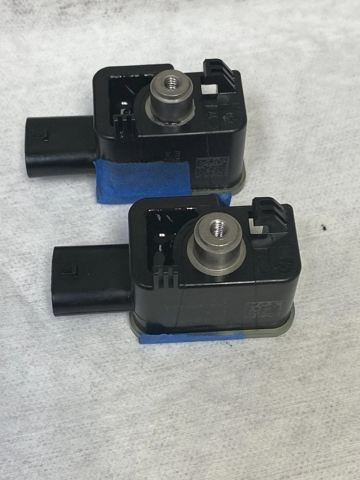

Now that the sensors are potted, if they throw a code in the future, this may be a cause. Good thing it's pretty easy to remove the sensor and clean the magnet.@chevymitchell and I saw the same thing on my Jeep and wondered the same thing. I guess it's possible but I can't say for sure. I did the same and cleaned it off really good.

The only metal I remember seeing was on the drain plug magnet. Then again I did flush the diff out with brake cleaner to get rid on dirt that fell in there when I took the cover off.Oh, and for everyone reading, mine had a bunch of metal shavings on the magnet that moves in the sensor slot. It was pretty silver, so cleaned it off and the magnet is black again. I wonder if this would have caused problems in the future if it collected too much.....
I cleaned the injector/tip by putting it up to a garden hose and flushed out 98% of the compound. I've used the injector/tip again on another project with no issue and cleaned it again the same way.Once the "832HD Potting Compound" is used, is it easy to clean the bottle/tube, and store the bottle/tube for a second use several weeks later?
Is it necessary to store it in a special environment so that it doesn't dry out or become unusable?
How do I clean the injector so that it can be used a second time?
Is it necessary to store it with a penny without "the injector" (the liquid or the liquid passes, I don't know how to translate it, sorry).
All your advice is welcome so that I can avoid making mistakes. Thank you for your help and advice.
About 50 miles as they just replaced both axles on my jeep and didnt want them to fail againThat sure is some clean diff oil draining out of there. What do you have, like 10 miles, on those new axles?
