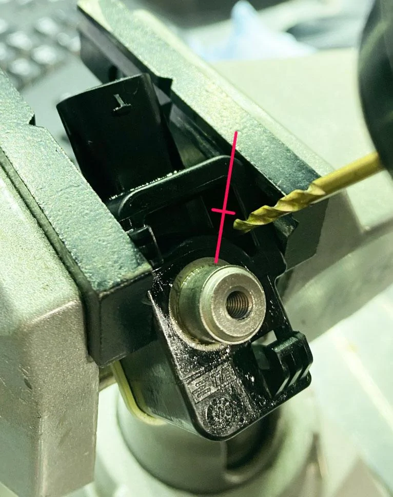

Where exactly on the rear of the sensor are you drilling, for that "bottom" hole? Everything being black is fooling my eyes. I plan on doing this when I swap diff covers this winter.
I pierced mine yesterday, be careful as already explained here there is little room in depth.
I made my hole in this axis, if it can already help the time "Chevymitchell" redo photos ;)
I don't think I need to redo the photo now. The picture you provide will work great. There really isn't a magically spot on the bottom. Just make sure to leave enough room for the injector and it'll work like a champ.
