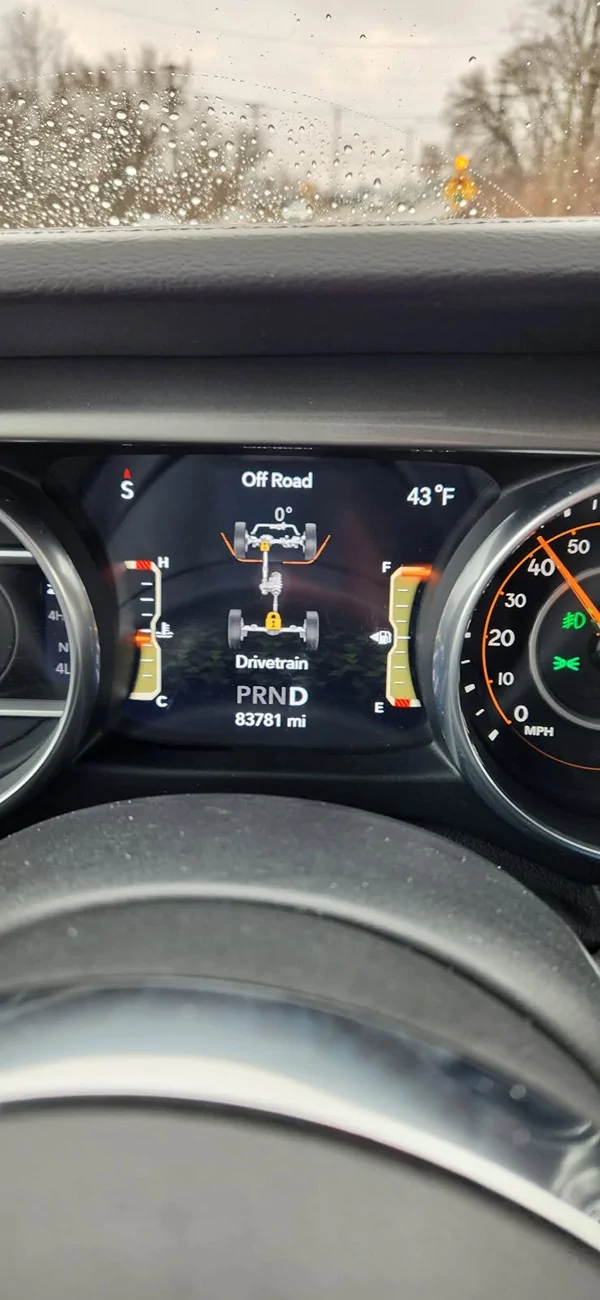

2 weeks ago at highway speeds got the service locker system light. Did some research came across the locker sensor issues. So got the ZAutomotive OEM Lkr harnesses. Installed them today and light went away.
This afternoon thought I would test and make sure lockers where functioning correctly.
4L engage rear locker no issues on the screen lights etc. Works as expected.
4L engage front and rear locker Flashes forever and does not engage.

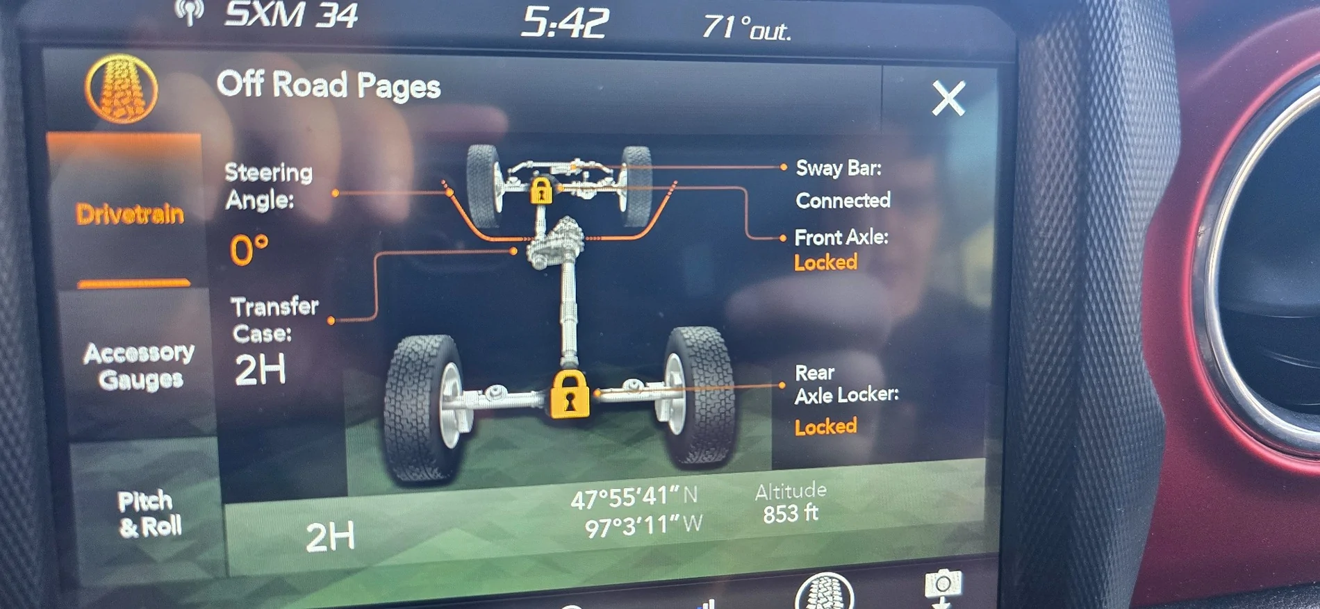

Check offroad pages on Uconnect and it shows both front and rear are engaged even though the light was still flashing.

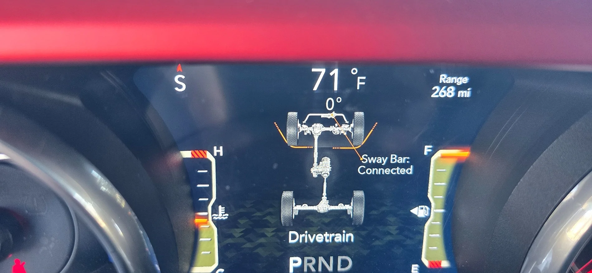

Turn off lockers go back into 2W and the Uconnect still says that they are engaged. Instrument panel does not show them engaged.
No error codes no nothing.
Any ideas on this one

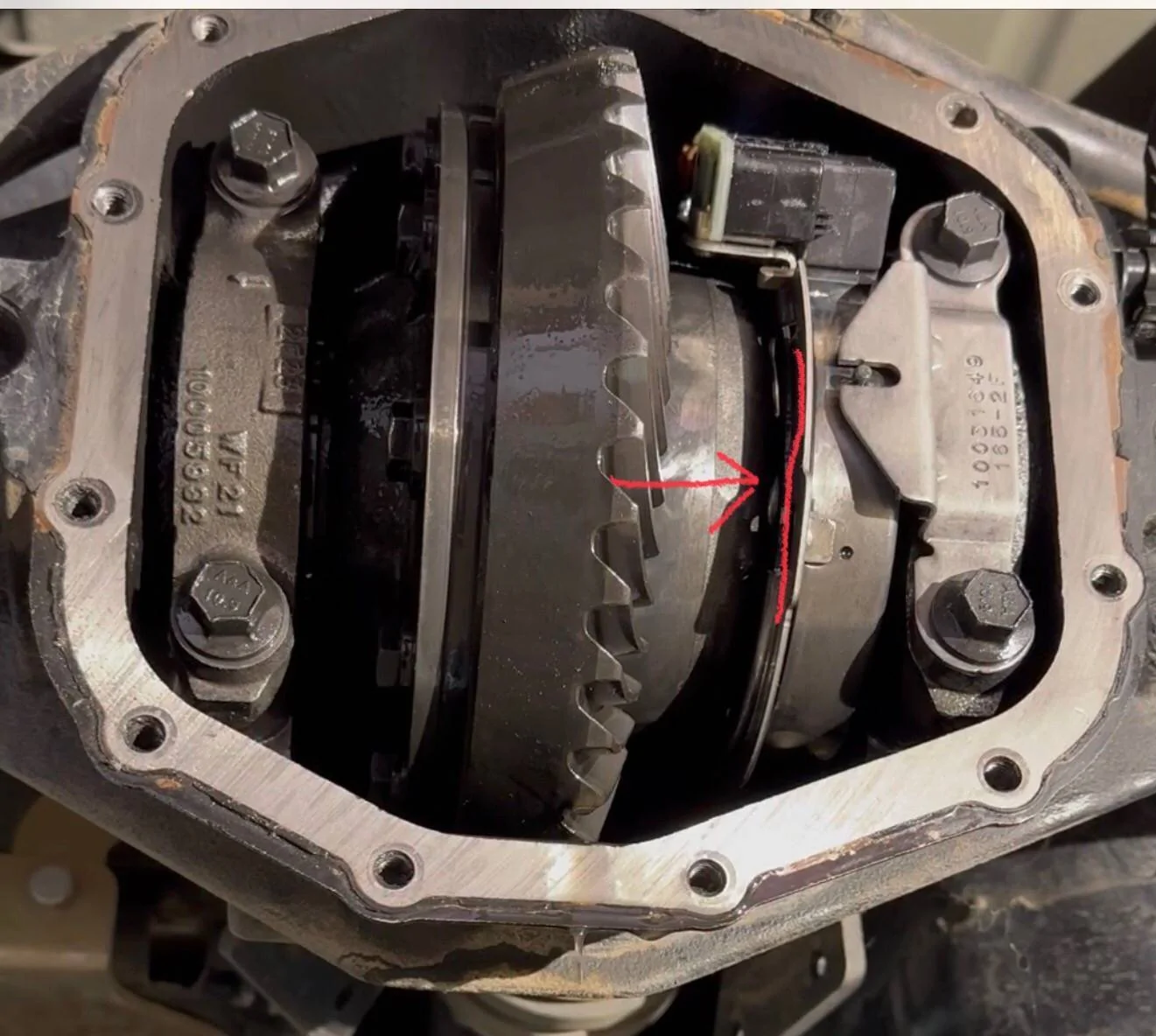

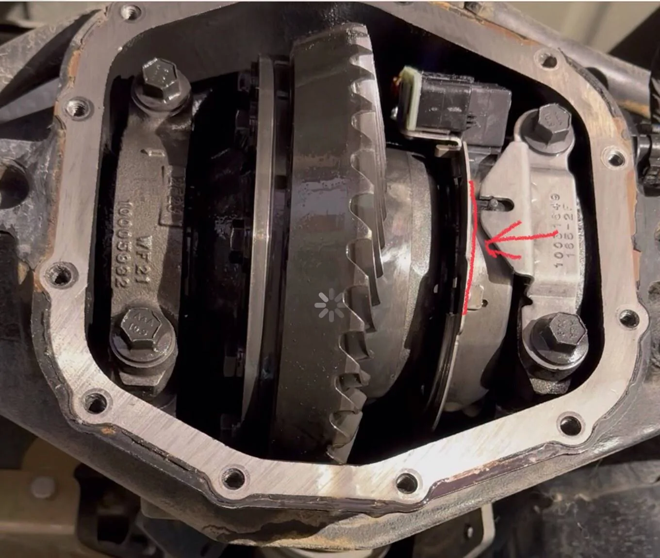

I tested in my driveway with the diff covers off and my phone propped up to record. This plate will shift as the lockers are engaged to lock, and then shift again in the opposite direction to unlock.

OEM will look like this. Same click that @roaniecowpony is pointing out on engagement.
