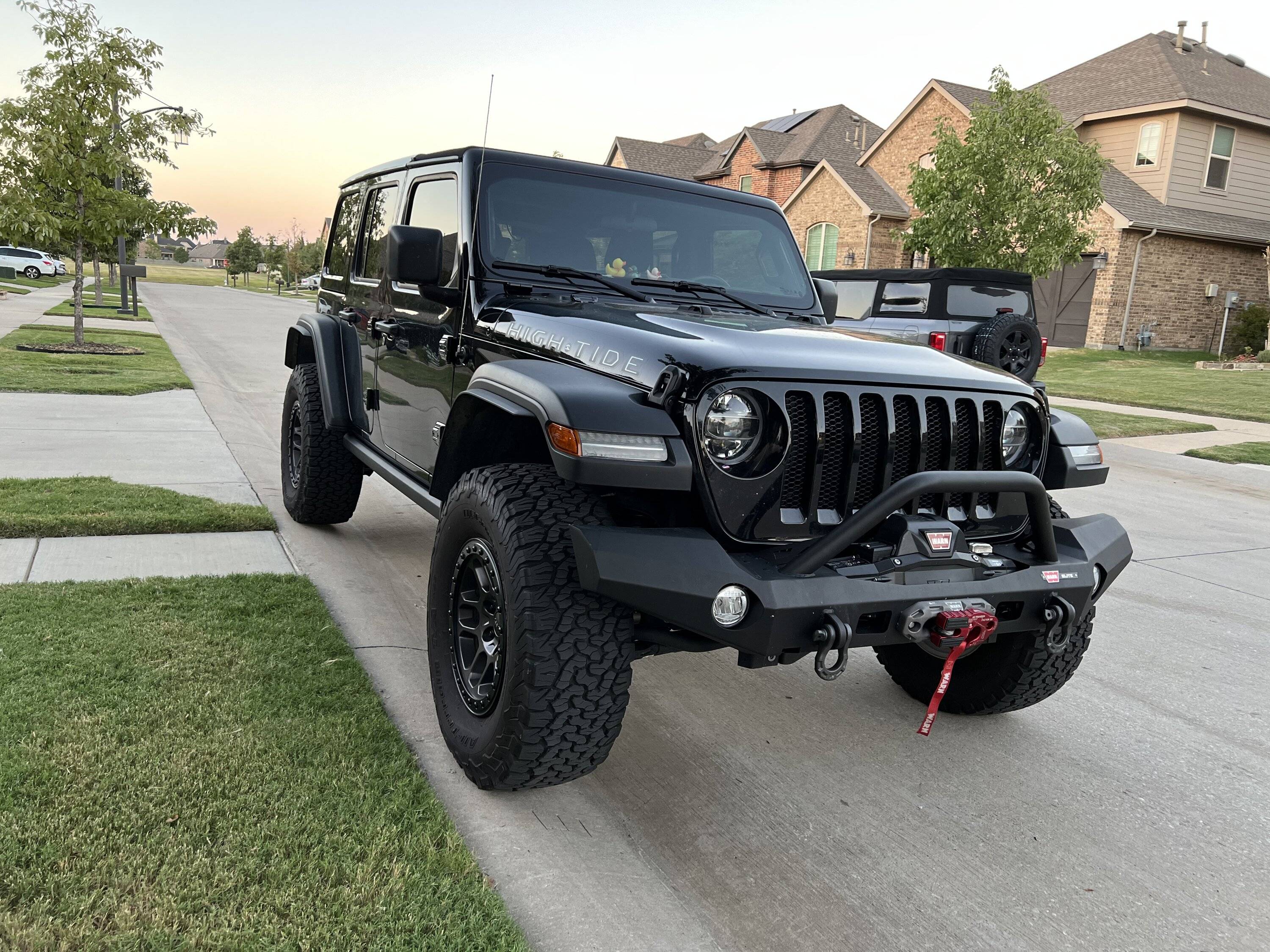

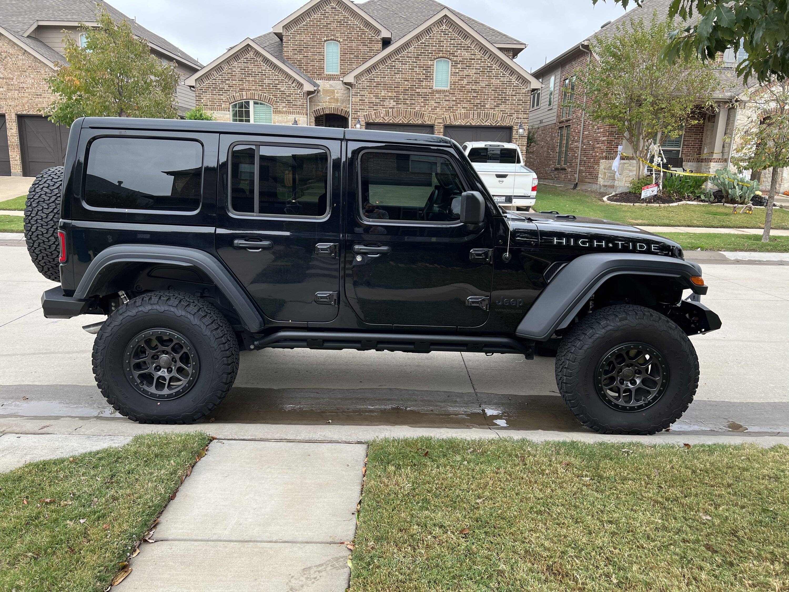

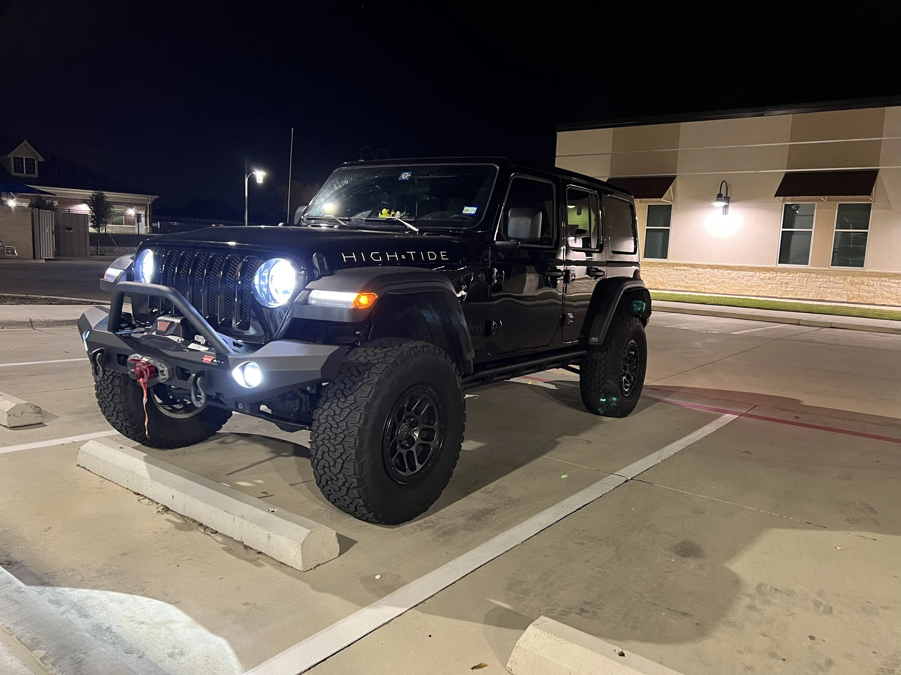

One before and two after. Front fenders went from 39” off the ground to 43” off the ground.
I know these comments might not help much, but the productive one would be asking if the front lower controls arms were replaced by longer ones to dial-in caster, which is one reason why wranglers don't like lift.
My other comment is in regards to looks..... Your Jeep looked awesome in stock XR form and now way overlifted for the tire size, especially that second pic..... So my questions would be 1- you mention front fender measurement. Is that from the side and ground to fender lip ? ( trying to evaluate lift ) 2- What motivated you to lift it ?

I may go 37's at some point and toss these 35's on my Gladiator, the reason I went with the lift is the bump stops had about an inch of travel after adding my steel bumpers and winch, i'd bottom out on smaller bumps pretty easily. I dont think it looks that bad in person with the 35's. Lot of suspension travel available now.

Oh yeah, I forgot about the bumpstop issue, makes more sense to me now. Hopefully it settles a little and make the 35s look more at home.
You paid good money to buy a Jeep built right out of the factory, it'd be a shame if you negated that optimum gearing/tire combo, but hey, your Jeep:)
what about the measurements you mentionned ?? is that the front fender to ground, or ground to side XR lip at middle wheel ?

Ground up through the center of the wheel to the edge of the fender extension that pokes out.
Thanks, well it was a bit low compared to other XRs, most people have between 40.25'' to 40.75'' measured at that exact same spot. Might be a high tide/ Beach model thing. I understand even more your motivation. Thanks for specifying.

Right, and I think that's where it was when I first bought it. When I added the steel bumpers, rock rails and winch it was down to 39" and hardly any bumpstop travel left.
