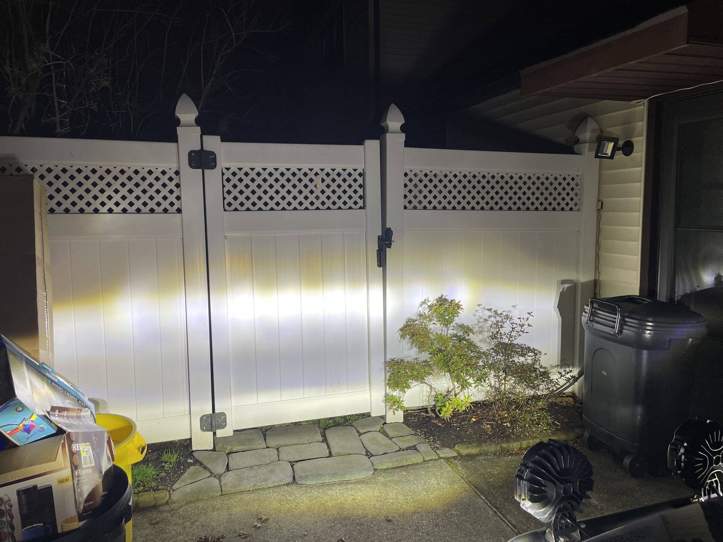

Don’t mind the boxes. Christmas was after our recycling day ?
I wonder if youre getting some reflections off the stuff in the field of view because there is some serious light spillage happening.
Theres even a random light spot towards the top of the fence on the left. But even above the hot spot, theres quite a bit spillage happening.
I’m pretty sure the top left is coming off my neighbors side door light. I think it’s just my fence showing the spillage. When I adjusted them off a brick wall there wasn’t anything above that main line. If I get a chance tomorrow night I’ll get a pic off the brick wall I used to adjust.
Thank you. I’m looking at the tinted version of these.

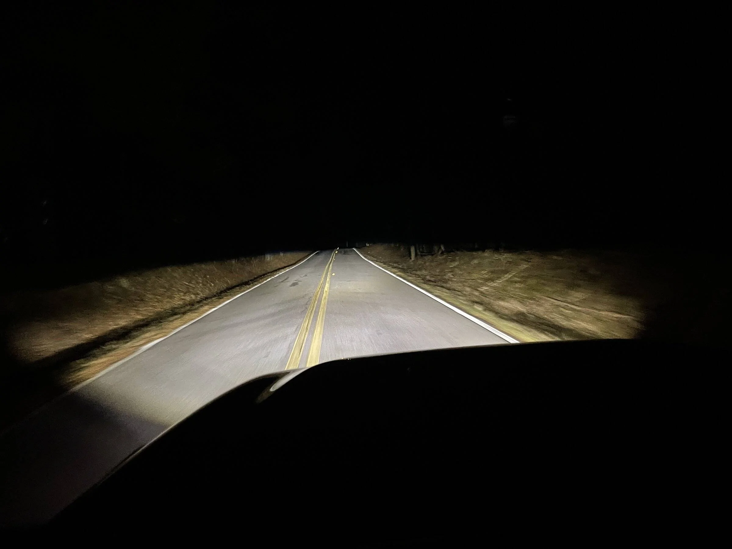

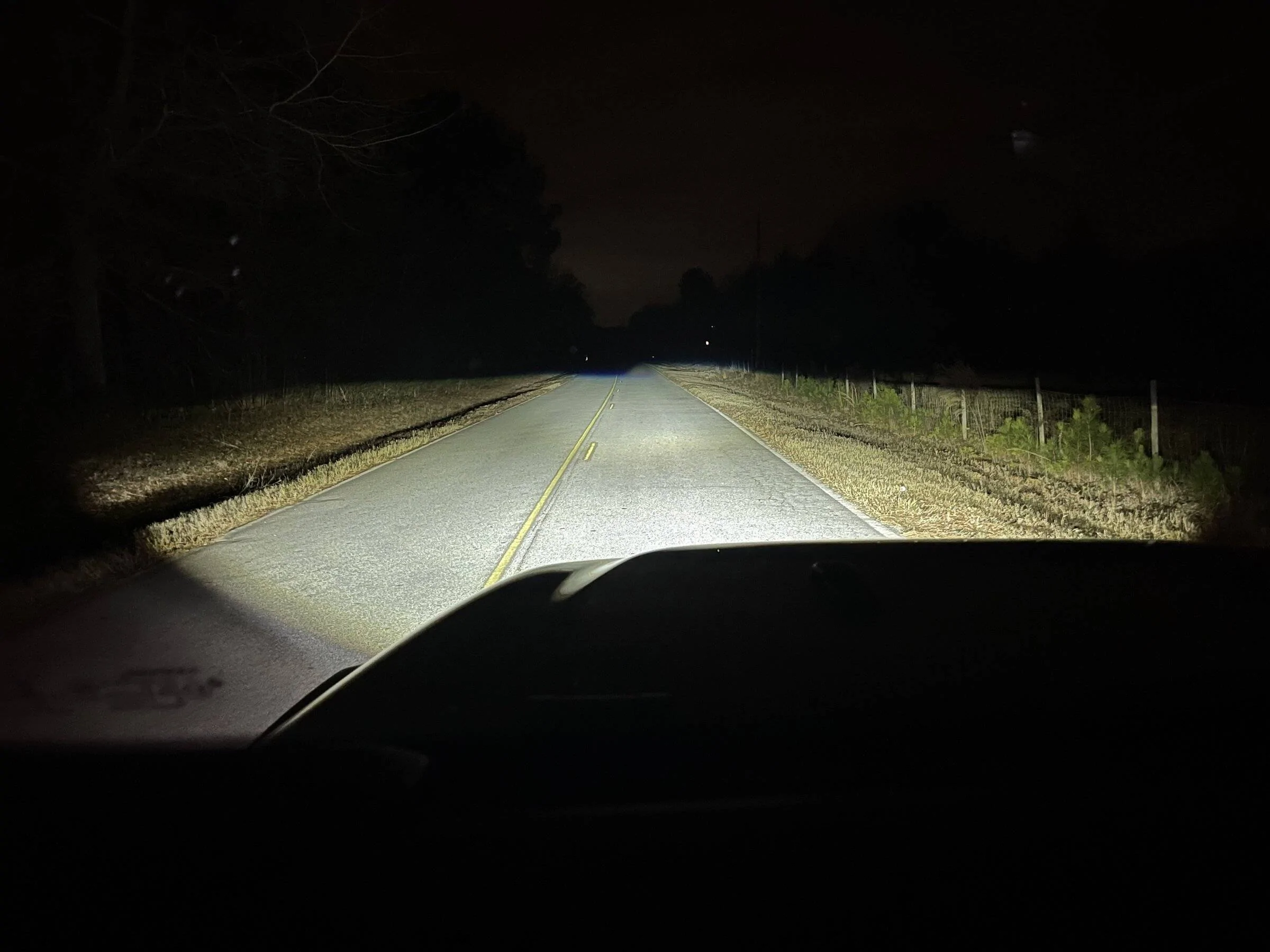

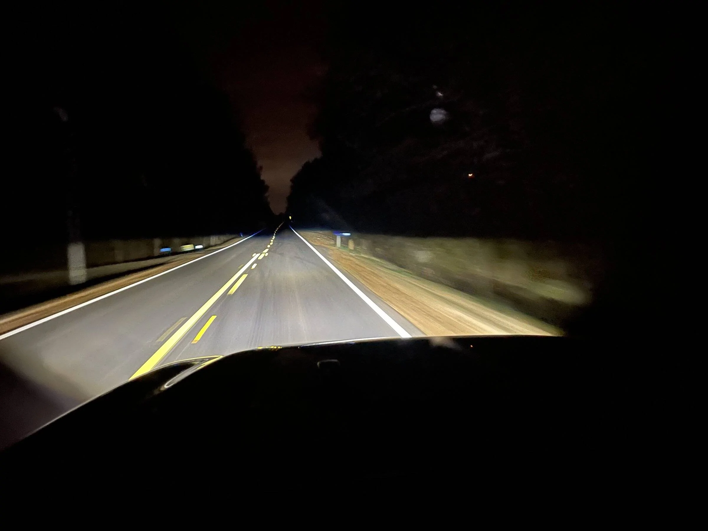

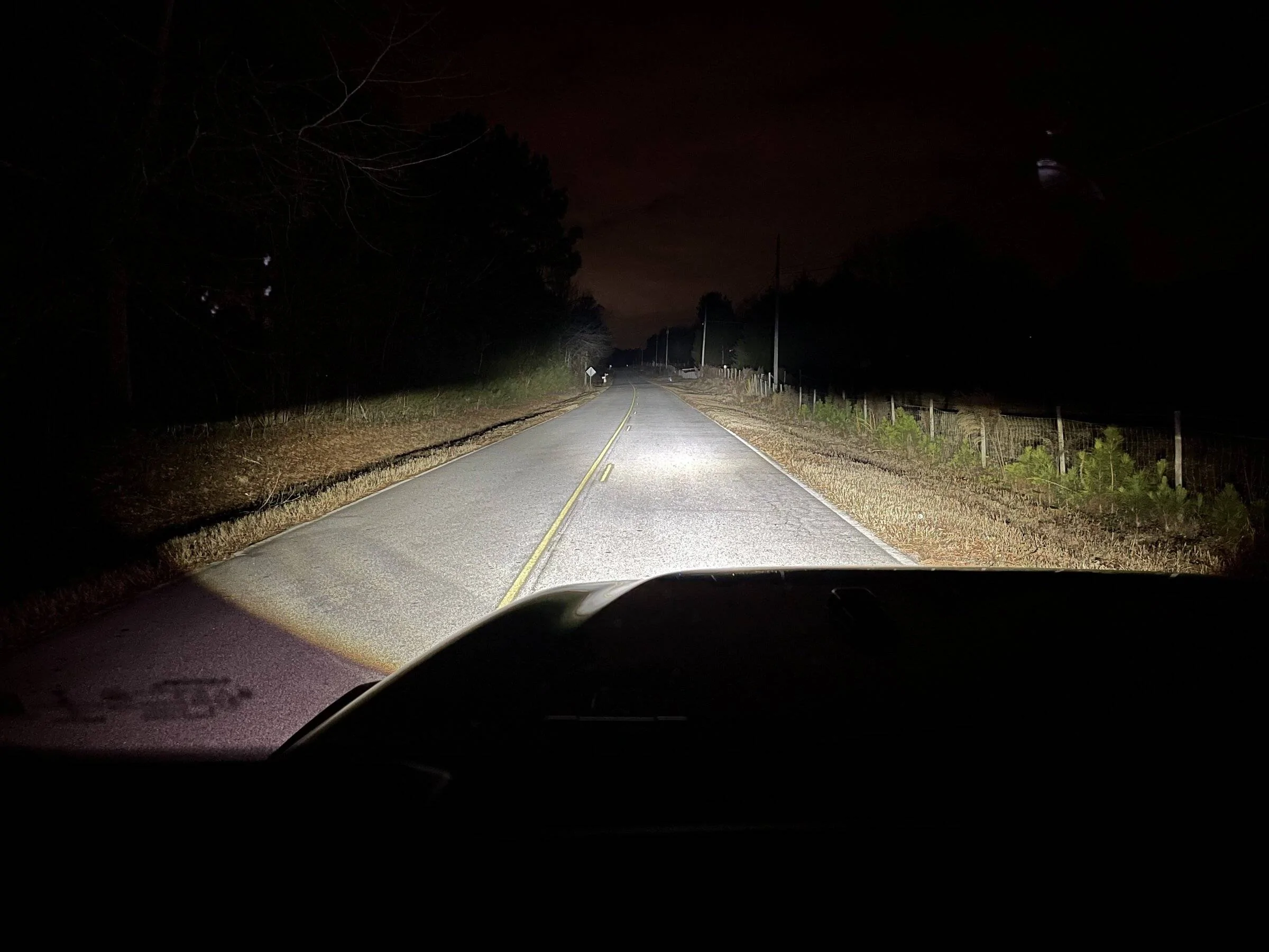

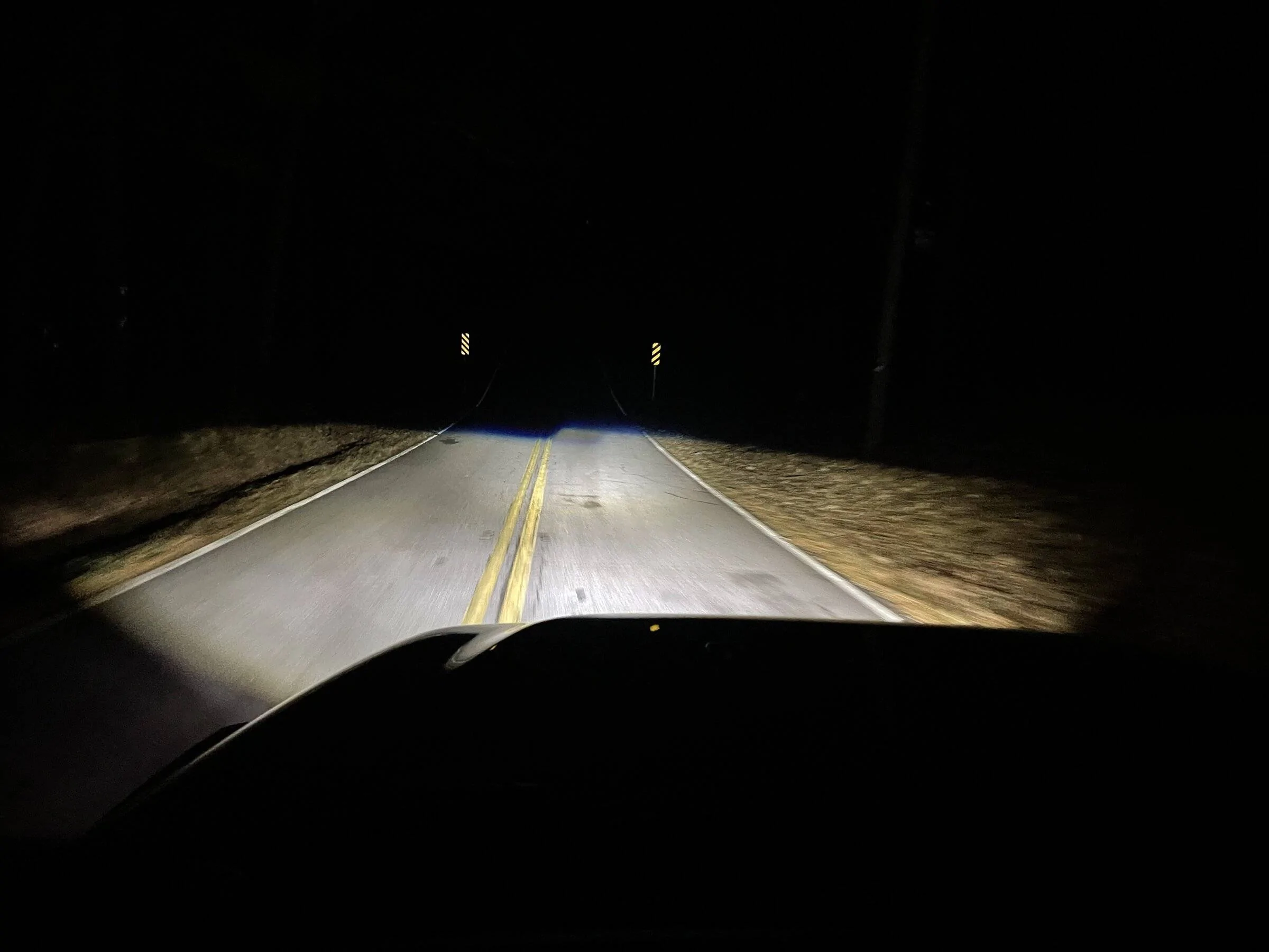

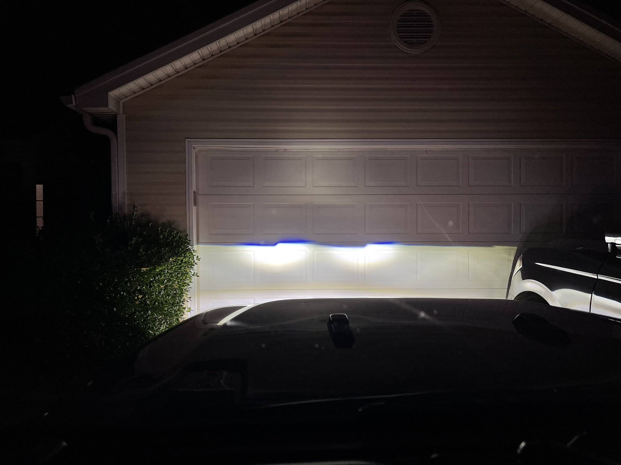

I have the Oculus headlights. They have an extremely sharp cutoff, wide throw. Adjusting them is fairly easy with a Allen wrench, the one that comes with them is a little short though. My only ā€˜complaint’ is more of a getting used to them and that sharp cutoff. It’s pretty hilly here, when you’re going down a hill you can’t see what’s coming up because there is virtually no light abothe cut off.
Low beam
Low Beam down hill, the road immediately goes back up
Back up just after the signs
the thing not many show, comparison of low beam and high beam sitting still in the same place
Low beam
Thanks for the good pic assortment, they look identical (the output & cutoff) to the Rough Country projectors I just bought. Yours even have the same step notches in the cutoff that mine do :)
I found that using 5mm hex sockets work best for adjusting them, don't even need the ratchet, just the socket and a small extension on the drivers side, and just the socket on the passenger side.
I've done a few height adjustments, started out too high and was getting flashed, then went way too low and barely lit up 15 feet in front, then split the difference and it's real close to where they need to be.
The upper blue edge is pretty distinct and takes some getting used to, my Infinity G w/ theretrofitsource.com lenses had a very similar blue edge, but much thinner and a perfectly flat cutoff, no steps.
Overall I'm very happy w/ the lights, just takes some fine adjusting and some time getting used to the "new" output.
I would by them again :) And they have a 3yr warranty if you buy them through Rough Country.
