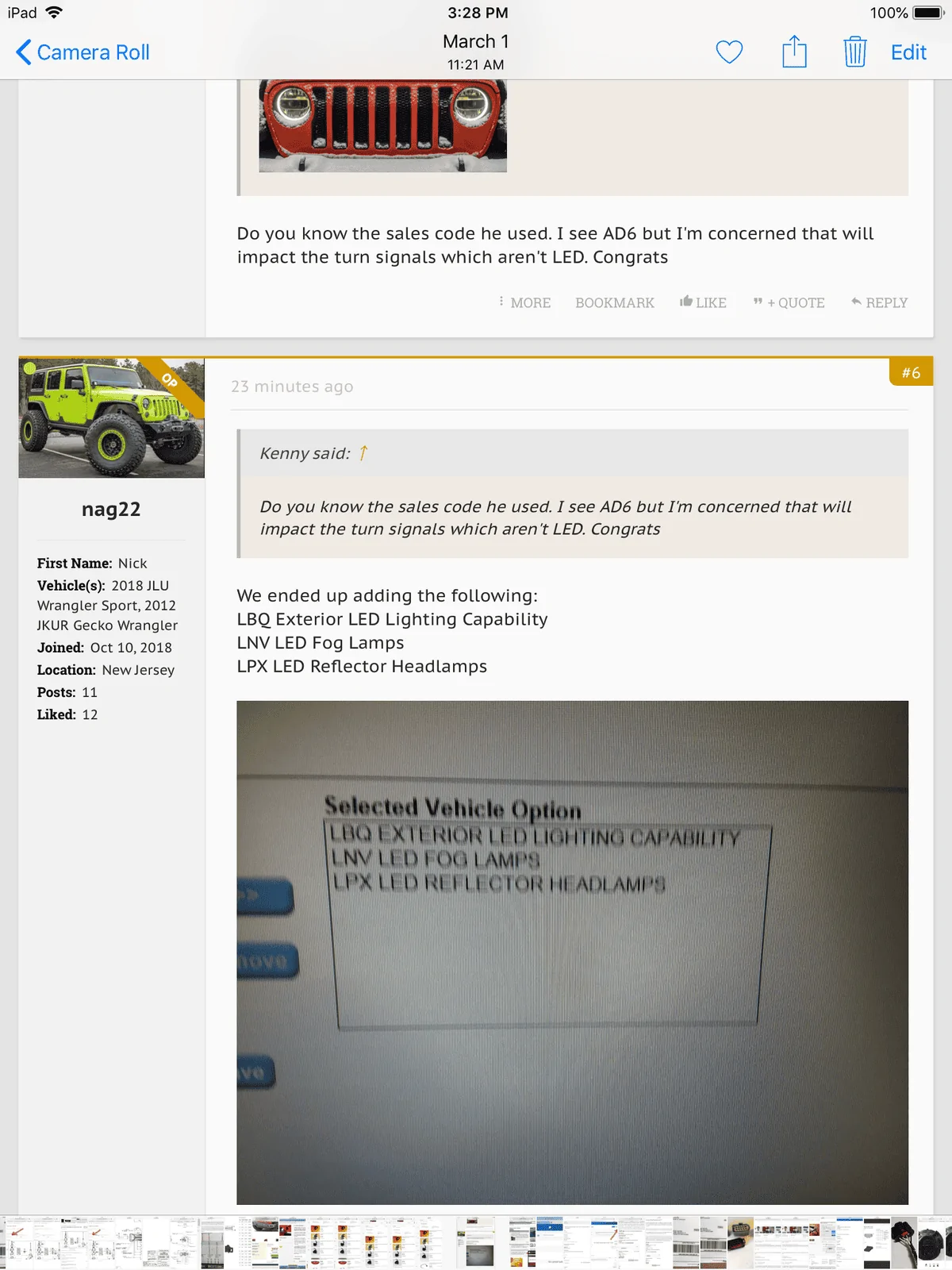

Ive seen this several times now, the dealer is not uploading / reflashing the proper code for the lights to work properly. See attached screen shot of dealer software - you need the “LPX” code properly flashed
Jeep Wrangler JL LED Headlights 2018 UJL D70A2C91-69CC-49A5-AF1E-7AA164683665
