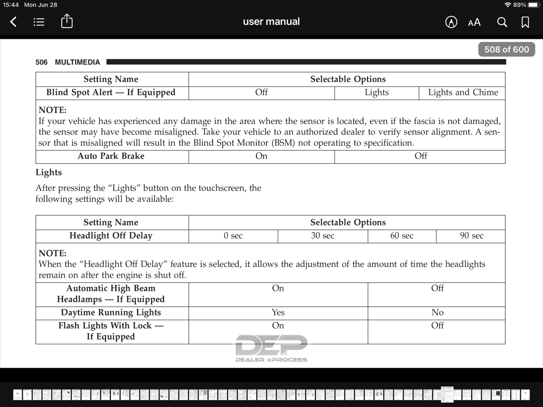

On my Sport, which does not have auto lights, there is a setting in the UConnect to control how long they stay on for called Headlight Delay. This is more of a safety setting to keep them on while you go in the house, but it may have shut them off for you.
Yes I was wondering about that too! I have mine set at 30 sec. I will have to watch and see. If that is the case, I may just drive with them on all the time if that works. What do you do?

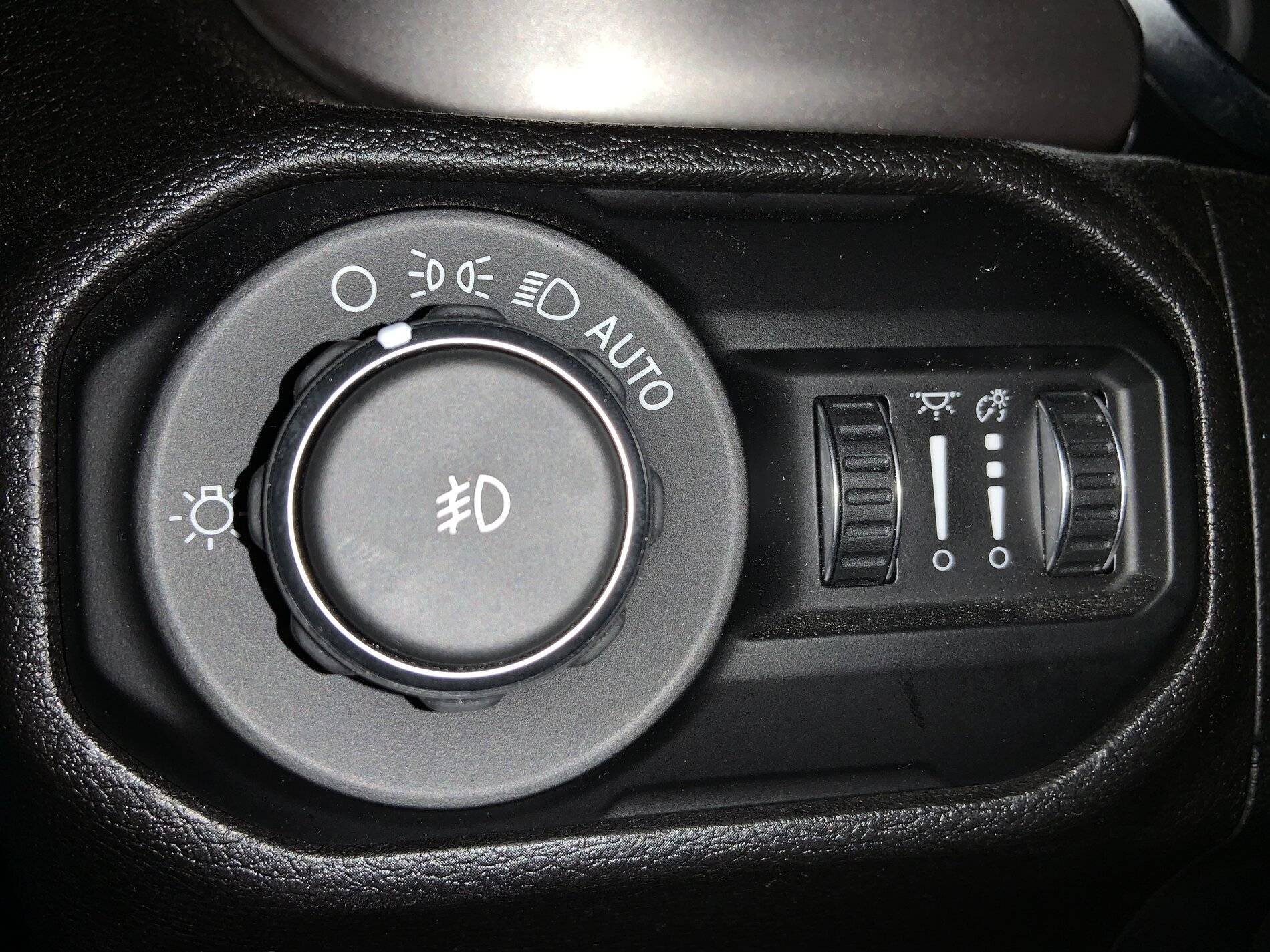

I have a base Sport and I swapped out the headlight switch to one with the auto setting. Works great.
Did your Sport come with the eye/sensor thing on the top of the dash to make the AUTO on the new switch work? Or did you add the eye/sensor thing?

I added nothing but the switch. They come on and go off with the ignition when set to auto. I believe the sensor will automatically turn the lights on and off depending how light or dark it is when the switch is set to auto.
