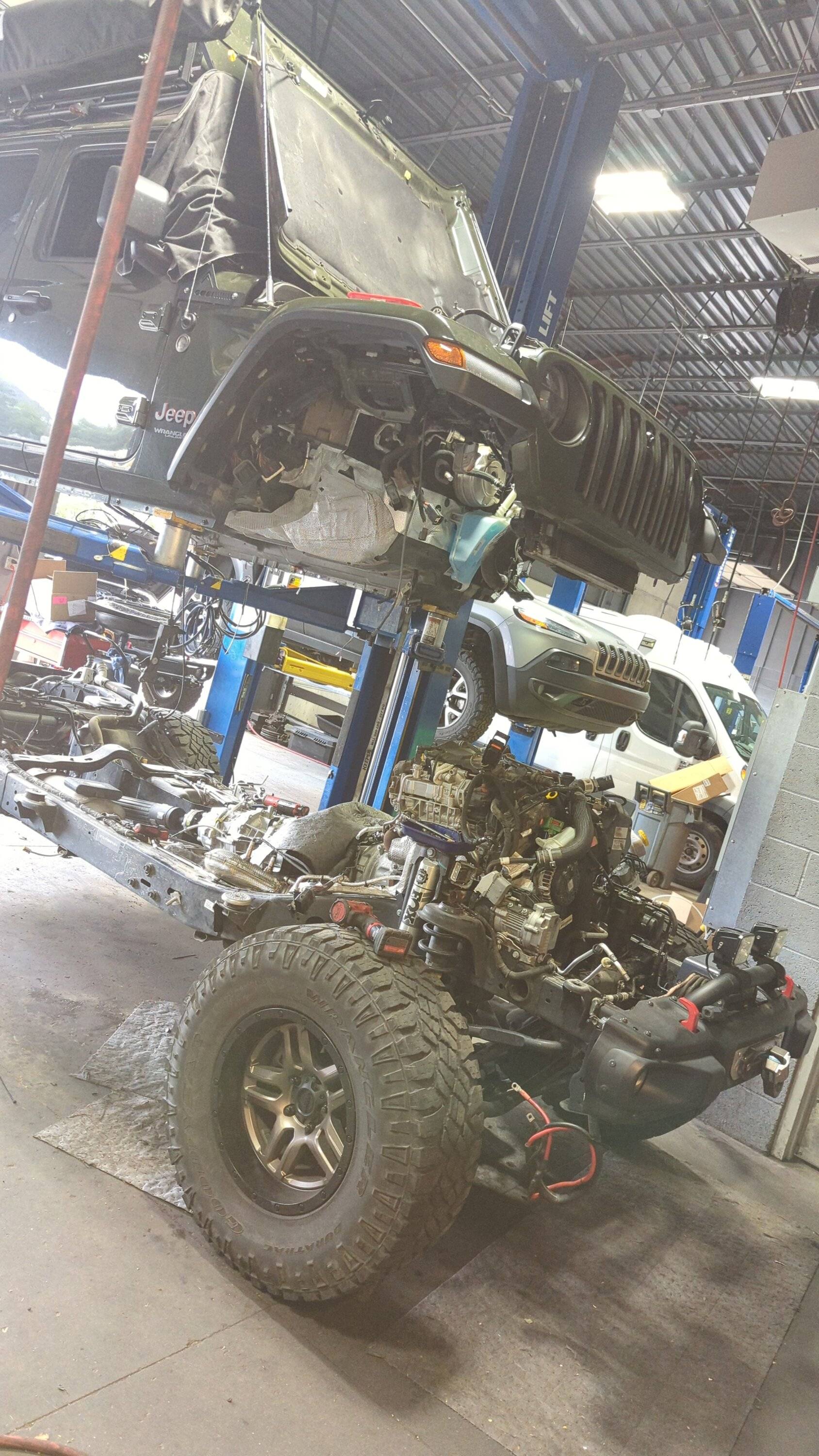

I know this is an older thread but I just had the same issue at 41,500 miles. Driving across Texas I had a CEL as well as numerous other warning lights together with a loss of power. Pulled to the side of the road and shut down and restarted. CEL remained on but other warnings gone and power restored. After several restarts I went to the closest Jeep dealer. They advised code P00AF, performed a star publication 52018000009 procedure and updated PCM to 68501372AG. That lasted 250 miles after which I continued on to my destination in Arizona stopping and starting as necessary to keep going. The dealer in Arizona diagnosed the same code and ultimately performed a body off replacement of the turbocharger assembly under warranty. According to the write up on the service ticket the failure was the Turbo actuator not operating smoothly. The actuator was observed to be operating erratically and thus the code and loss of power. Luckily for me Jeep covered the repair under warranty. From what I understand the actuator soots up and sticks resulting in erratic movement and codes. I still need to find out what the actuator is and what it does. All this took 3 weeks, missed wheeling with my friends and ended up spending my vacation stranded in a campground. Got the Jeep back and beat feet 2,660 miles home, luckily with no further problems.

You still may have dodged a bullet. They must have updated their service routine since our problem. As I indicated earlier they pulled the cab off and replaced the entire assembly. I can’t imagine how long we would to wait for parts today vs back in 2020. Can’t imagine our problem was due to soot build up at 7100 miles. Good luck in the future. I still want to love this engine but have a real uneasy feeling every time we start off on a big trip.
They pulled the body on mine too and replaced the whole assembly. Took 3 weeks.
