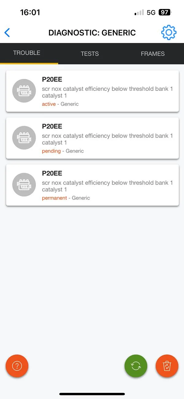

Almost immediately a CEL popped up. As soon as I was able I pull the codes:
Jeep Wrangler JL P20EE code at 62,000 miles IMG_3917

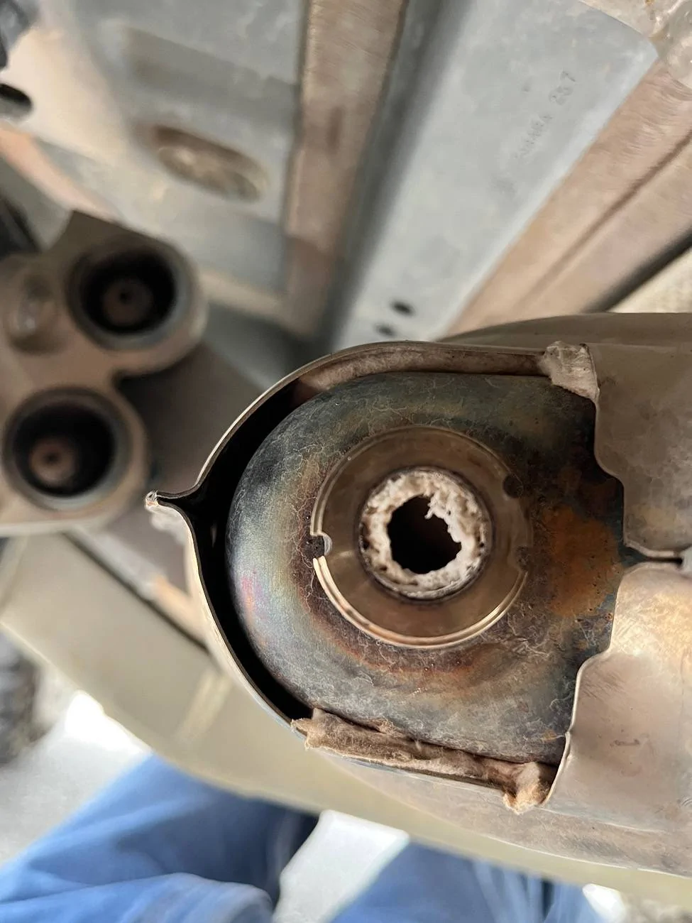

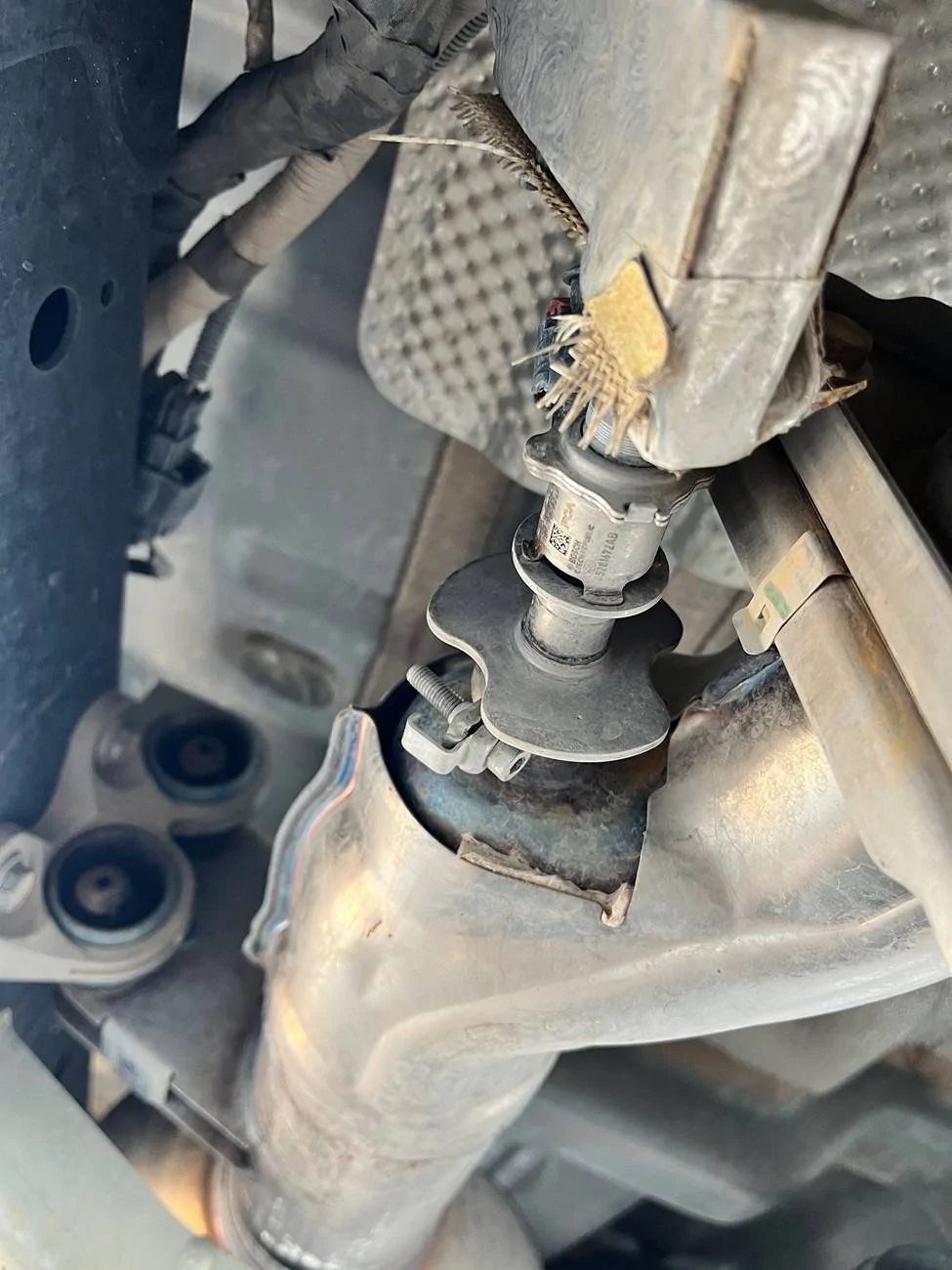

We put about 50 miles on it last night and this morning, then I pulled the DEF injector to clean it.
Jeep Wrangler JL P20EE code at 62,000 miles IMG_3928
The injector was actually very clean but the port on the exhaust itself was caked up pretty good.
Jeep Wrangler JL P20EE code at 62,000 miles IMG_3929
I cleaned that out and then realized all the previous times I had tried to clear the error code I was doing it wrong. I needed the engine to be off and in run position instead of actually running.
So I cleared the active and pending codes, only the permanent one is still there. The CEL is no longer showing and hopefully the permanent code will clear with a few drive cycles.

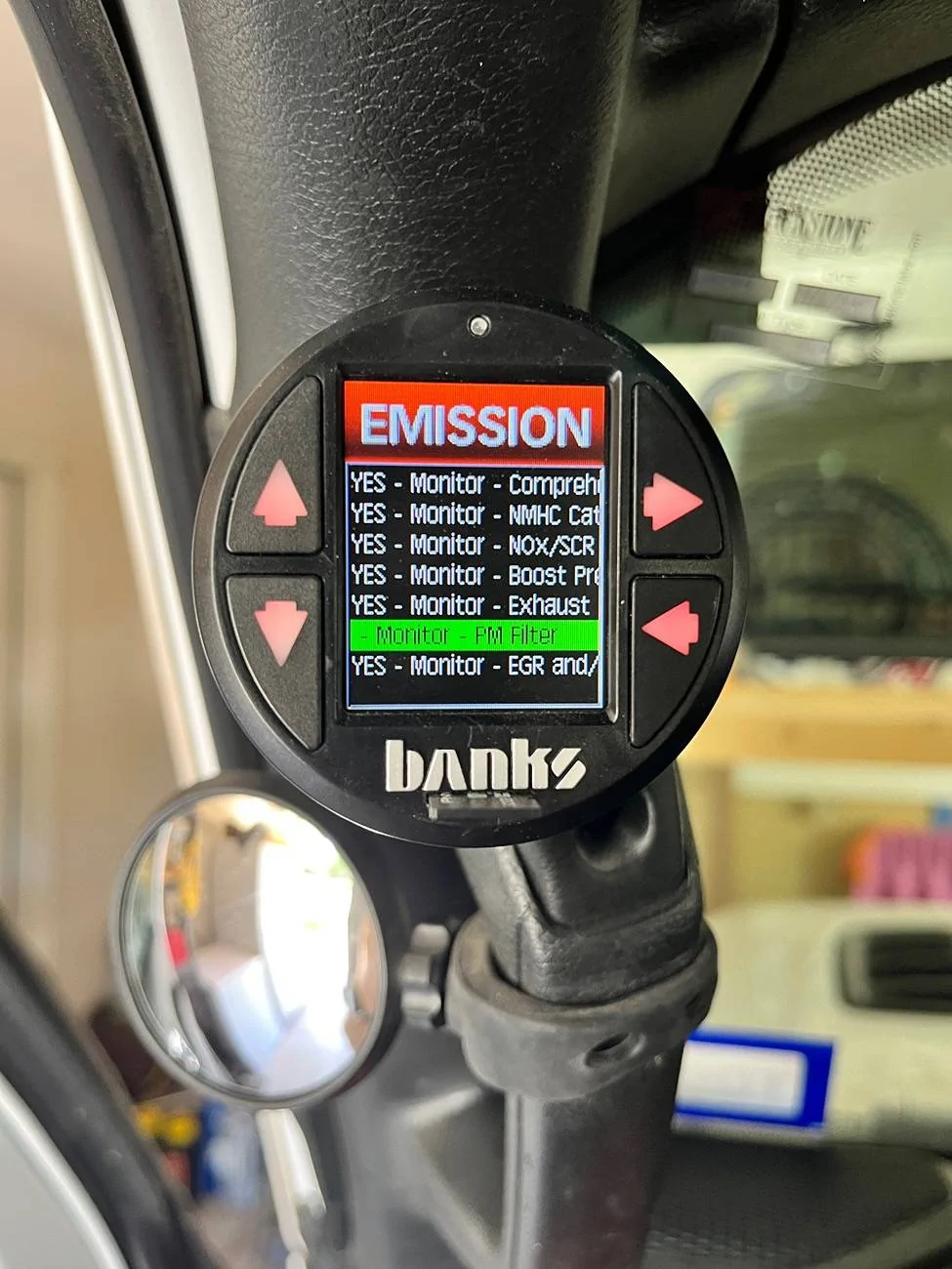

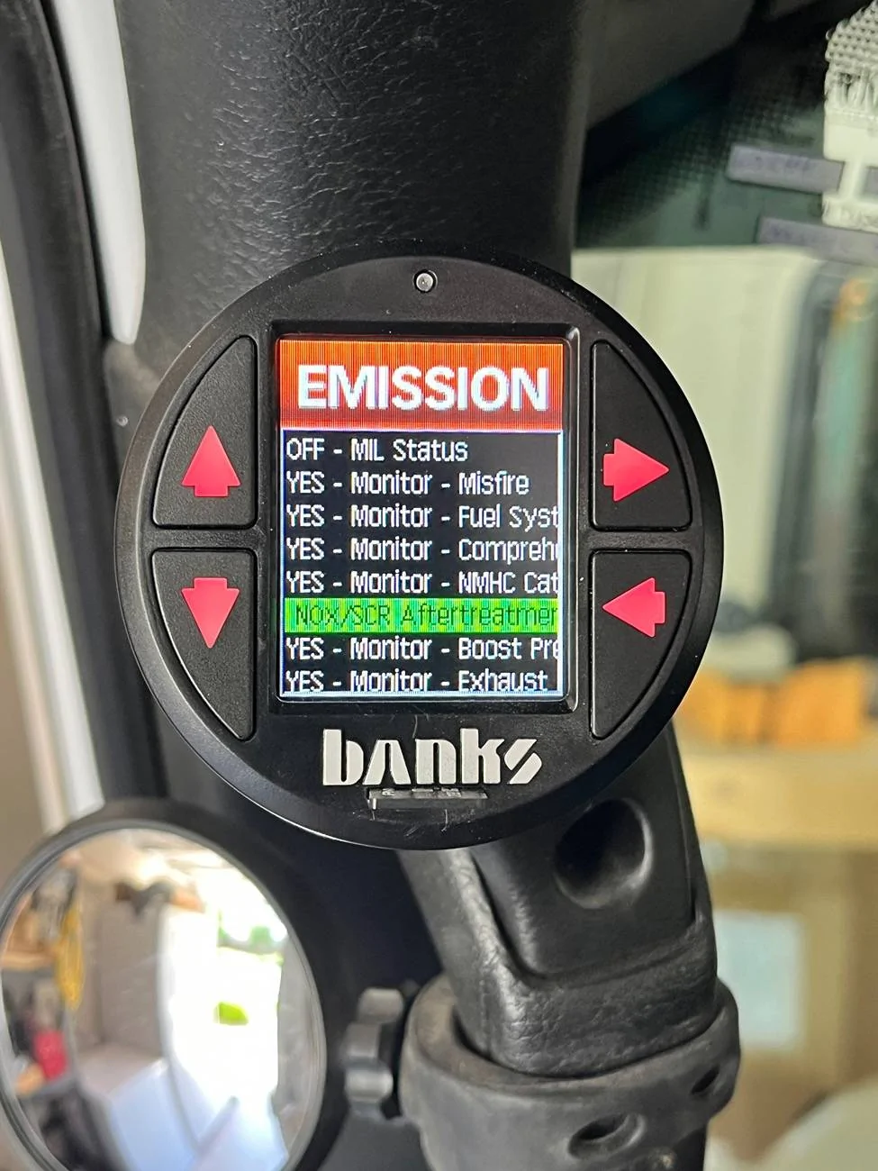

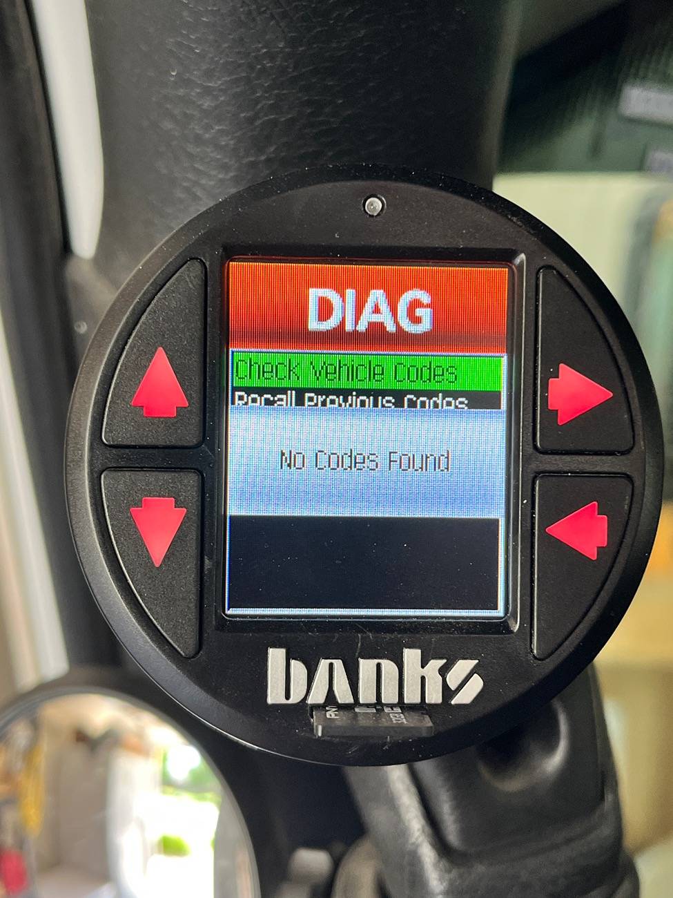

UPDATE:
We were in Indiana for another week after clearing the codes using JScan. The CEL light remained off but I was keeping an eye on the emissions readiness checks to see if they would reset. Three of them had not and I believe the three stragglers were:
  • NOX/SCR Aftertreatment
  • PM Filter
  • EGR and/(something)
Even going on intentionally long drives trying to meet the criteria of an emissions drive cycle which the internet defined as:
  1. Start with a cold engine, off at least 8 hours allowing it to cool completely.
  2. Warm up the engine, let it idle approximately 5 minutes, allowing it to reach operating temp.
  3. Moderate acceleration, drive at moderate speed, avoid sudden bursts of speed, maintain a steady speed for 10-15 minutes.
  4. Drive on the highway at least 55mph for at least 20 minutes. Vary speed slightly, accel/decel gradually.
  5. Park and idle for approximately 5 minutes, allowing it to cool down.

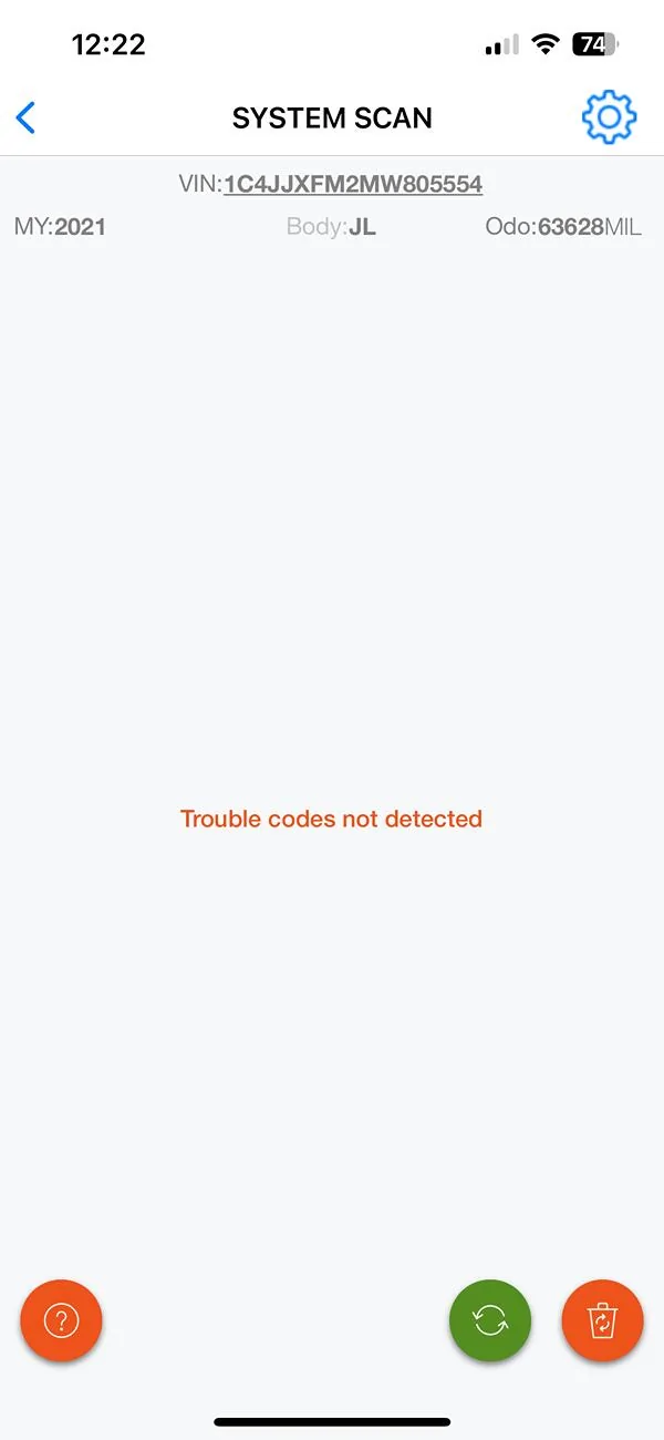

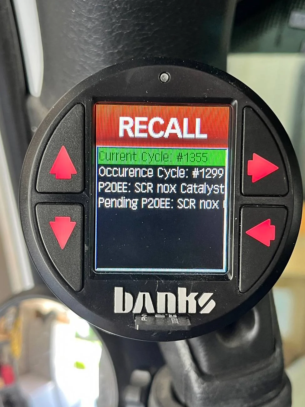

Things eventually cleared when we were halfway back to Texas (about 1000 miles after clearing codes). We drove for about 8 hours and ~500 miles into Missouri when I checked the next morning everything was good. I believe the iDash is able to show old codes because they are saved to the flash card. Jscan does not show anything at this time. Current theory is dunking the SCR into icy cold water reduced it's efficiency since they have to be hot to function.
Neither iDash or Jscan show current errors:
Jeep Wrangler JL P20EE code at 62,000 miles IMG_3992
Jeep Wrangler JL P20EE code at 62,000 miles IMG_3994
Notice on the recall display, the drive cycle for the error is 1299 vs the current cycle of 1355.
Jeep Wrangler JL P20EE code at 62,000 miles IMG_3991
The emissions readiness tests are all showing YES (they have completed).
Jeep Wrangler JL P20EE code at 62,000 miles IMG_3993
Jeep Wrangler JL P20EE code at 62,000 miles IMG_3996
