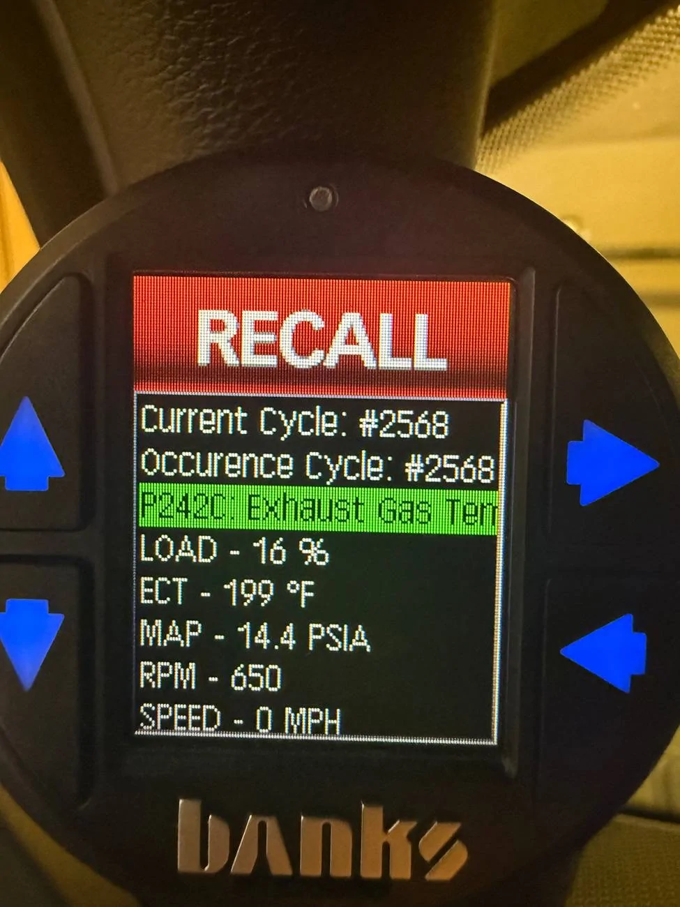

Have been been getting code P242C.
Replaced Bank 1 Sensor 3 w/ PN 68408957AB <-- this is sensor 4
Cleared the code and it has returned a day later.
Anyone else dealt with this?

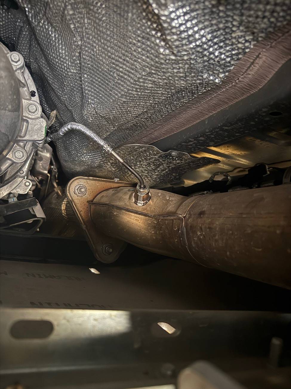

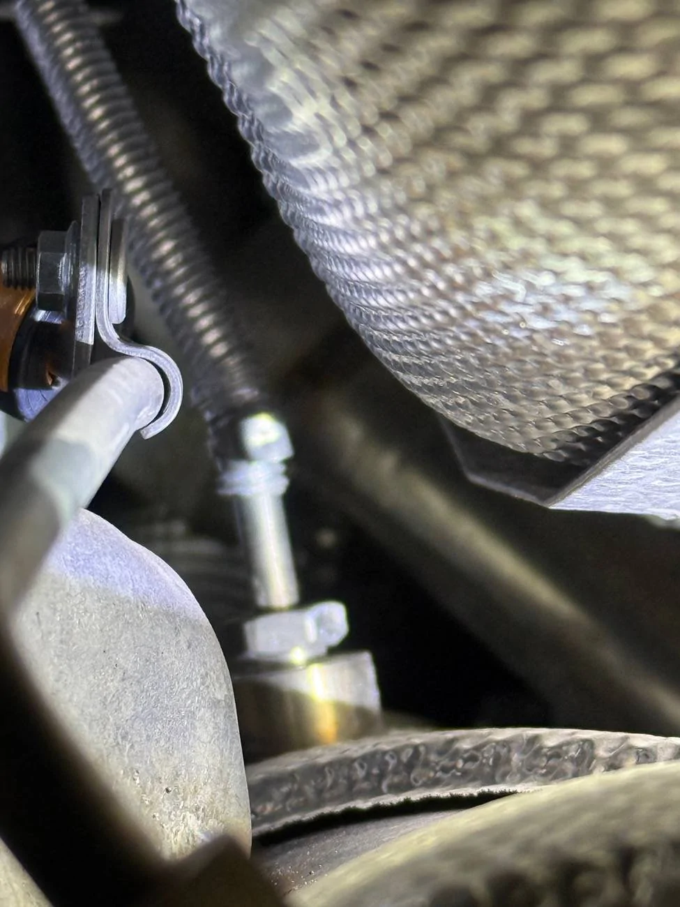

*update - pic below is egt sensor 4
Jeep Wrangler JL CEL code P242C IMG_0298
Jeep Wrangler JL CEL code P242C IMG_0296
sensor 3 sits on top of the dpf and is PN 68372817AB - this is what needs to be replaced
sensor 3 pic
Jeep Wrangler JL CEL code P242C IMG_0347

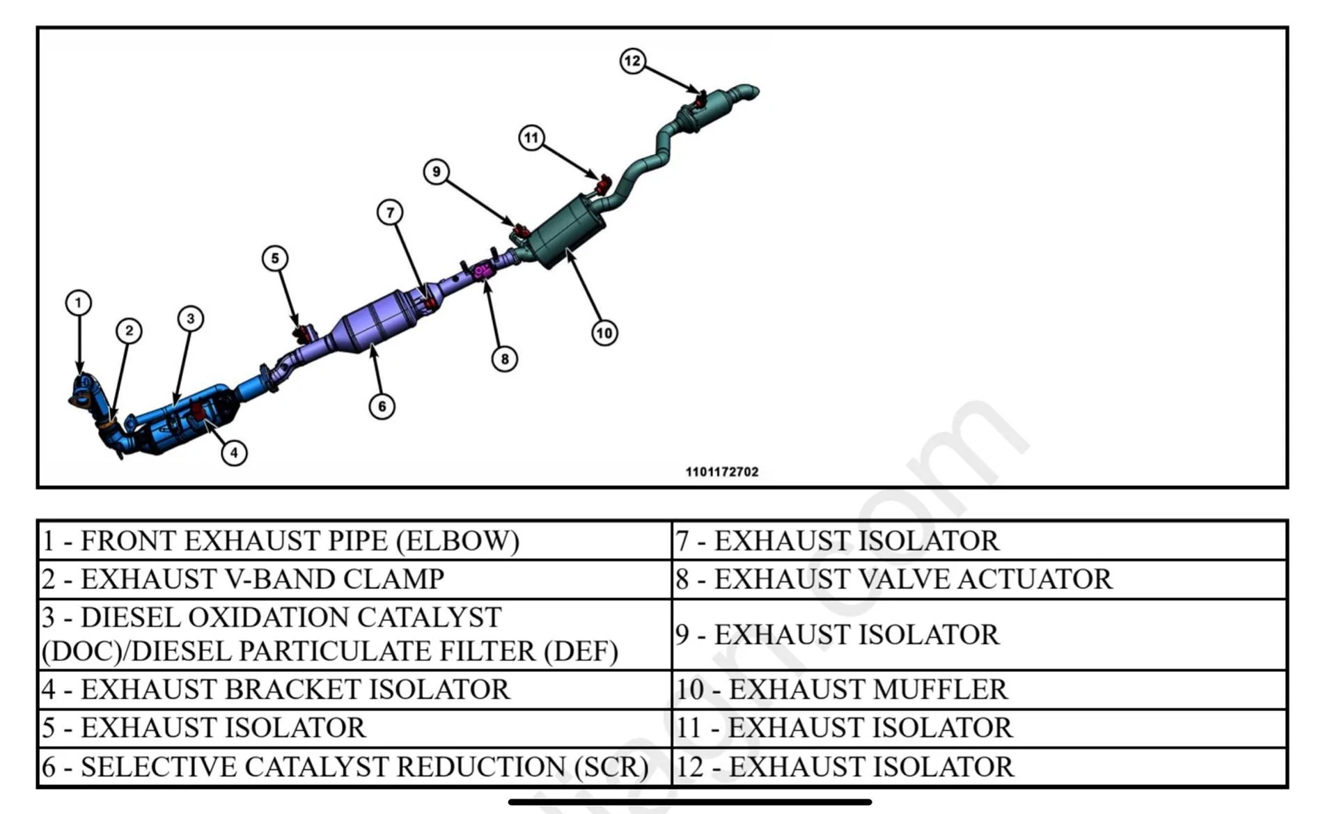

I have updated OP with correct info to save anyone else from replacing wrong sensor.
  • 1/1 is located on the outlet of the turbocharger — PN 68490115AA
  • 1/2 is located on the inlet of the Diesel Oxidation Catalyst (DOC)/Diesel Particulate Filter (DPF) — PN 68492934AA
  • 1/3 is located between the DOC and the DPF — PN 68372817AB
  • 1/4 is located on the inlet of Selective Catalytic Reduction (SCR). — PN 68408957AB

Thanks for this -- I have a Banks DataMonster (but no Derringer) and have been trying half-heartedly to nail down exactly where each of the EGT sensors actually is.
Which document is this from? -- the schematic doesn't exactly match the shape of the exhaust -- particularly the muffler. Perhaps a generic schematic?
And I don't suppose you have any insight into why there are separate turbo outlet and DPF inlet sensors since there don't appear to be any components between them? IIRC these temps do track very closely so not sure why there are two separate sensors here.

I can’t answer as to why sensors 1 and 2 are where they are.
The image came from this.
All 4 sensors are located before #5 on the image above.

Thanks. Says "Jeep Gladiator" on all the docs so that might account for it -- different muffler configuration but likely the same components in the same order.

Correct- they’ll be in the same location.

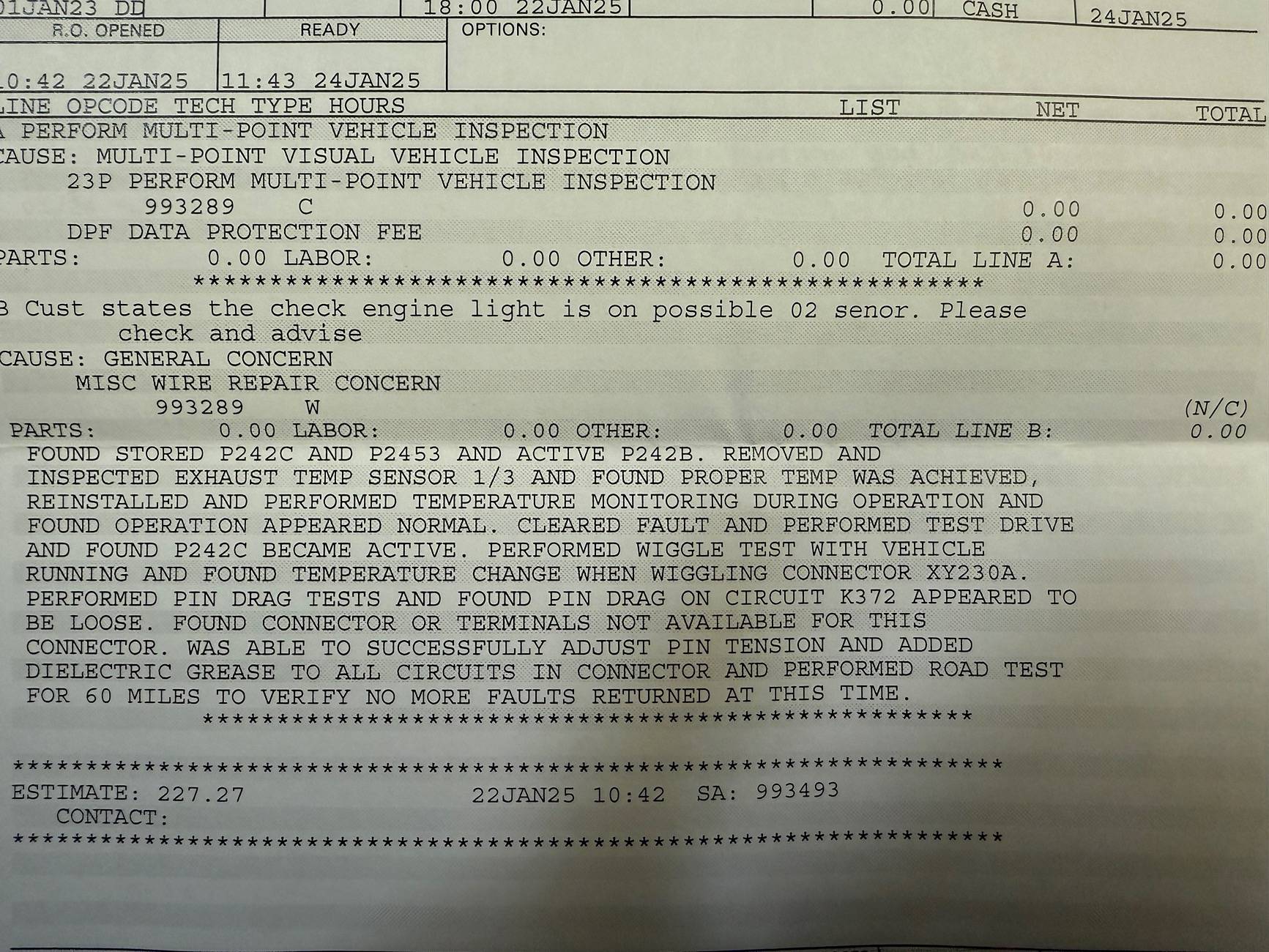

****Update 2****
Took the Jeep to a different dealership. Prior to them even looking at it, the service manager said it sounds like a pin tension issue in the connector. They were able to confirm & adjust the tension.
